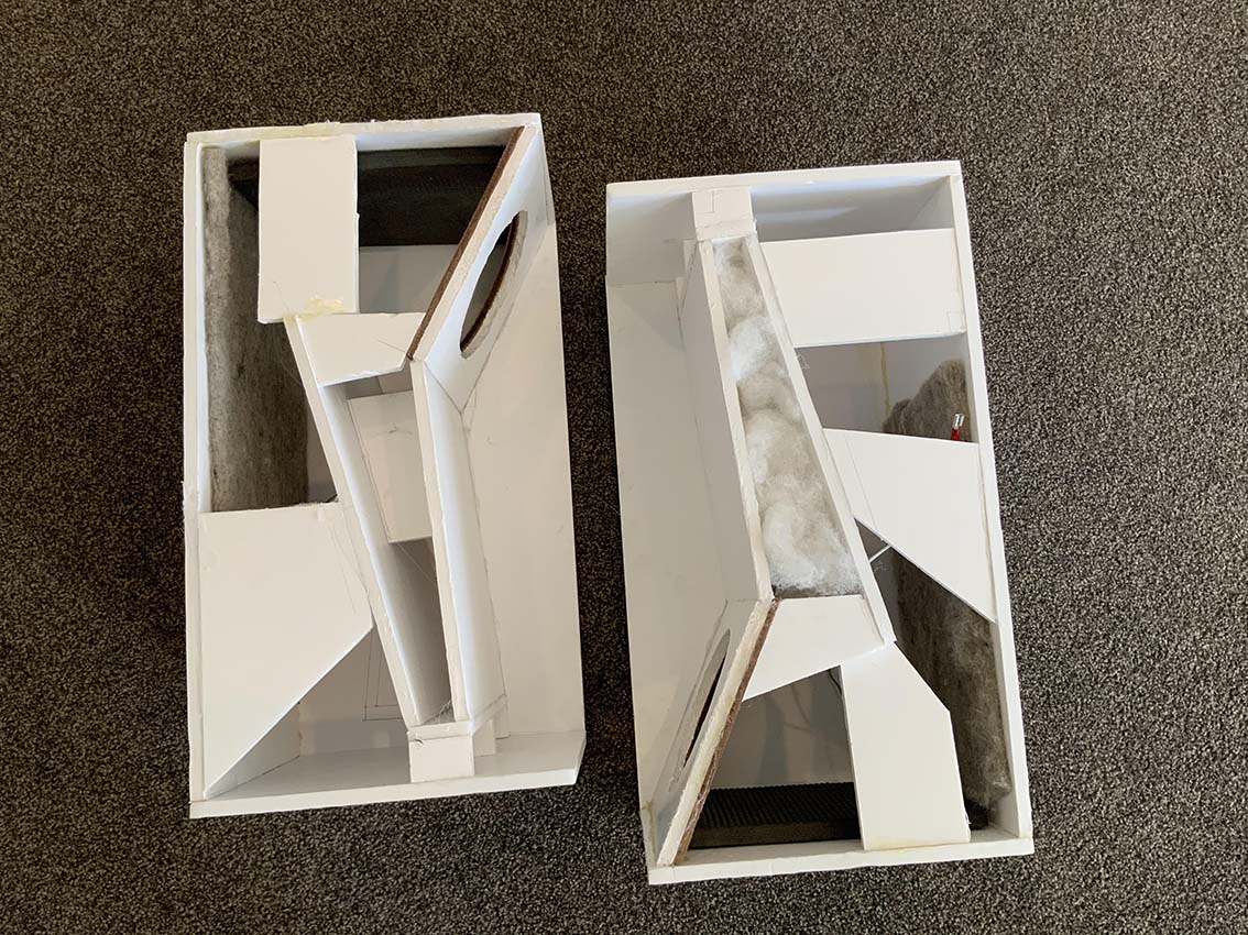

Spent today trying to put together the foamcore 0.53x Karlsonator for W5-2143.
Think I may have bitten off a bit more than I can chew.
Didnt help running out of hot melt at a critical time.
Yes, I had a heap more sticks, no they did not fit the gun they sold me.
And with NZ in lockdown again, getting more glue might be a bit harder.
Anyhow, I should have read XRK's build instructions a bit more carefully because I hadn't offset the hardboard backing where I intend to attach the driver; thought wood would be better as this driver is quite weighty.
And using 1cm foamcore may not have been a great idea either; Im guessing that most of you use 0.5cm foamcore?
Because of the panic moment when I ran out of glue I had to use gorilla expanding foam which looks pretty rubbish on white foamcore.
But it is all a learning curve.
For a while there I was getting quicker!
I dont think I need 13 pieces of foamcore fillets for reinforcing really as this thing feels pretty robust as is. But once I get more hot melt glue sticks that fit my gun, I will be sure to add reinforcement where it seems necessary.
Im wondering how people even up edges that might not be entirely true? Do you use a sander or a gentle plane? I seem to be fixing edges to make them either fit better or eliminate obvious places where there will be air gaps. Or is it easier just to add a bit of hot melt glue?

Nice work Luigi. Running out of hot melt. We have all been there! But to have the wrong size refills is a bummer. Maybe get the different hot melt gun that fits the incorrect glue?
Cutting the raw stock to precise width strips using a metal straight edge and utility knife if a learned skill and guy get better at it with practice. That makes the joints tight and relatively gap free. Hot melt or caulking can fix big gaps. Structurally though it is better that you have solid contact with no gaps.

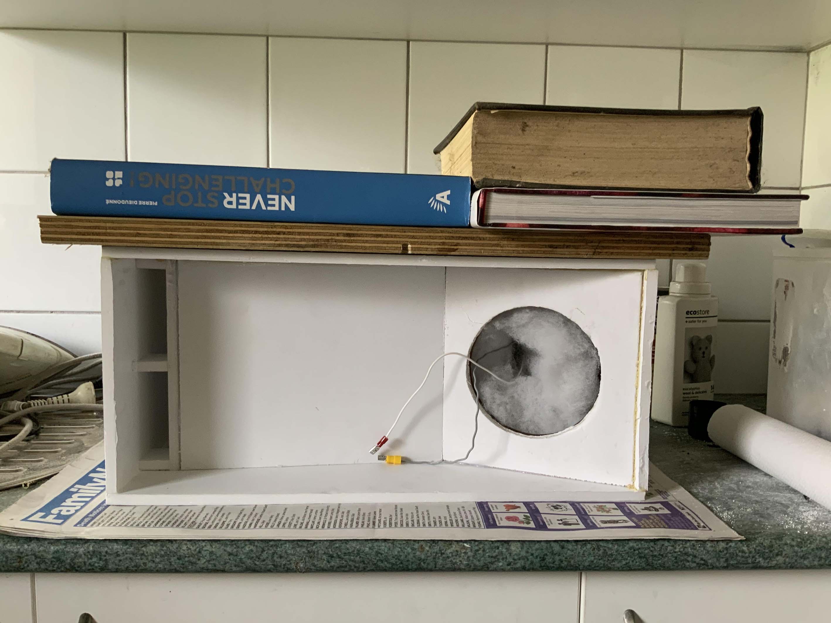

Just a random question here X.
With the slightly bigger 0.53x build, and using the 1cm foamboard, do I need to place/stick anything like felt (or perhaps a piece of EVA foam) on rear surface of the enclosure (with the terminal cup) that the back of the driver faces?
I have a whole lot of dacron that I will fill the first part of the line with.
Perhaps this is sufficient??

Yes, it never hurts to line any surface in direct line of sight of the rear cone membrane. Or surfaces that are parallel to prevent standing waves which can become resonance peaks/dips.

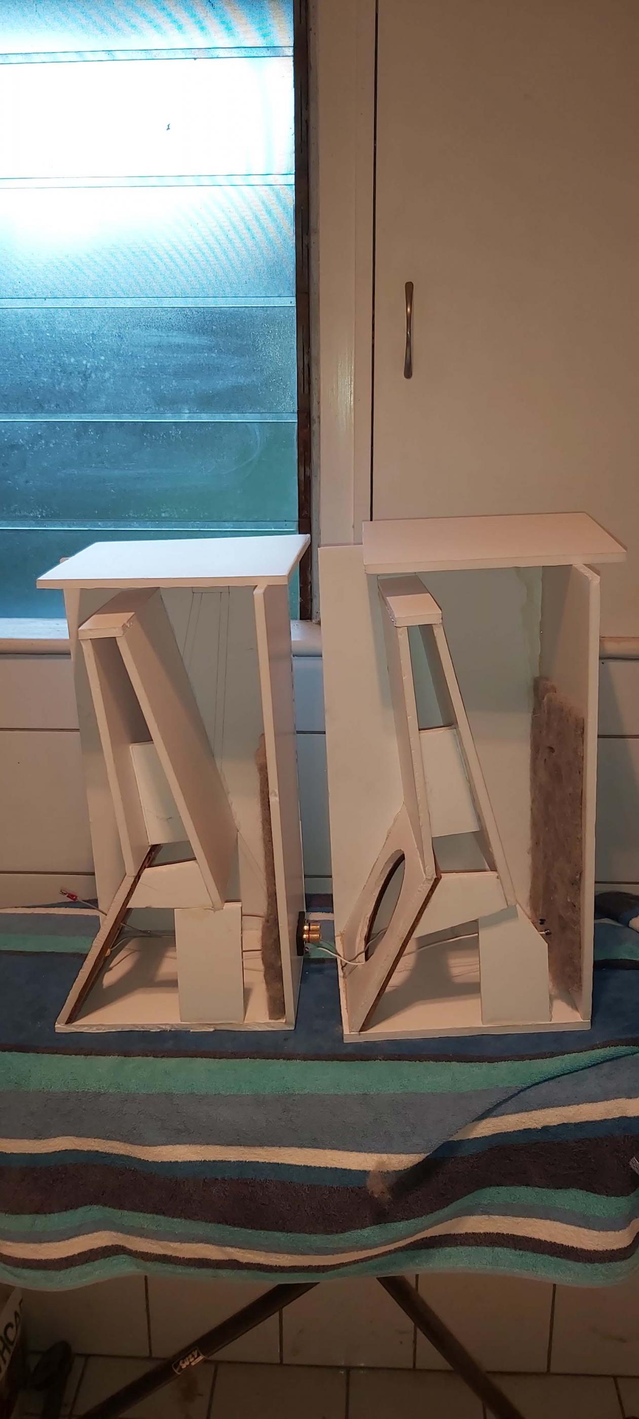

Because of the lockdown here, which seems to be working, thankfully, have not been able to get more gluesticks so using Ados and Gorilla glue instead.
the terminals are now installed, that worked just gluing them on.
And am nearing the end; has taken forever, seemingly. Might stick to 5mm stock next time, if there is a next time!

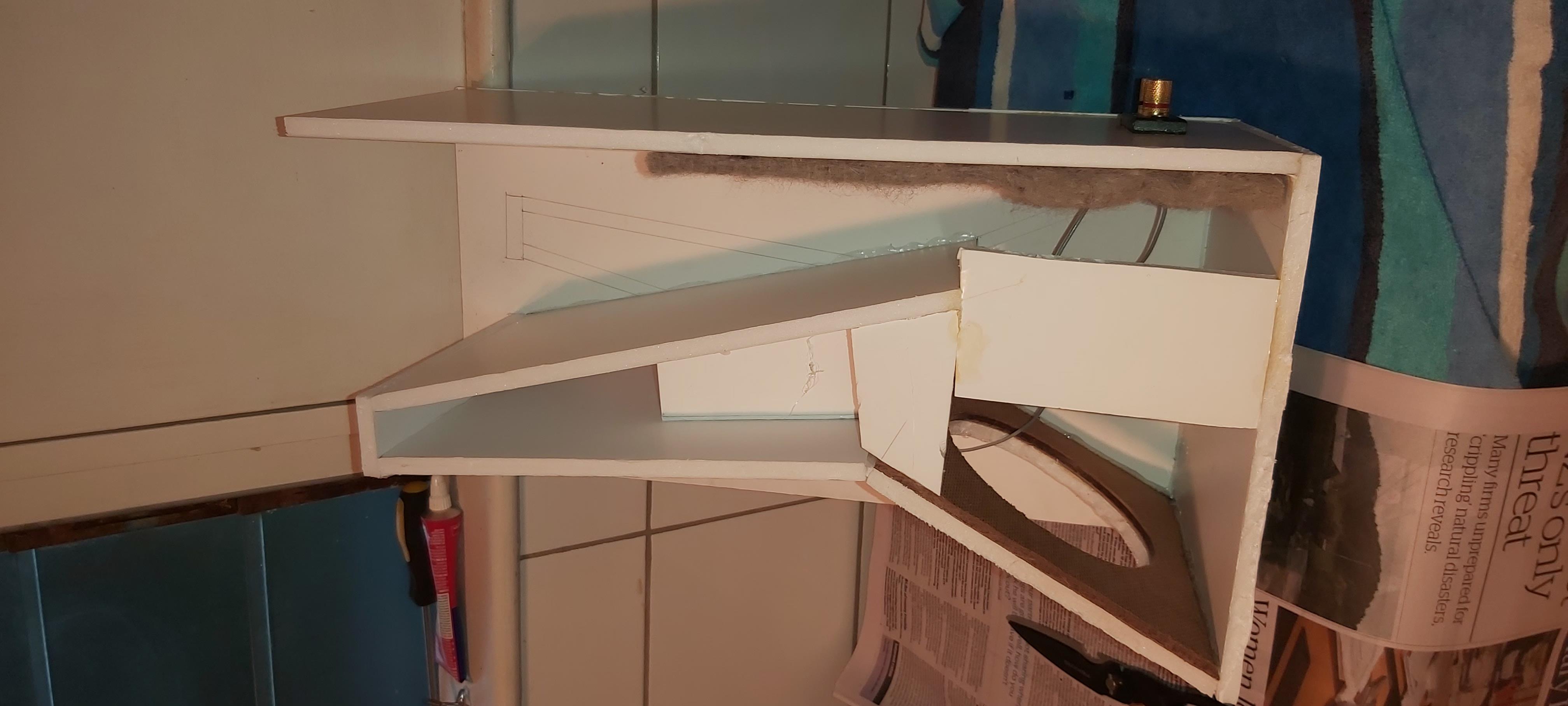

I will be perfectly honest with you and state that I have made some fairly basic errors that are quite hard to undo after applying hot melt glue. That's why there are no close-ups!
That said, building foamcore speakers seems to involve a bit of a learning curve. And things that might at first seem insurmountable you can seemingly cut around and get back on track again. At least, that's my initial experience.
I haven't the foggiest how I'm going to lay out the Karlson slot though; might be a bit a by-guess-and-by-golly job that one. Unless you have a few hints and tips as to how to go about it.....

On a piece of paper with the outline of the baffle, draw the correct position for the vertex of the Karlson. Take a pencil and move your forearm about your elbow as the pivot, and quickly and smoothly on one stroke, draw an arc tangent to the vertical slot and intersecting the bottom corner. Now fold the paper at the centerline. Use scissors to cut the outline of the aperture and you have a perfect mirror image copy. The scissors smooth out any rough errors your hand made drawing the arc. You now have a template to cut the K aperture.

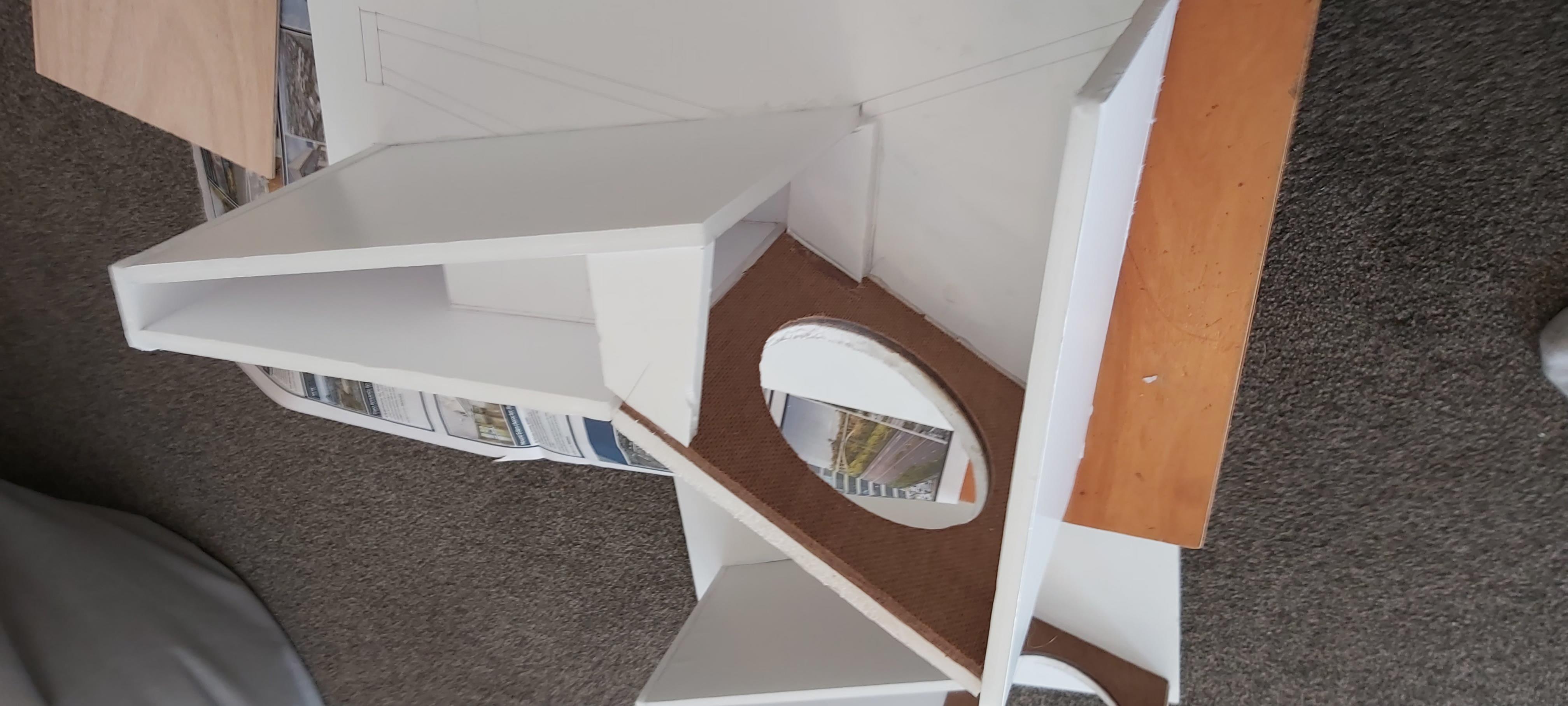

We had another idea. From those plans of the 0.53x Karlsonator that someone posted, and I have based my speaker on, we can just print the page with the Karlson slot at full size, and then trace the lines onto the foamboard. Probably a bit more accurate as my shoulder is a bit dickey!
So today we decided to try to finish these 0.53x Karlsonators.
The final panel didn't really fit all that well on either so I had to do a bit of fudging with sandpaper and hot melt.
And decided to use expanding foam glue because hot melt would have bonded by the time I tried to fit the panel. My glue gun is rubbish.
I know that gorilla glue eats away at the foam but it does seem to fill in the gaps nicely and the glue adheres okay to the paper bits of foamboard.
So now we just wait and see how many air gaps there are.
Using lots of weight to pin the side panel in place. Hope they don't collapse!
