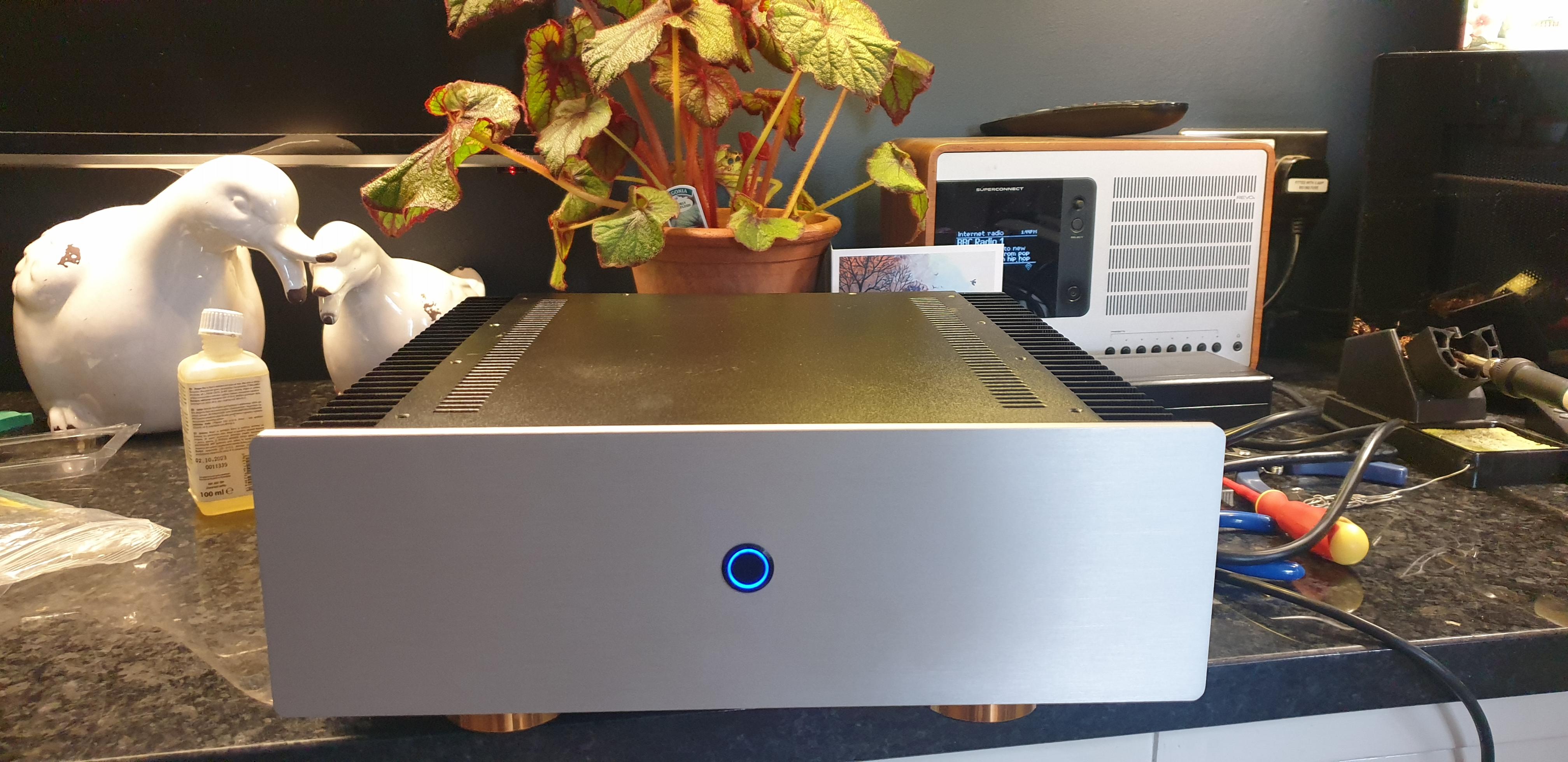

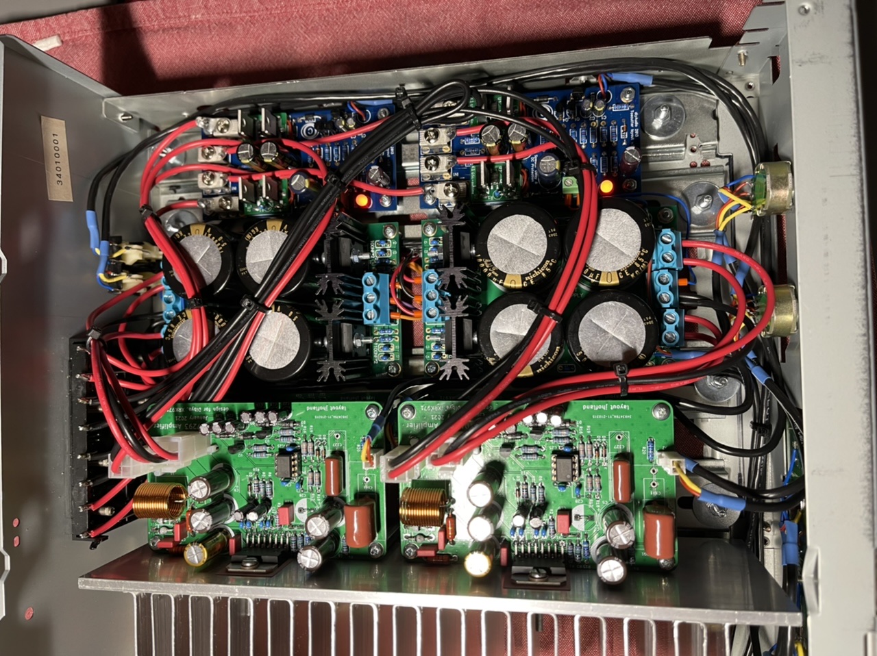

Buttoned up and was playing last night...so it works! No real critical listening yet and we have no curtains at the moment as the window is being rebuilt so the room is a little lively right now.
Also a video I made of the Mark Johnson H9KPXG soft start
Mark Johnson H9KPXG soft start - YouTube

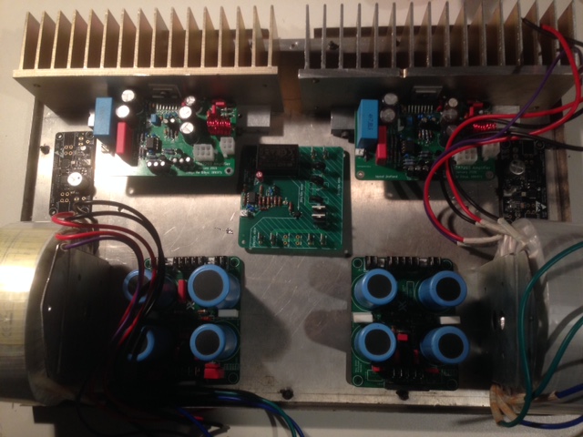

Hello Builders,
I had some time to work on the Xmas amp and some other components. I have attached a pic of the layout I would like for the construction. I am asking if anyone can see anything that looks out of place.
Thanks,
MM

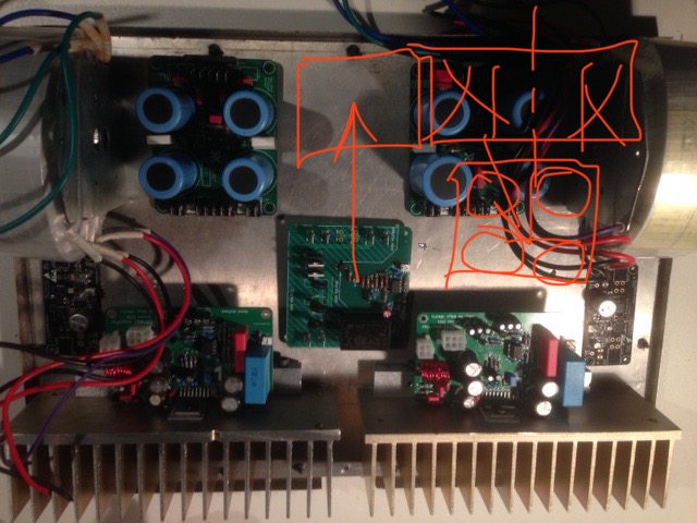

Hi Myles,
You pretty much are using all existing space. The only thing I would try to do differently is to move the toroidal donut as far from amp module as possible. So against the front panel like how I have in sketch. Move the SFP farther away as well. The idea is keep 120vac mains as far from the low level input signal as possible. This will reduce noise pickup.

Thanks X,
At one point, I had the X's parallel to the front panel, one in each corner of enclosure. I will put it back that way, and see if I can free up some space between them and the amp board.
I can also move the SFP to mount on the front panel.
Is your pic showing both transformers in one corner?. I think my enclosure would tip due to the weight of both X's.
MM

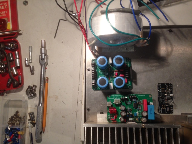

Hi X and other builders,
Please see pic below for updated layout for one channel. The other channel will mirror this layout. I think this is better than the one in post #784. I only have 12" of depth to play with.
The SFP will be mounted on the front panel between the transformer's.
One other question, I have applied thermal paste between the back of pad and heatsink. Was I supposed to apply paste to the back of the chip and the front of the insulator pad also?.
Thanks,
MM

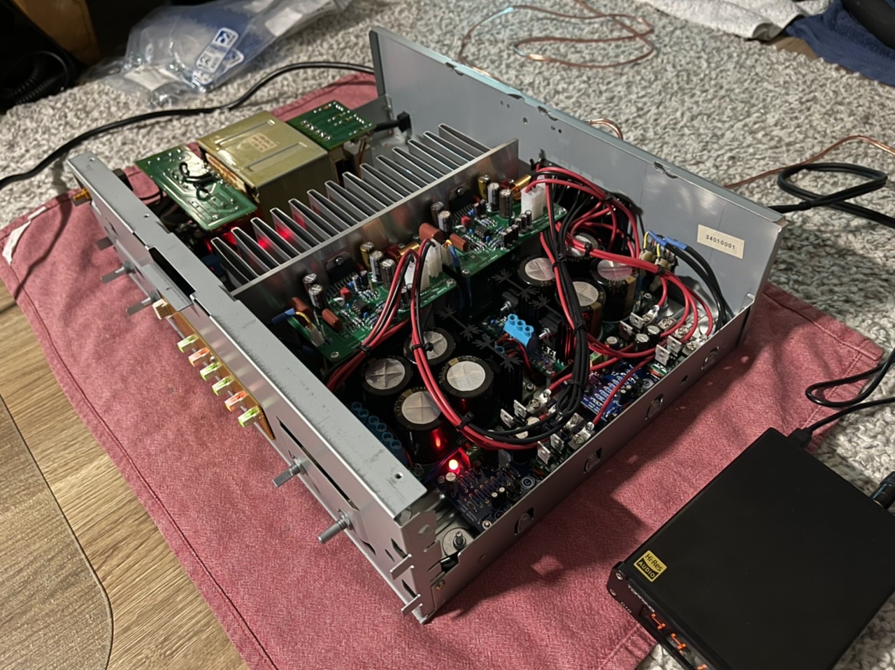

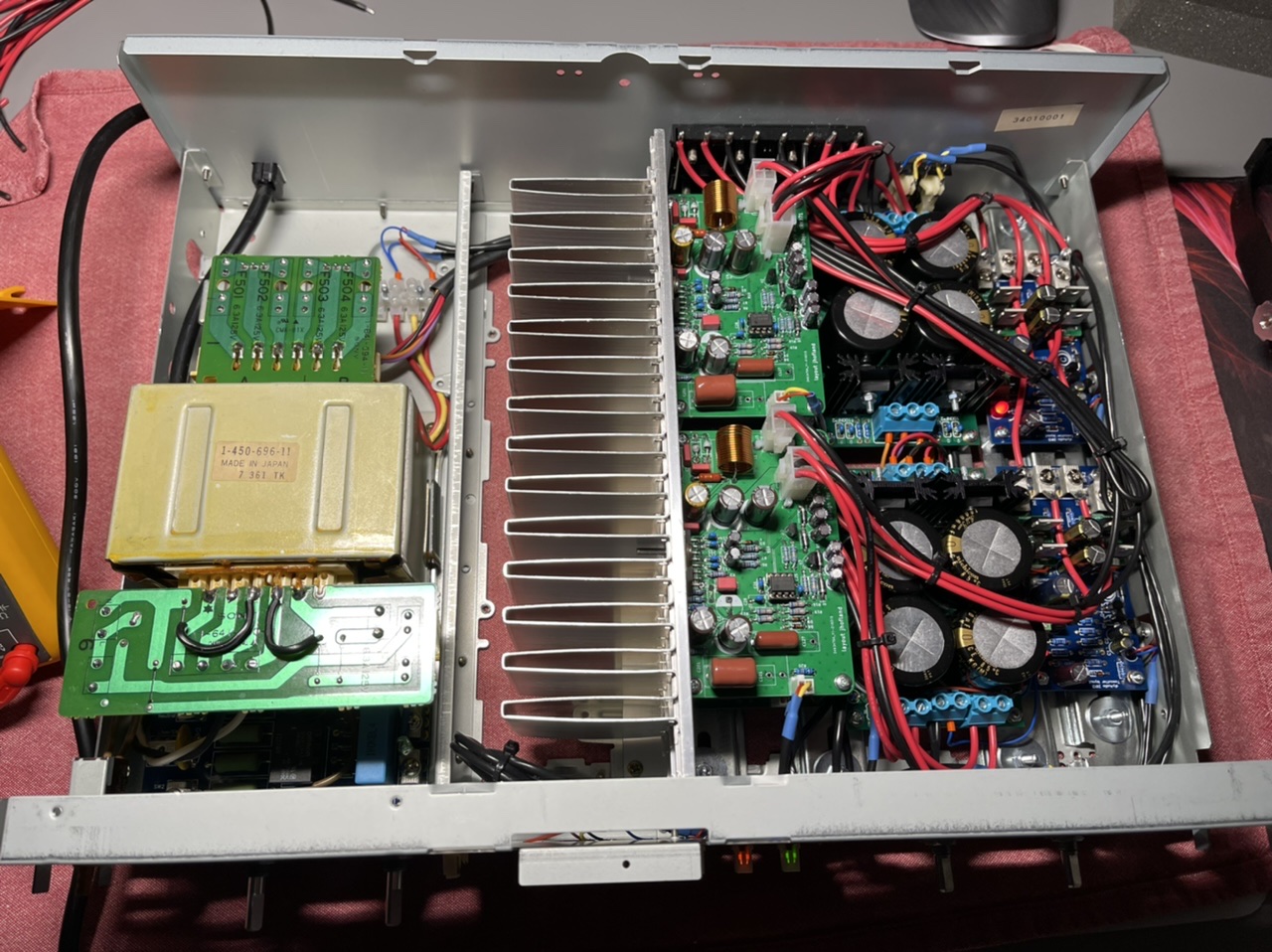

Finally got there for this Xmas😎
Just wanted to say thank you for the amp design and pcb's. Took almost a year to squeeze 'em in a Sony TA-N220 chassis, but all four channels sound great. Merry Christmas everyone ☃️
