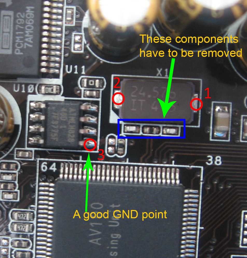

my essence stx has channel imbalance between left and right, I just discovered today, I was blaming my dsp but I realized the issue is causing from STX.
The only mod on this card I did is upgrading to Audio-gd JZ-1 TCXO clock.
The right channel have slightly more treble than left, but left channel has bold and flatter and louder sound than right. Stereo imaging is left focused. I can hardly handle the issue with balance adjustment of the STX driver.
Can anybody have an idea to fix this weird issue ? 🙁

Your board it may be defective when about the post processing DAC circuits... You should take a look at the opamp stage, its output, verify the +/-12v rails.
It should be interesting to know if this issue was present before replacing the clock oscillator. .. Harmonics in oscillator frequency it may produce such disturbance.

No this issue did not present before clock upgrade 🙁, may I be damaged the caps around the resonator chip while removing it?
OK, that is the problem... You should remove all the components around the old resonator chip. There are two resistors and two small ceramic caps. Just clean the place there where the resonator it was. Make sure you inject your clock signal into the pin nr 46 of the processor. The processor accept clock signal from both 5v or 3,3v oscillators.
The clock signal path it have to be as short as possible. No more than 10mm. In your case, as the clock generator is quite big, you should use a thin coax cable to transport the clock signal. GND point of the clock signal (coax shield) it have to be very close to the processor GND pin/chip.

hi chris I thank you so much for helping me.
I actually not know so much about electronics, when I look at the board, I see there small things just below the resonator. so should I remove all of them?
And the other thing I want to tell you that there are big nichicon caps above the resonator, I touched them a few times accidentally with solder iron. should I replace them?
I may say that proceeding to such clock mod on this board, one need some basic knowledge and informations about how to be done it...
You should remove the old resonator, and the components around it (previous post). There are informations in this thread, and by googling.
You do not need to replace the Nichicon caps if they are not destroyed. But I can not know their status, and how much heat they had to endure...

Hi again coris
I think you misunderstood me, I alrady removed old resonator but the resistors and caps still there, and I am not using the pin nr 46 on the processor, I just injected the clock to the old resonator's pin.
Here is the picture what I did.
so should I remove components you mentioned, and inject the oscillotar freq directly to the pin nr46 of the proc. ?

Hi recepky
There is a nice installation of your clock. Else is a little bit difficult to be seen what is on the board, because of the light reflections.
Yes, you should remove the old components around the former resonator (resistors and caps). These components do not have any function as far as the resonator is gone. It only disturb the clock signal from the new oscillator...
You can use the corresponding resonator pad (if it still be there) to inject/connect your new clock output. You may follow the trace which goes from pin 46 to the resonator pad, and use that pad to connect your clock. There is more convenient to use that pad instead the pin of the processor. Extremely care may be taken if you are force to use the processor pin... I do hope is not the case.
Here is the picture about the components to be removed before connecting the new oscillator. There are actually two resistors and a ceramic cap in the middle.
hi coris
I removed those two resistors and ceramic cap, they are very very small, it was a hard operation 🙂
result is interesting again, stereo image now focused on the center but, I feel like right channel has a little little bit more treble than left 😀
but I must say that the stereo image is clearer than before.

Hi recepky
I see in your last pictures that you use a coax, but to be honest I think is a little bit wrong way to use this cable...
As you can see, this coax cable it have a central wire, and a shield over on it. This shield is meant to be used too, and is to be always connected to a GND point. I can not see that you did so, out of your pictures...
This is quite important to not alternate the clock signal. This coax is not to be used for power connections.
So, please locate the output of your oscillator device. Near to that output pin/point it should be a GND point too on your oscillator. Use these pins and connect the signal from the oscillator output to the centre of the coax cable, and the GND point (on your oscillator) to the shield of the same coax. On the other end of the same cable (to the sound card), connect accordingly the clock to the old resonator tab, and the shield of the coax to the GND point (pointed in my last picture). Then find another wire to connect the power of your oscillator to the output pin of the 5v 7805 regulator.
This way it should be right to make connections in this case. Then you can give it a try to the music...
