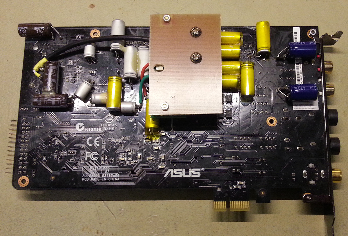

Oh boy. Ginormous 100n/1000V Mundorf speaker crossover caps on a soundcard? Like, seriously? The bloody things are bigger than the electrolytics they're in parallel to, and I can't imagine the lead lengths are going to benefit parasitic inductance much... or that the whole shebang is likely to benefit channel separation. It looks absolutely ridiculous in any case. Whatever happened to using ordinary Panasonic or WIMA caps?
Downsizing this mess would have one clear advantage: you could put the shield back on - it gave me maybe 1-2 dB more measured dynamic range on the D2.

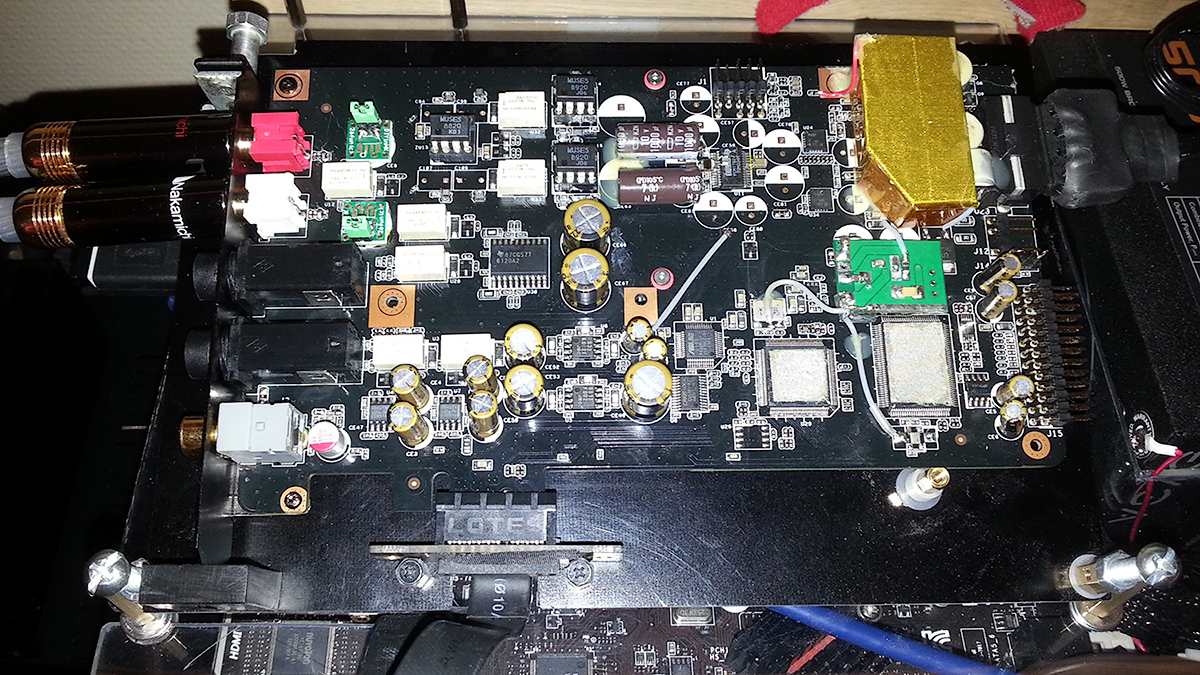

1. I would like to ad external power to the +12 and -12 connectors of the pcb. Now there are two voltage regulators on board.
Plan: Remove the output pins of the voltage regulators and connect external +/-12v.
Voltage regulators:
Bild: 20181105_105940ofe5u.jpg - abload.de
Careful, the one on the left is a 7805, that's a 5 V reg. If there is a -8V supply at all, I'd expect that to be coming out of the switching regulator including L20 below (verify with multimeter). The 1117 is for one of the sub-5 V digital supplies, 3.3 I guess but the markings should say what it is.
This setup seems quite similar to what a Xonar D1/DX has, actually.
2. The clock with external power. Plan: desolder the old one and connect the masterclock output where the old clock was.
Questions: Which is the masterclock input?
Have you checked with the CMI8788 pinout?
3. Replace the 22n and 8n foil caps with Wima caps around the Opamps. I read that the cap-values are not ideal. Which ones are ideal?
In a lowish-impedance circuit, 22n seems like a rather low value for rail decoupling caps indeed. Not sure what the 8n2 are even doing, are they in parallel?
Honestly, these Xonar cards tend to perform very well out of the box. I don't see much of a point in botching the poor thing any more than it already is. If there are any issues, they are likely to be things like ground loop problems when using the extra RCA output board (as noted when combined with the ST/X), and you're never going to tackle those like that. In fact, you may be generally unable to escape ground loop issues no matter what soundcard you use, depending on what you are connecting it to - any other mains earthed device in there, you lose; any device that is dumping a fair bit of mains filter leakage current into its ground (typical TVs), ditto. Getting the performance of a high-strung consumer soundcard "onto the road" can be quite hard. Unbalanced connections just aren't what you would call particularly robust. They can be made to work, but you will be limited in what you can connect and have to know what you're doing.

Well, all the informations are already in the pictures I published in my previous post. However, without knowing some basics in this field, may be quite difficult to fulfil the task...
The eventual 3,3v regulator it should be placed so to input its power in the point marked on the picture (vias), and the ground connection could be right beside (creating a GND point by scratching the ground plane of the board in that area).
An external power supply for this board, should be ON/OFF synchronized with the main power system of the host computer.

Long time ago since my last work on Xonar boards. Coming back now with some recent STX2 improvements (very good results also).
I have to say that STX2 it is already an improved version by Asus itself, comparing with the first STX. However it still sounding moufed, even thought the good marketing/advertising...
This sound card it is also capable for high audio quality(after properly upgrading of the power system, clock system, as some other circuits).
My previous upgrade concept was based on adding of a full DAC system, with its own power system completely separated from the computer one, using only the digital interface tapped from the DAC digital inputs (also galvanically isolated). The result and the quality of the sound is indeed impressive. My last upgrade was realised on board, modifying the Assus design, and using the computer power system. Surprisingly, the audio quality level is similar for both these two upgrade approaches.
