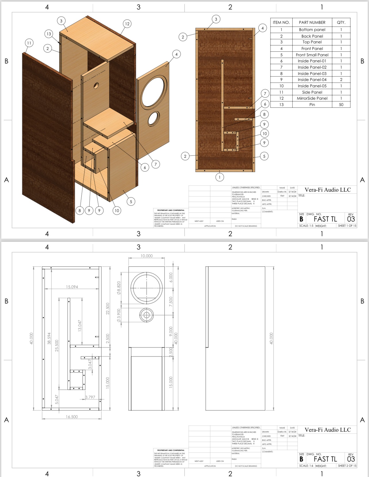

I have been getting a lot of inquiries about a possible Flatpack for the popular 10F/RS225 FAST TL speaker. There have been probably 50+ successful DIY builds of this speaker. Everyone is a very happy with how they sound. I have developed plans for a CNC cut flatpack of this speaker in 18mm birch faced poplar plywood (Trueply brand). The design will include a lot of 6mm alignment dowels for easy assembly with glue and clamps. The dowels prevent the boards from squirming under pressure and ensure a straight and well aligned speaker box with true 90deg corners. More info on this speaker can be found in this thread. The crossover PCB can be purchased here if you don’t want to build your own P2P XO.
Here is what the plans look like:
Very similar to the released plans that folks have been building to and uses a trick first seen on member @Plott ’s build for the baffle (stepped edge).

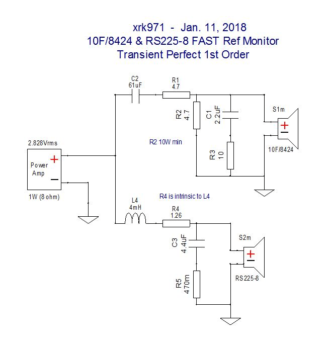

Schematic of XO:

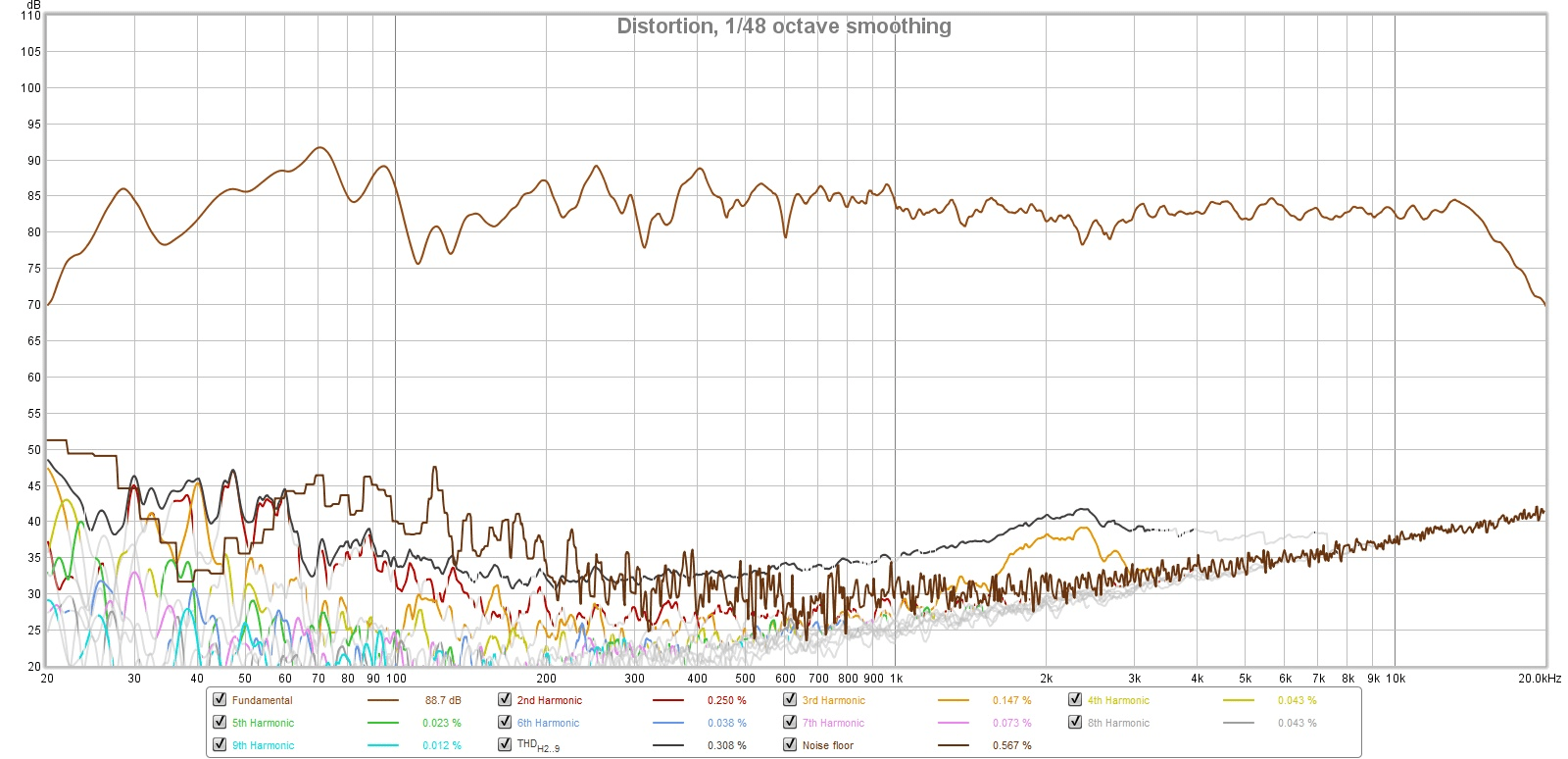

Here are some in room measurements (2vrms at 0.5m) there are some room modes that cause a dip near 120Hz but that’s not intrinsic to the speaker. You can see the reach of the TL bass and the smoothness of the reponse and the overall low distortion.

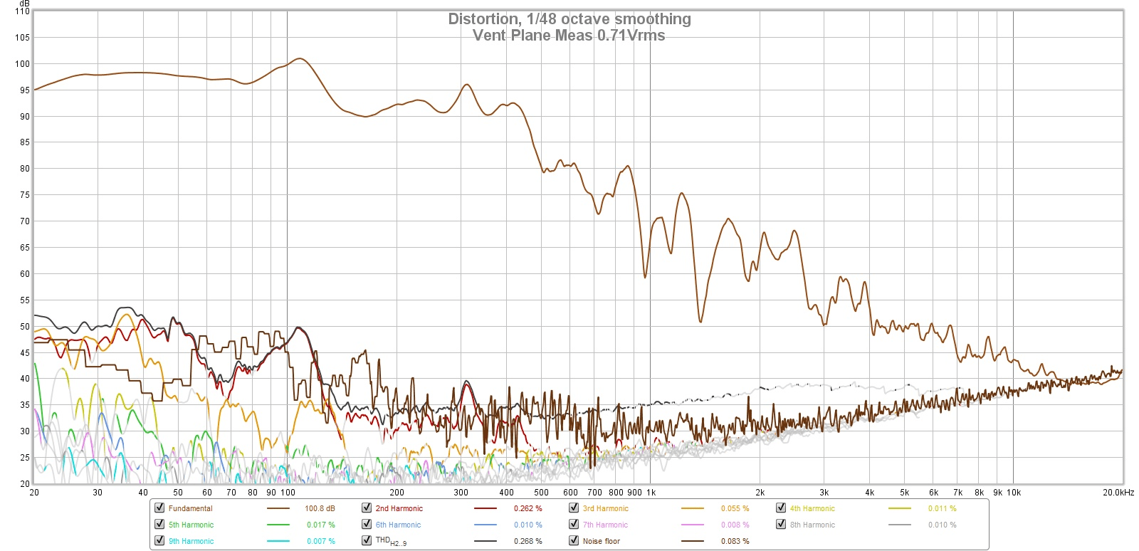

Here is response of the woofer TL output at exit plane of the vent to eliminate room modes. You can see the output is smooth and flat and reaches down to 30Hz easily.

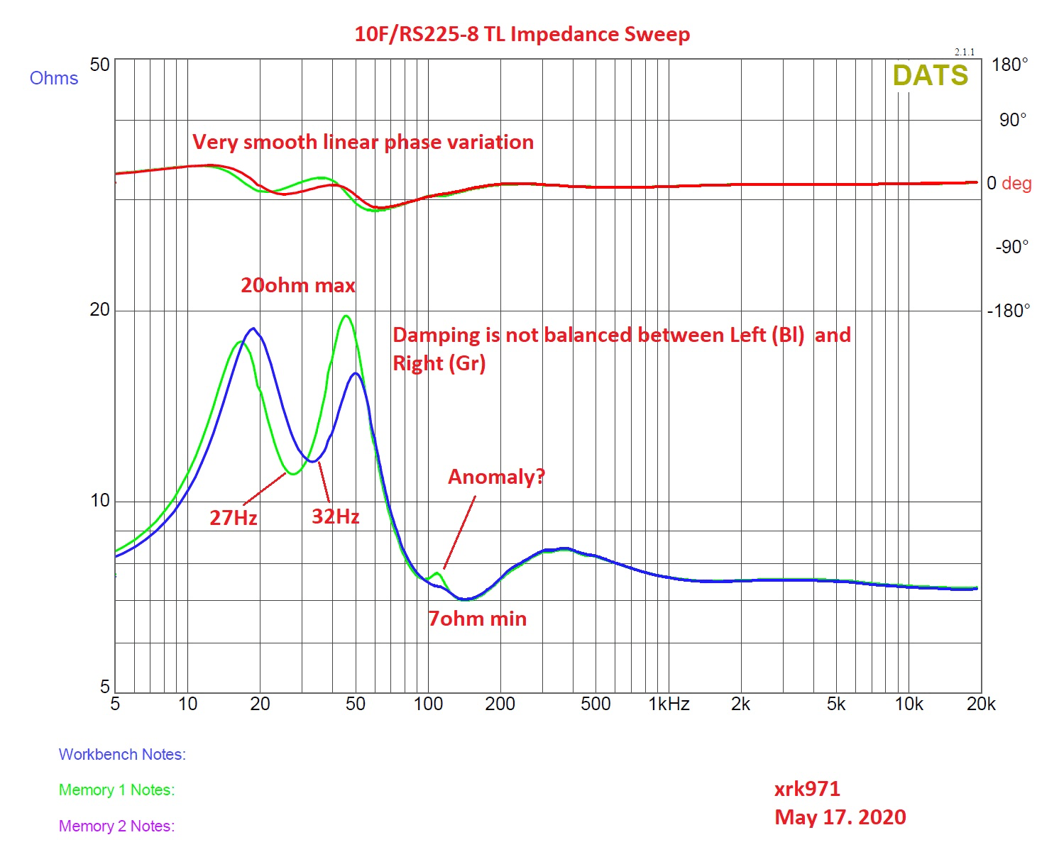

Here are some measured impedance sweeps showing it is an easy 8ohm load and that the TL is tuned to circa 28Hz to 32 Hz depending on your driver TS parameters and stuffing placement etc.
