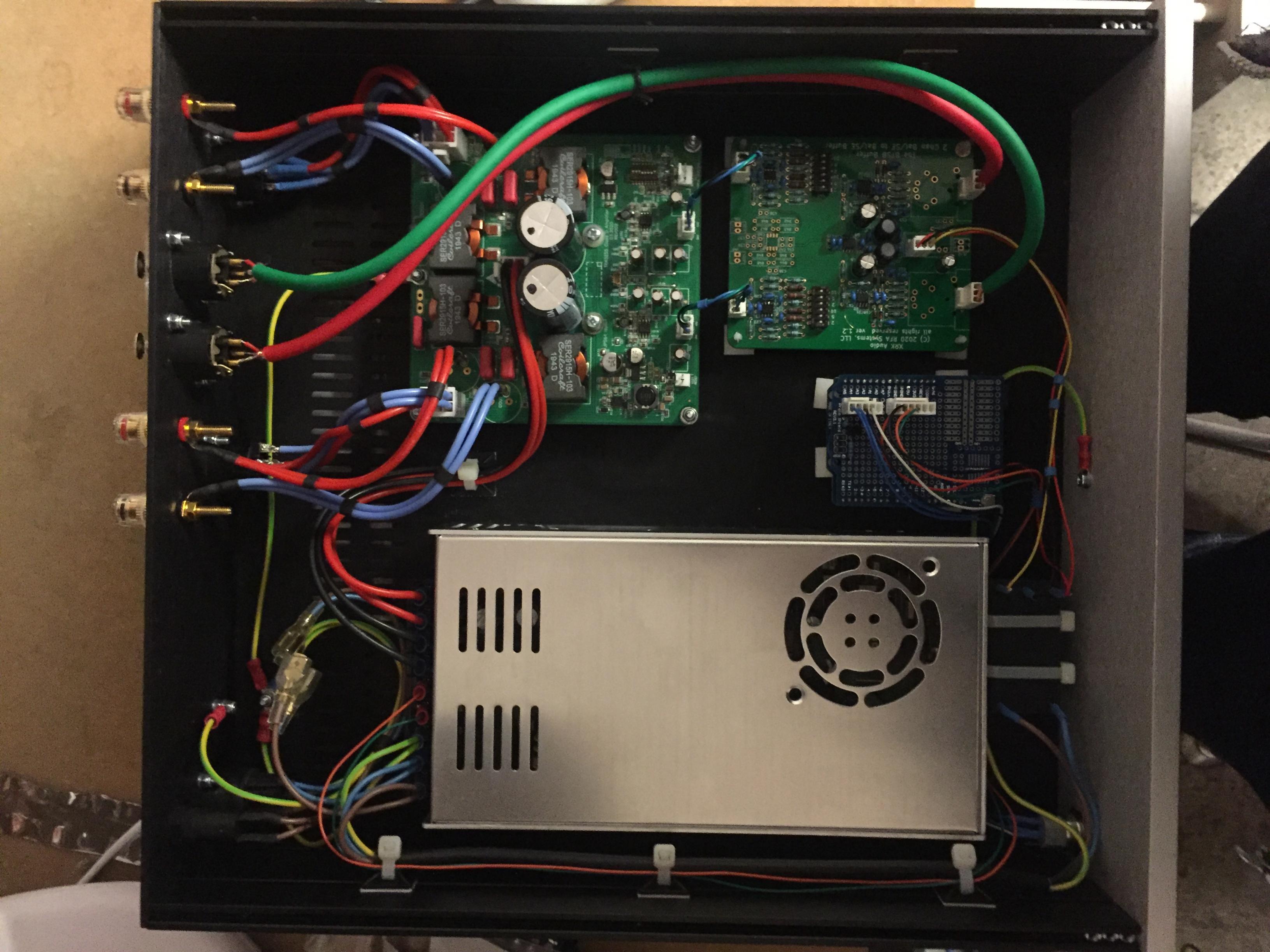

I just fitted the BTSB board to my amp from the first GB. Very happy with this, theres no hiss/hum/turn on noises whatsoever. Working really nice with an RME DAC and Jamo Concert 8.
Hopefully helpful for anyone trying to decide if to build one of these.
