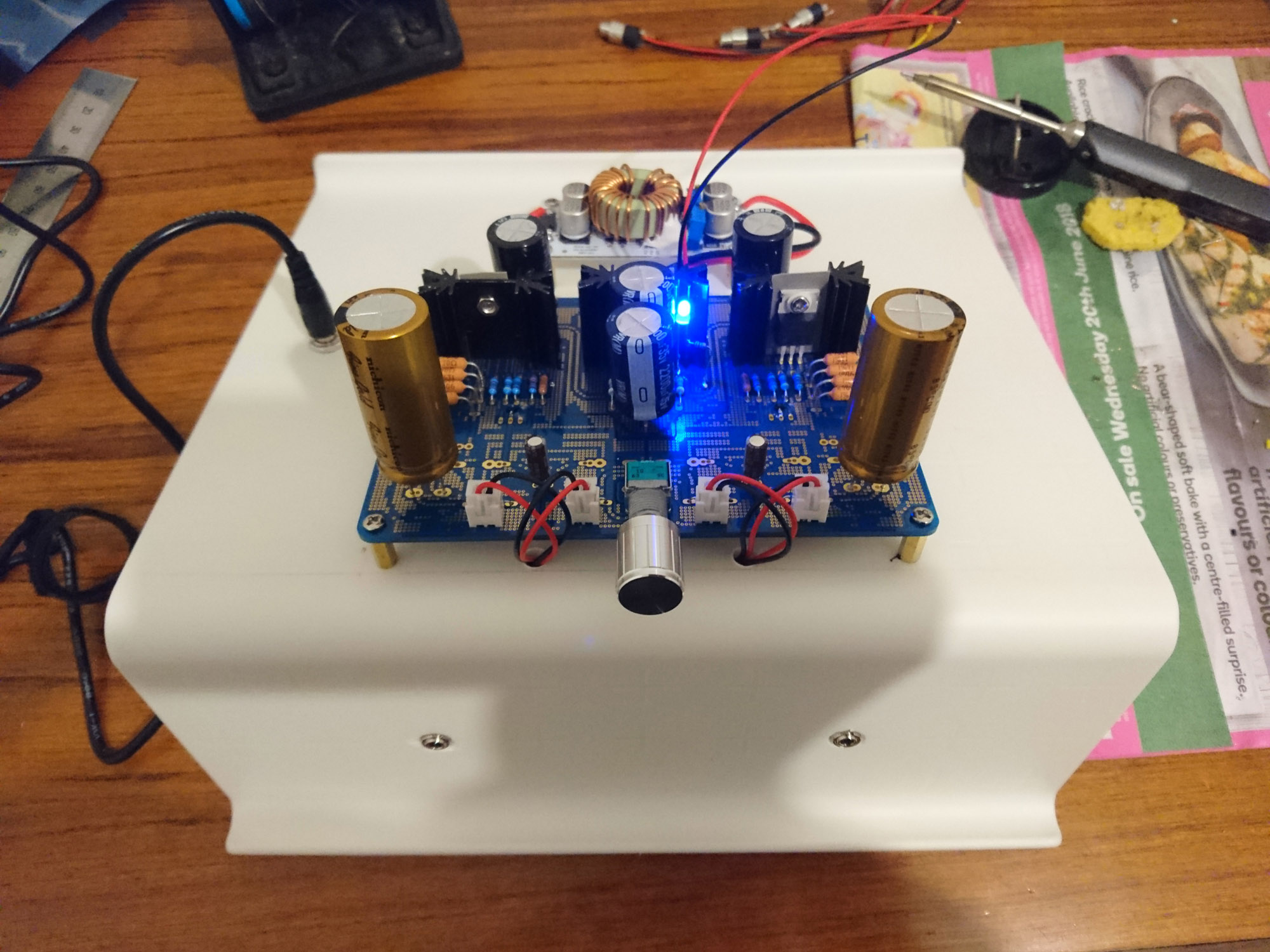

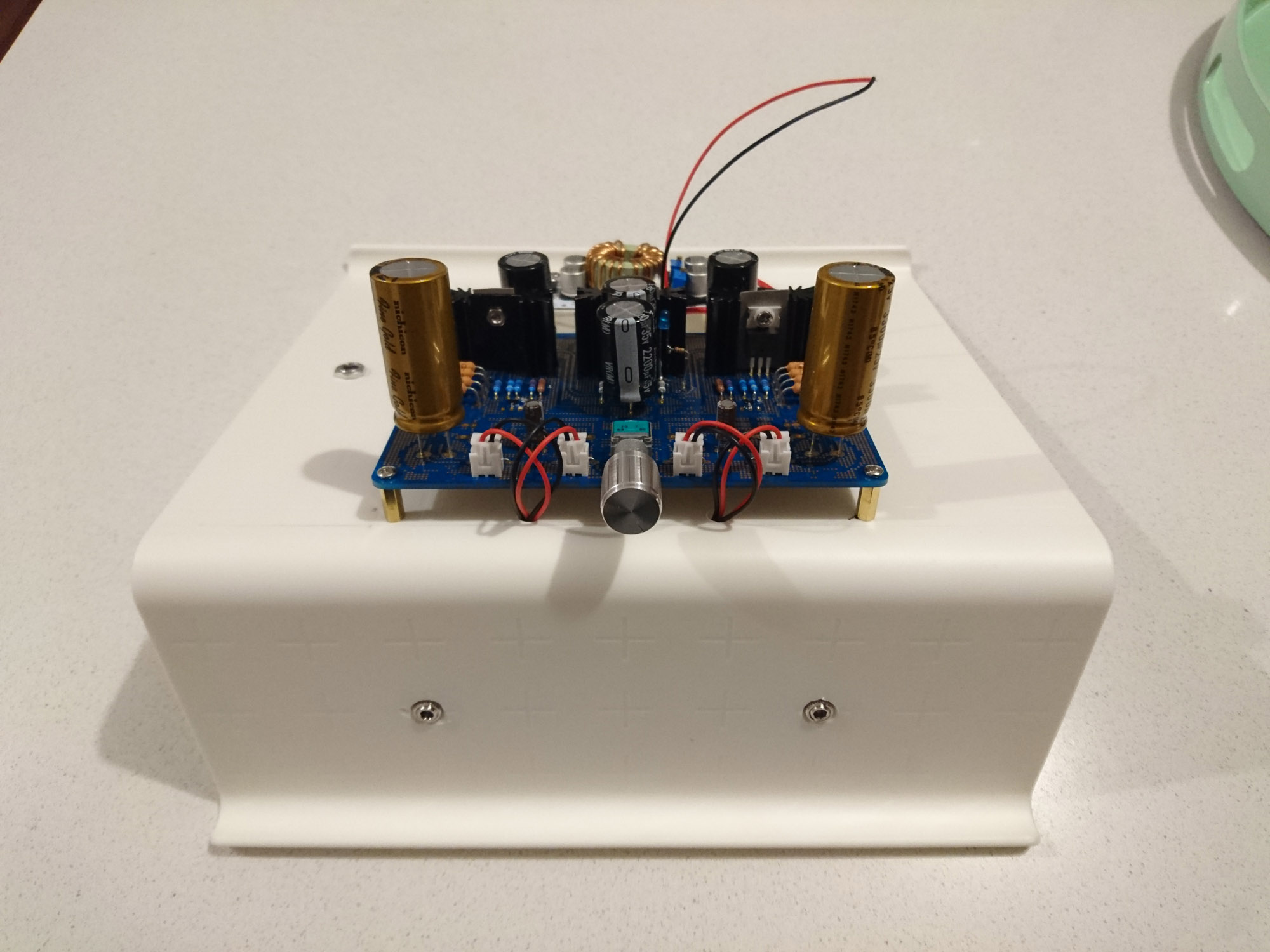

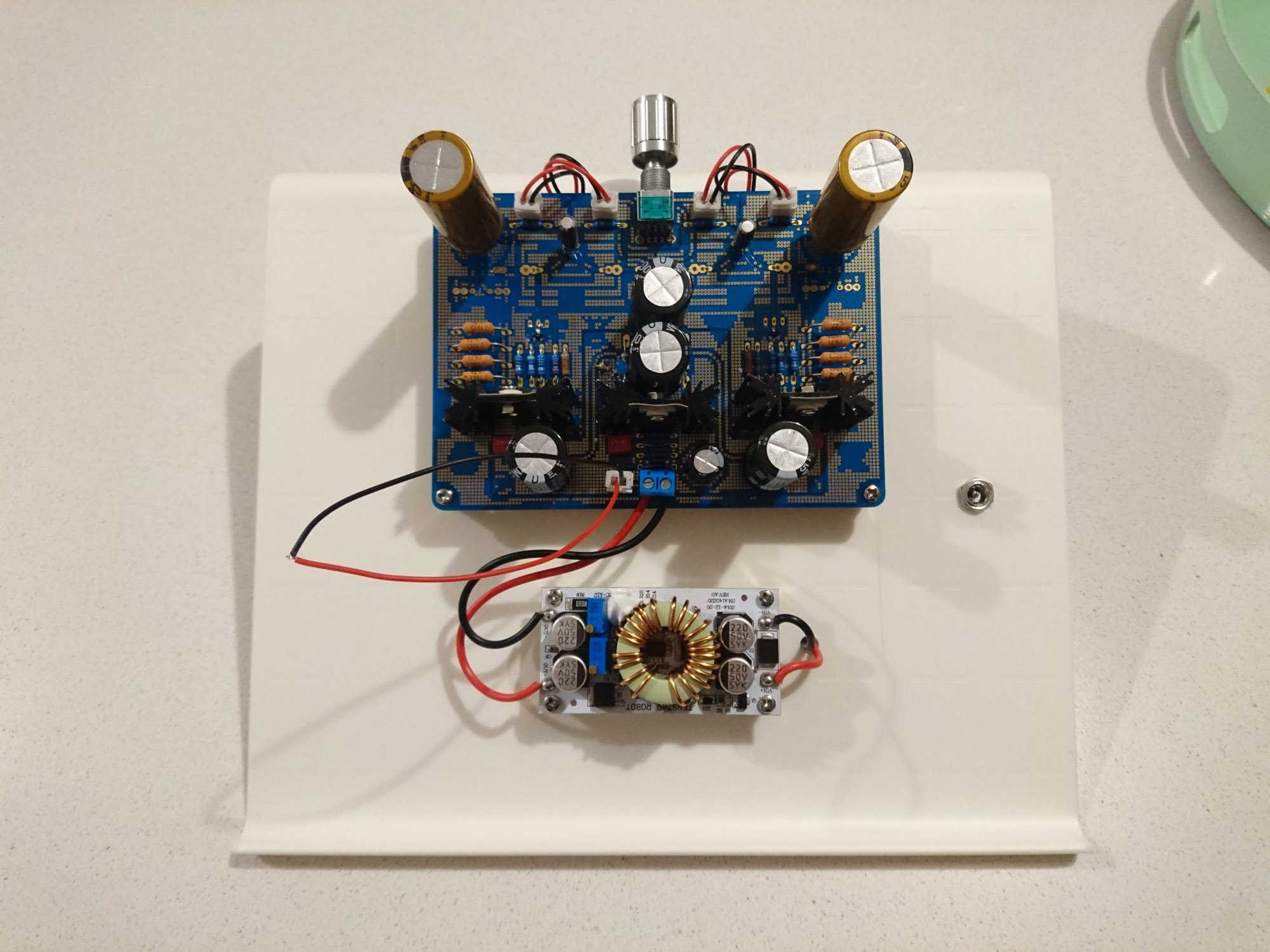

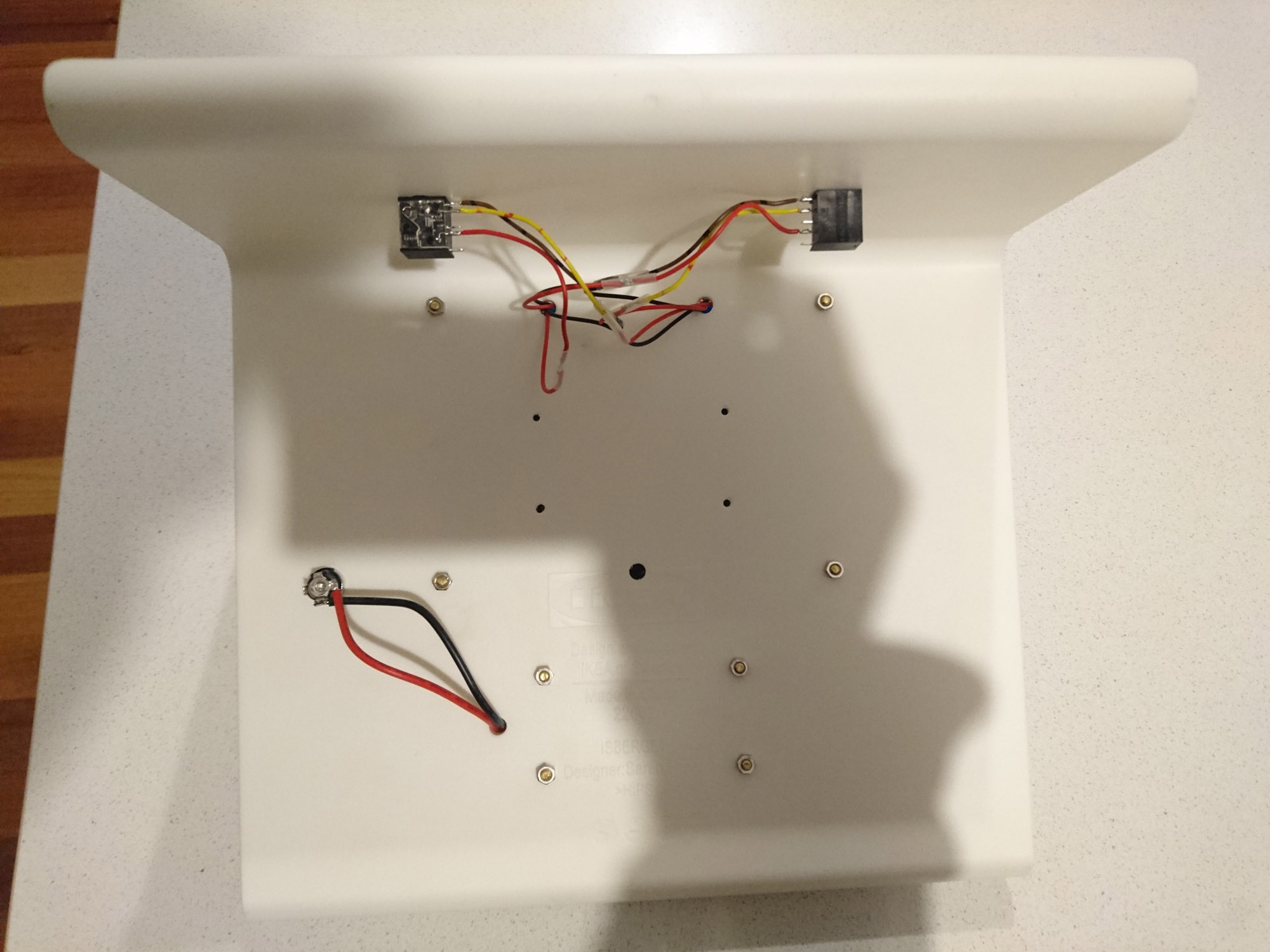

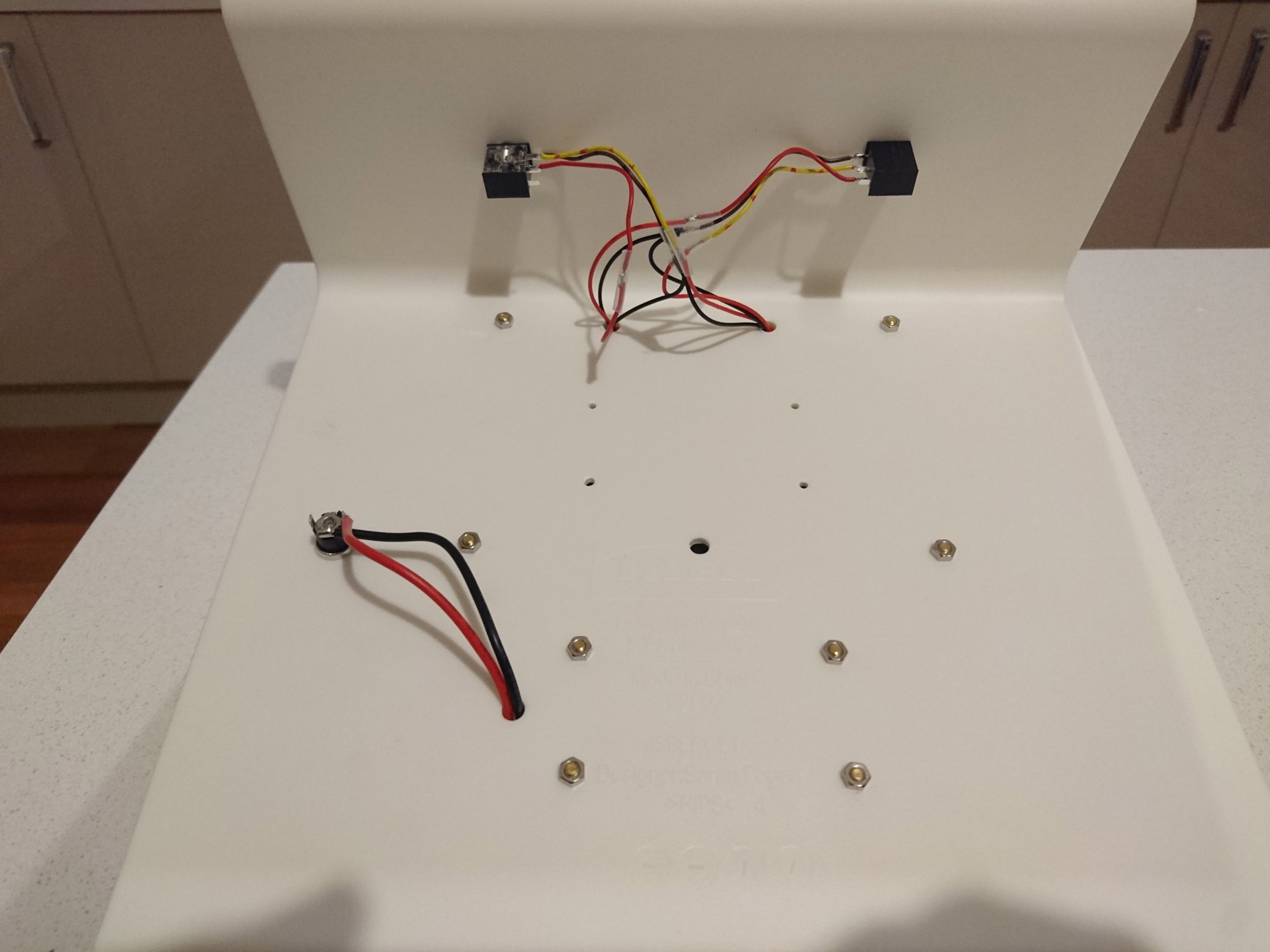

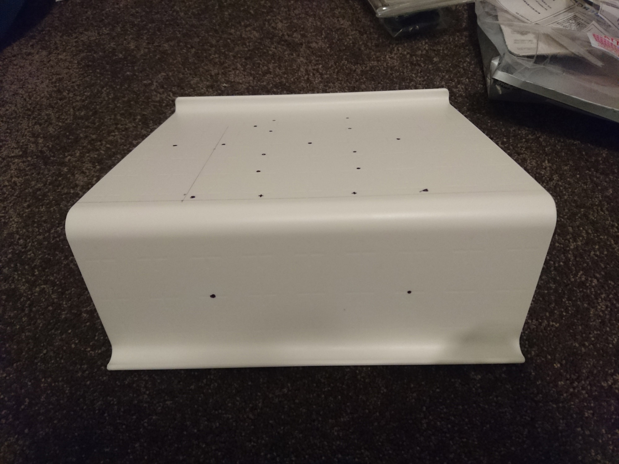

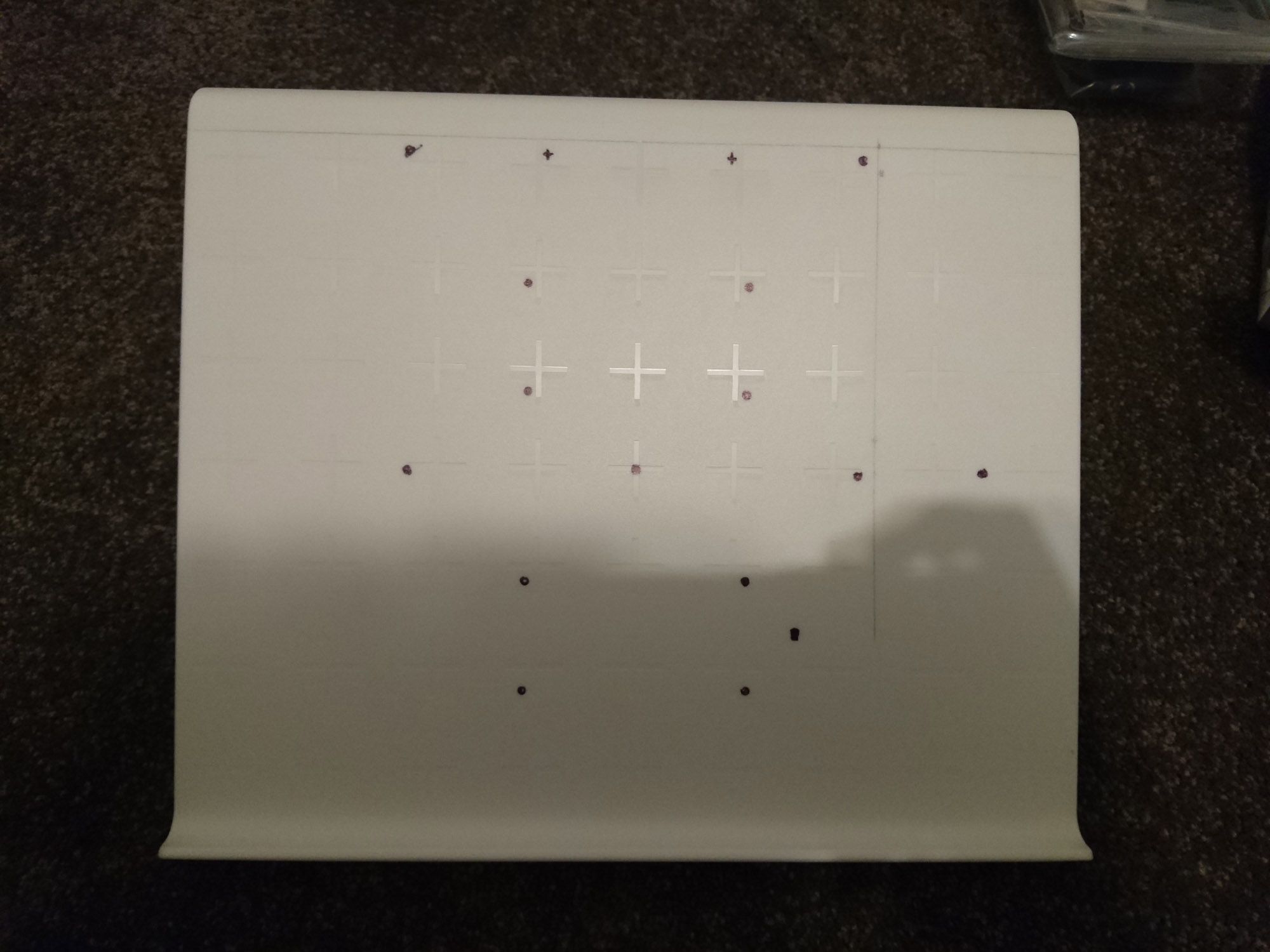

Sunday afternoon fiddling. Got the amplifier and boost mounted onto the ikea tablet stand haha. it was actually pretty thick so had to countersink the holes for the sockets, messed one of them up but overall quite happy. Added extra set of holes for the boost under the DCA board but decided not to use it.
I quite like this mounting method, will probably continue with it for future amps 😉
YOB - Very innovative, fast and cheap. I have done all my diy amps (5 to date and busy with the Aksa Lender preamp now) using perspex and sometimes angled aluminium. All from off-cut materials that I get for free mostly. One word of advice - cover your naked amp when not used. In the space of 2 years my first headamp has gathered so much dust and it is now difficult to clean it. It still works fine!
I actually want to make a similar stand for my cell phone using perspex, since I often use my phone to stream music to my headamp.
