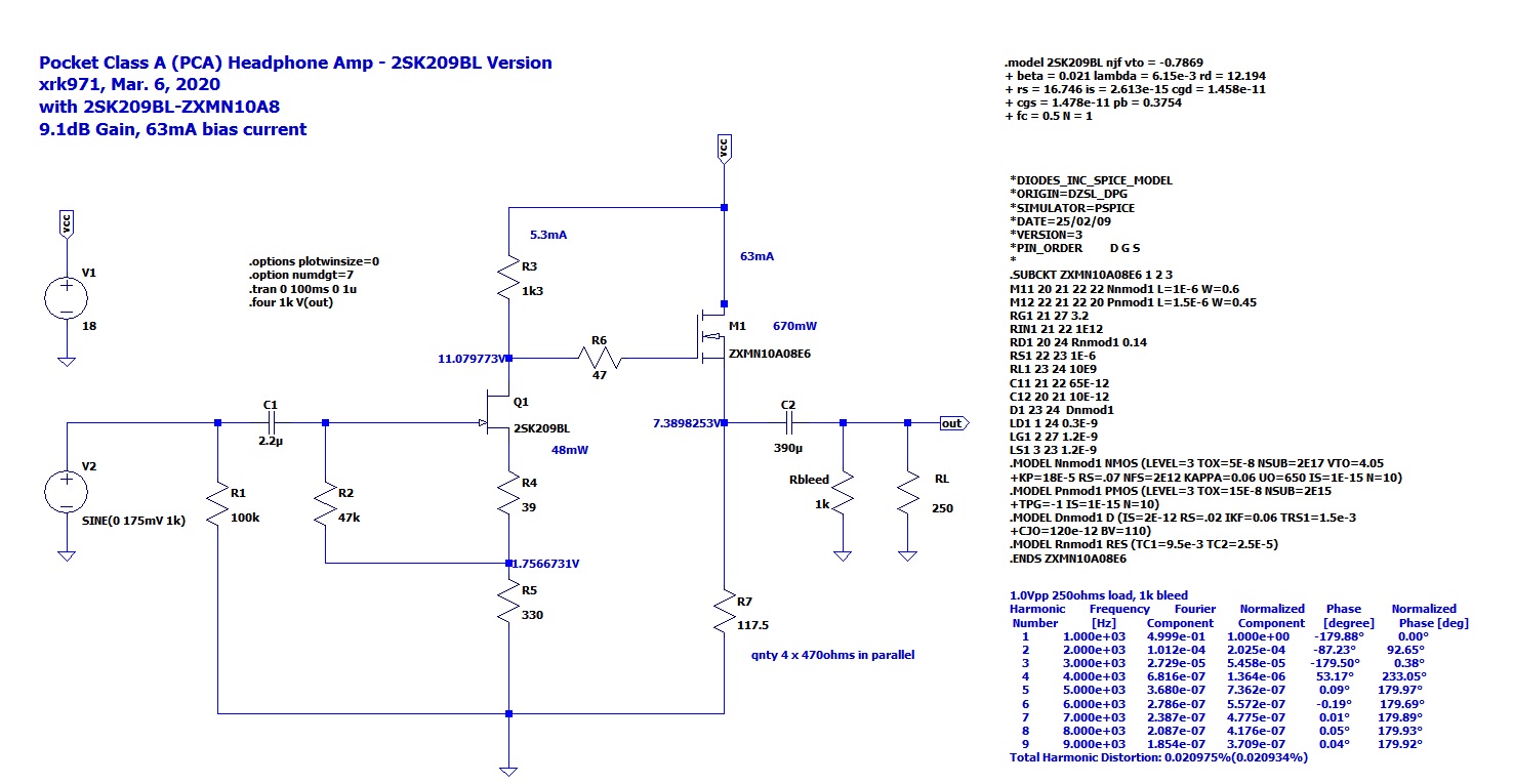

Edit May 28, 2020: Revised Schematic and BOM for 2SK209GR JFET and ZXMN10A08GTA MOSFETs here: xrk971 Pocket Class A Headamp GB

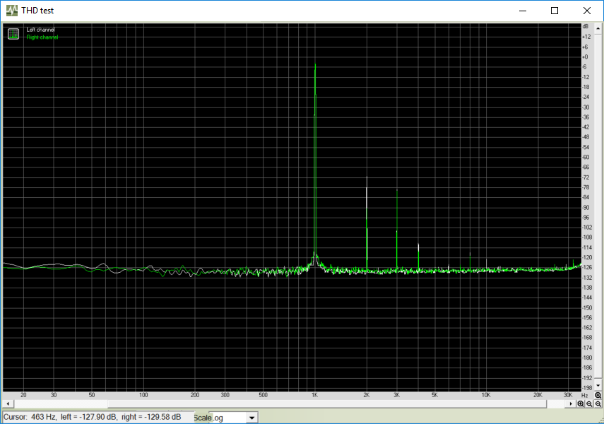

Here is the measured HD using Focusrite Solo 2nd gen at 96kHz and 24bit:

Update Jan 8 2019: New ZXMN10A08GTA to replace ZVN4306GTA provides higher transconductance for lower output impedance and higher damping factor. xrk971 Pocket Class A Headamp GB
Update Mar 6, 2020: New Resistors for 2SK209BL and ZXMN10A08
![595010d1485521883-xrk971-pocket-class-headamp-gb-img_6145.png](https://www.diyaudio.com/forums/attachments/group-buys/595010d1485521883-xrk971-pocket-class-headamp-gb-img_6145.png)

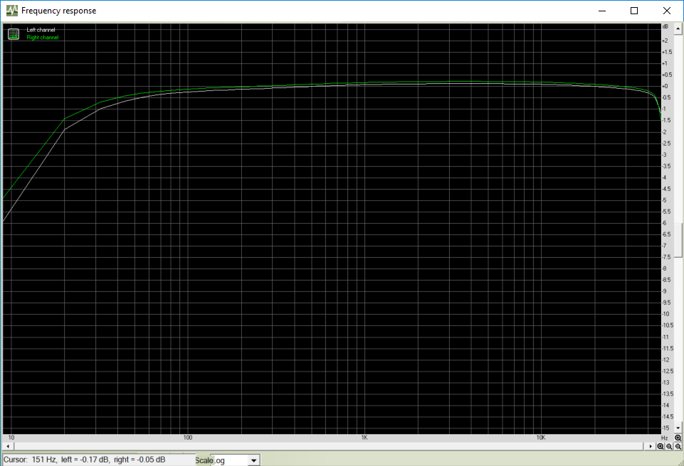

Edit Feb. 18, 2017 - Here is the latest measured frequency response and THD from the GB PCB:
![s-l1600.jpg](https://i.ebayimg.com/images/g/lg4AAOSw~AVYqBFe/s-l1600.jpg)
