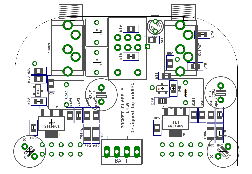

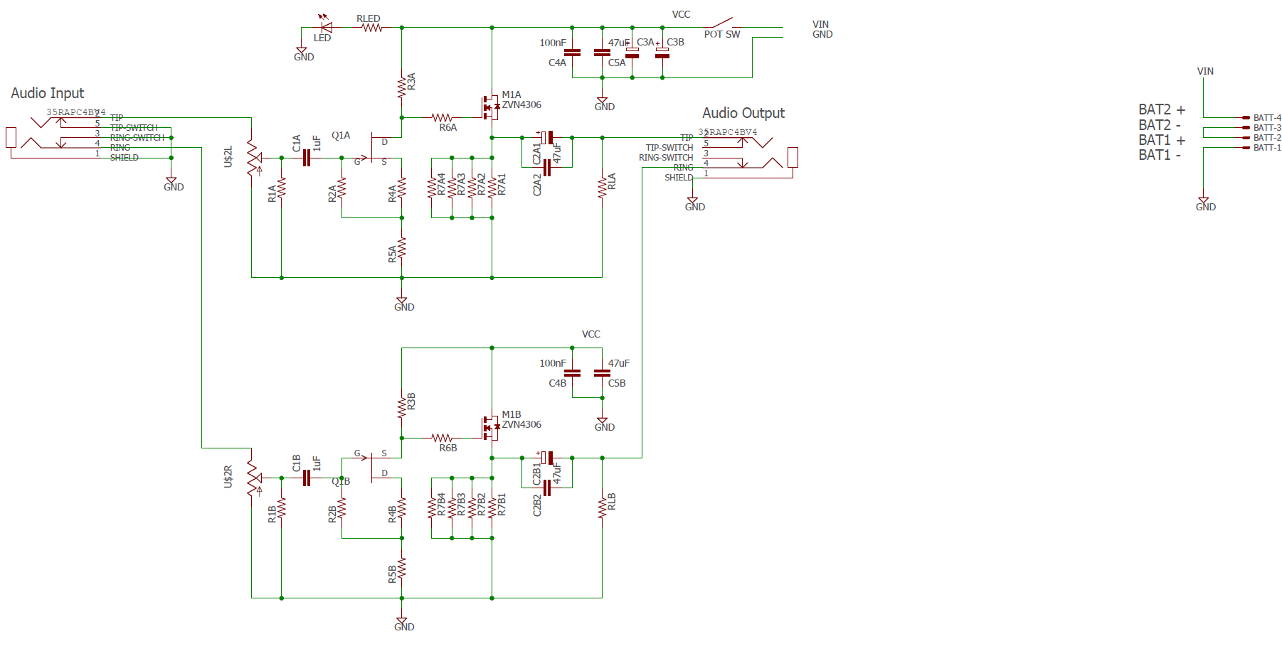

Revised Board Schematic, Silkscreen, and BOM
Thanks to BDHM for revising the schematic to be easier to use with designations A and B for left and right and paralleled parts with sub-numbers. Below are the new schematic, board silkscreens on topside (through hole) and bottomside (SMT) so you can see where everything goes.
Schematic:
Top side Layout Silkscreen:

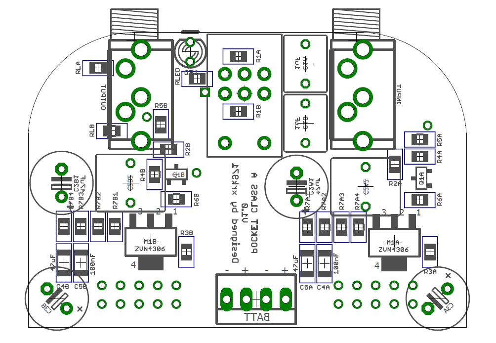

Bottom side Layout Silkscreen (note that 100nF C4A and C4B are mislabled 47uF - need to rework this before sending to fab):
Schematic:
![596768d1486181745-xrk971-pocket-class-headamp-gb-xrk971-pocket-class-headamp-schematic-v8.png](https://www.diyaudio.com/forums/attachments/group-buys/596768d1486181745-xrk971-pocket-class-headamp-gb-xrk971-pocket-class-headamp-schematic-v8.png)
![596769d1486181745-xrk971-pocket-class-headamp-gb-xrk971-pocket-class-headamp-board-side-top-v8.png](https://www.diyaudio.com/forums/attachments/group-buys/596769d1486181745-xrk971-pocket-class-headamp-gb-xrk971-pocket-class-headamp-board-side-top-v8.png)
![596770d1486181745-xrk971-pocket-class-headamp-gb-xrk971-pocket-class-headamp-board-side-bottom-v8.png](https://www.diyaudio.com/forums/attachments/group-buys/596770d1486181745-xrk971-pocket-class-headamp-gb-xrk971-pocket-class-headamp-board-side-bottom-v8.png)

Code:
All resistors 0805 package, metal thin film, 1% on specified parts, else 5%. Yageo 1% 0805 SMT from Digikey are $0.77 for 100
R1 100k (5%)
R2 47k (1%)
R3 1k (1%)
R4 33R (1%)
R5 270R (1%)
R6 47R (5%)
R7_1 470R (1%)
R7_2 470R (1%)
R7_3 470R (1%)
R7_4 470R (1%)
RL 270R (5%) User select (optional, use for higher current draw on amp)
RLED 15k (5%) Current limit for LED, 15k or value according to supply voltage
C1 Input cap 5mm pitch up to 5.5mm wide (Wima 2.2uF MKS2B042201F00JSSD)
C2_1 Output cap 3.5mm pitch, 8 dia (390uF 20v Panasonic OSCON 20SEPF390M)
C2_2 Output cap 5mm pitch, up to 9mm wide (Wima 1uF MKS2C041001F00KSSD)
C3 Rail cap 100uF 3.5mm pitch, diameter whatever you can fit in the tin (100uF 20v Panasonic OSCON 20SEP100MX)
C4 Rail cap 100nF 1206 package (50v X7R)
C5 Additional 100nF rail cap 1206 package (50v X7R)
Q1 BF862 (771-BF862-T/R)
M1 ZVN4306GTA
Switchcraft 3.5mm stereo jacks x2 (35RAPC4BV4)
Alps 10kOhm stereo pot with power switch (RK0971221Z05)
3mm round LED (red or green)
4-pin 2.54mm pitch power connector (see post #44)

We just need to get the silkscreen fixed for C4A and C5B to show 10nF rather than 47uF then we are ready to get the boards made.
