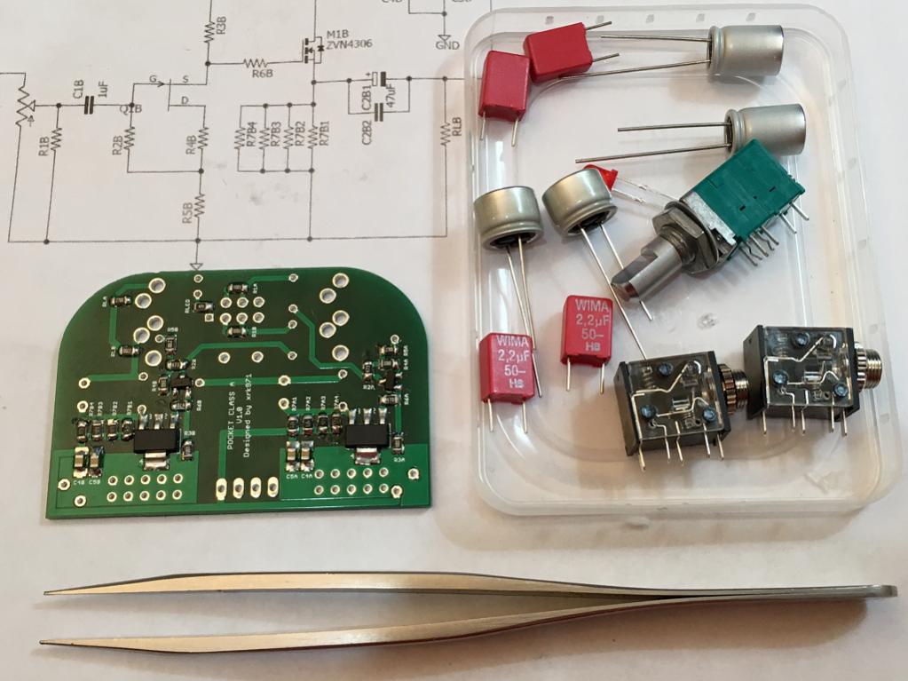

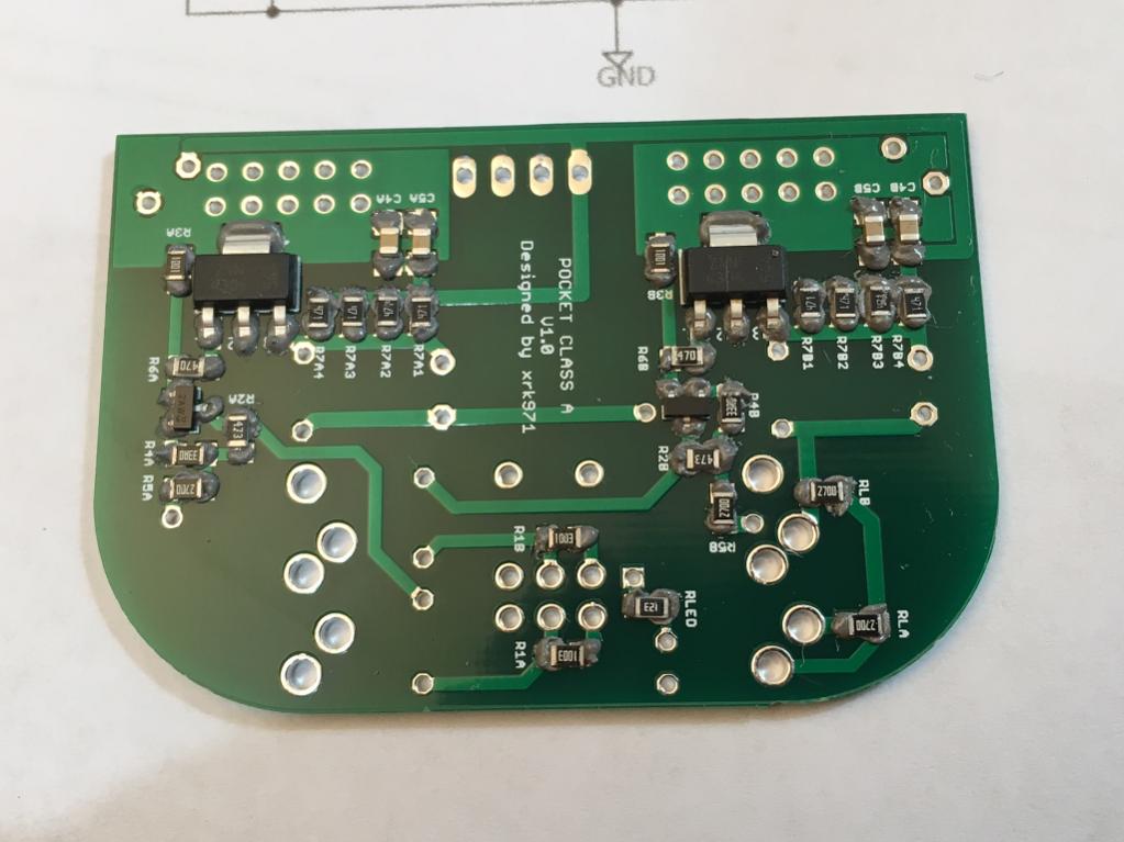

This is a nice board, really easy to build. I could have soldered it by hand but thought I would give syringe applied reflow solder paste a try. Here is the board with solder paste and parts place on the blobs of paste. I am using Kester EP623.
![598238d1486680129-xrk971-pocket-class-headamp-gb-pocket-class-headamp-test-00.jpg](https://www.diyaudio.com/forums/attachments/group-buys/598238d1486680129-xrk971-pocket-class-headamp-gb-pocket-class-headamp-test-00.jpg)
Here is the board after cooking it on a hot plate (set at medium) for bout 90 seconds (long enough for dull gray paste to turn liquid and shiny silver). That was so much faster than hand soldering!
![598239d1486680129-xrk971-pocket-class-headamp-gb-pocket-class-headamp-test-01.jpg](https://www.diyaudio.com/forums/attachments/group-buys/598239d1486680129-xrk971-pocket-class-headamp-gb-pocket-class-headamp-test-01.jpg)
Here are all the through hole parts kitted up and ready to go - real big stuff:
![598240d1486680129-xrk971-pocket-class-headamp-gb-pocket-class-headamp-test-02.jpg](https://www.diyaudio.com/forums/attachments/group-buys/598240d1486680129-xrk971-pocket-class-headamp-gb-pocket-class-headamp-test-02.jpg)
I was able to build and have sound out in 2hrs flat. It would slower with manual soldering but maybe 1 more hour. The planets were all aligned and the gods must have smiled upon me because it fired up the first time. Bias current through the four parallel resistors was 50mA (6v over 118R) exactly - a perfect setting. The DC voltage coming out of the MOSFET source pin was about 9v - a good value. There are things we can do if the bias is too high (like 65mA ot above):
![598241d1486680129-xrk971-pocket-class-headamp-gb-pocket-class-headamp-test-03.jpg](https://www.diyaudio.com/forums/attachments/group-buys/598241d1486680129-xrk971-pocket-class-headamp-gb-pocket-class-headamp-test-03.jpg)
Here is the through hole side (which will be hidden from view when the board is in the tin:
![598242d1486680129-xrk971-pocket-class-headamp-gb-pocket-class-headamp-test-04.jpg](https://www.diyaudio.com/forums/attachments/group-buys/598242d1486680129-xrk971-pocket-class-headamp-gb-pocket-class-headamp-test-04.jpg)

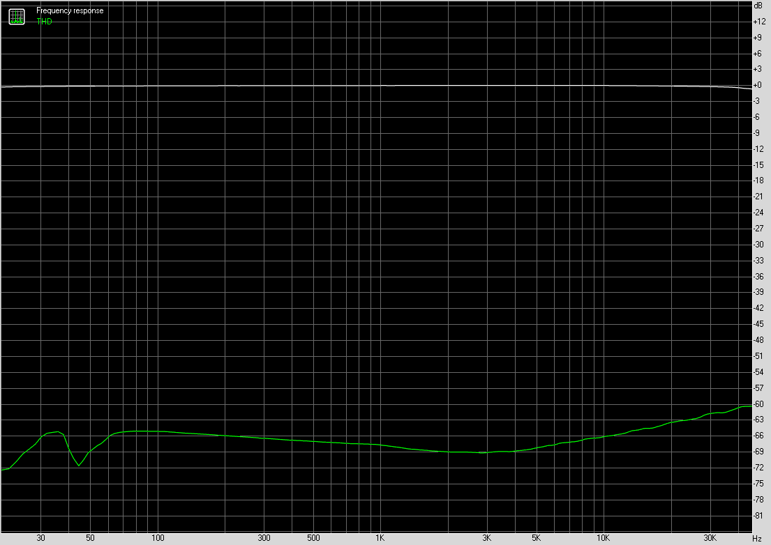

Measurements of GB test amp #1

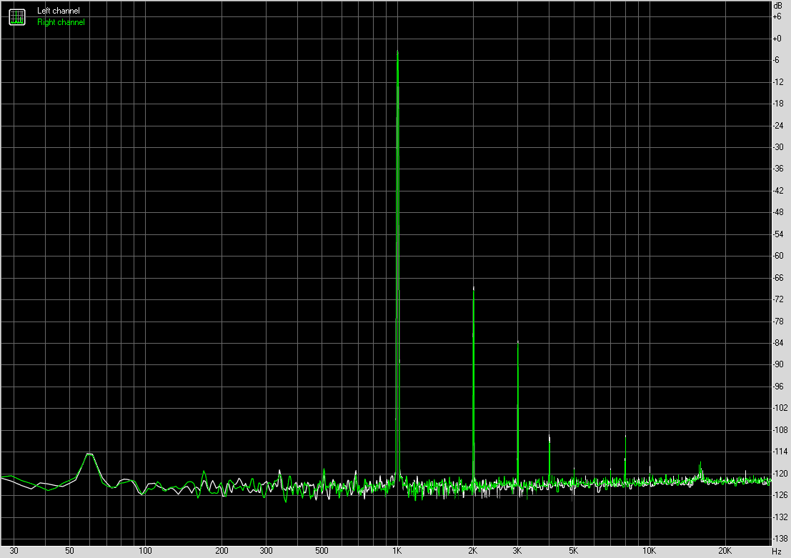

So depending on the Idss and Vgs of your particular BF862's, you may want to adjust R4 up or down a bit to get the bias current closer to what you want. I changed the value of R4 from the nominal 33R to 47R and it provides a 55mA bias current, up from 50mA. The overall sound is just much more engaging. You can adjust to taste but don't go too far off the typical values of 33R, 47R, 51R, 68R, 100R.
Here is the measured HD spectrum at 1kHz and driving 700mV int 270R load - you can see the noise flor is about -123dB, the 60Hz bump is EMI pickup since it is not in a case - all battery operation including laptop and sound interface, indicated THD was 0.053% and IMD is 0.049%:
Here is the measured frequency response and THD vs frequency - this confirms why the bass response is so powerful:
Attached is also a sound clip using the same reference as the Headamp comparo thread. Change the .asc extension to .mp3 to listen.
![598298d1486700146-xrk971-pocket-class-headamp-gb-pocket-class-gb1-47r-hd.png](https://www.diyaudio.com/forums/attachments/group-buys/598298d1486700146-xrk971-pocket-class-headamp-gb-pocket-class-gb1-47r-hd.png)
![598299d1486700146-xrk971-pocket-class-headamp-gb-pocket-class-gb1-47r-fr.png](https://www.diyaudio.com/forums/attachments/group-buys/598299d1486700146-xrk971-pocket-class-headamp-gb-pocket-class-gb1-47r-fr.png)

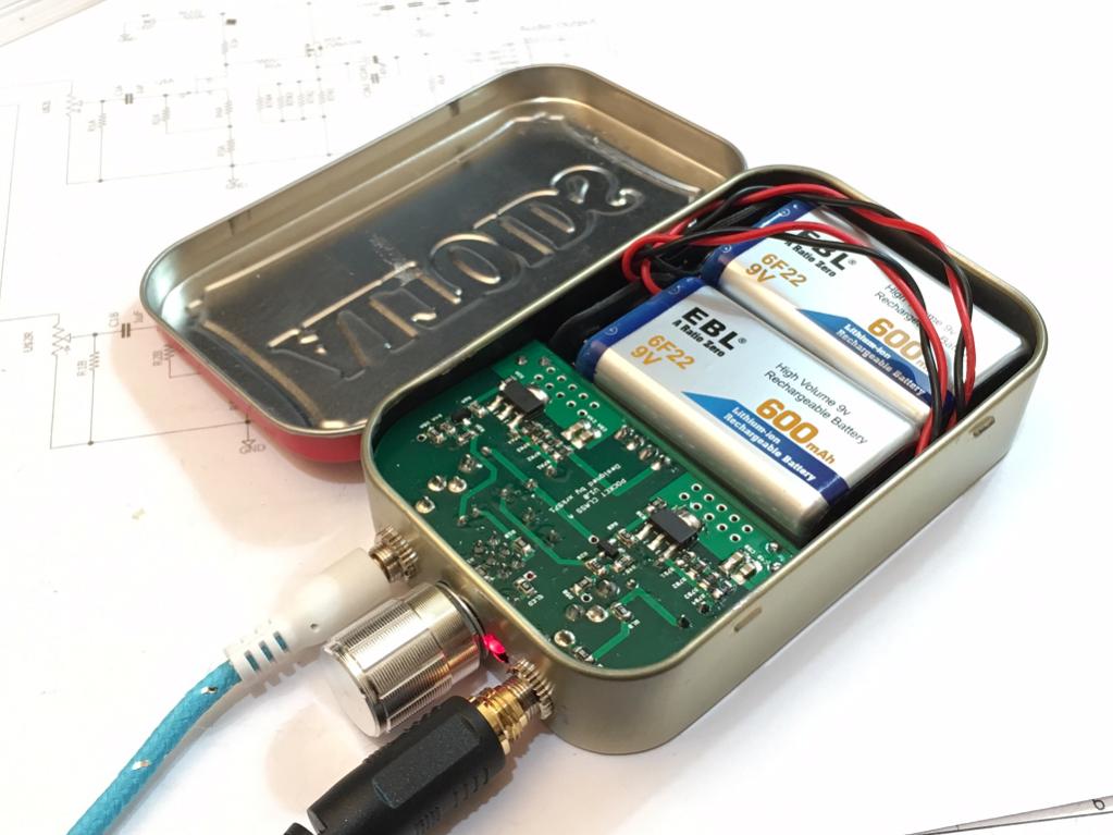

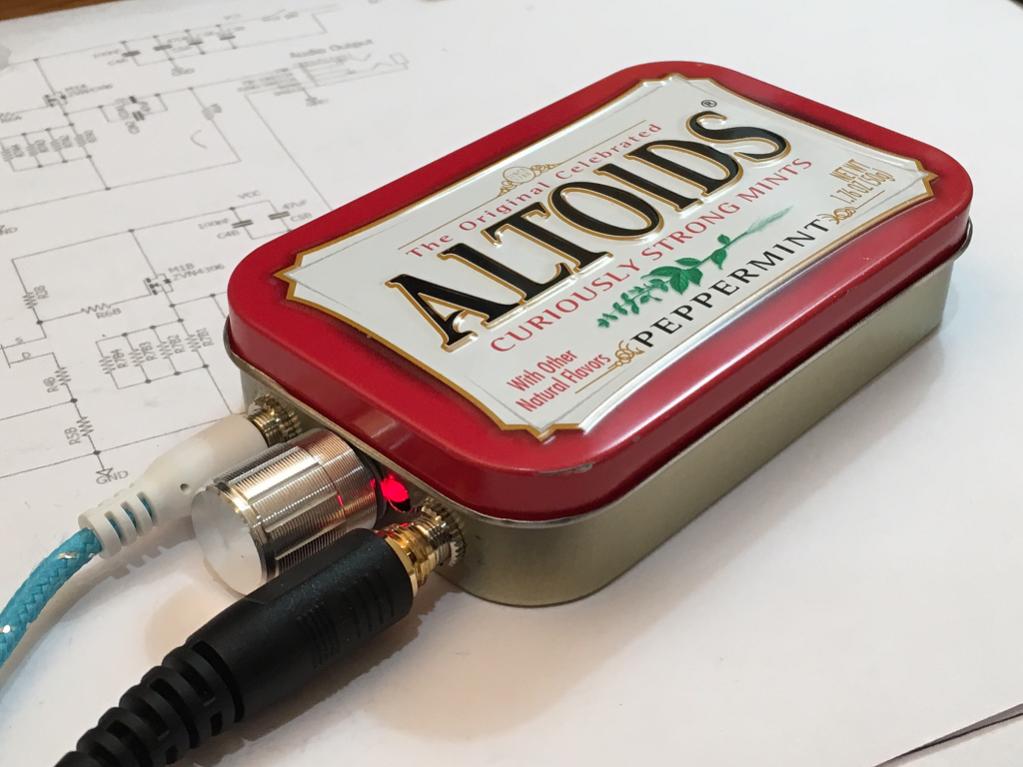

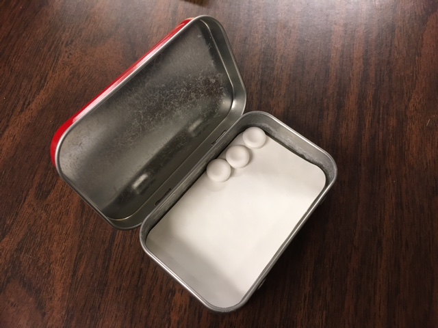

Here is the Pocket Class A amp inside a tin. It truly is the only pocketable SE Class A headamp out there.
Very nice X, take a bow.
Now in place of "Curiously Strong Mints" maybe the slogan should be "Curiously Good Sound" ?
I was really blown away by how good Bruce Springsteen can sound on this amp.
