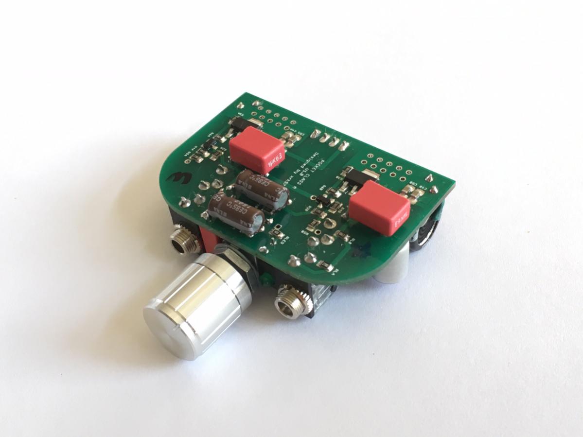

New photos for eBay listing - special limited time pricing of complete amp ready to use.
Pocket Class A Headphone Amplifier / Desktop Amplifier | eBay
...special limited time pricing of complete amp ready to use...

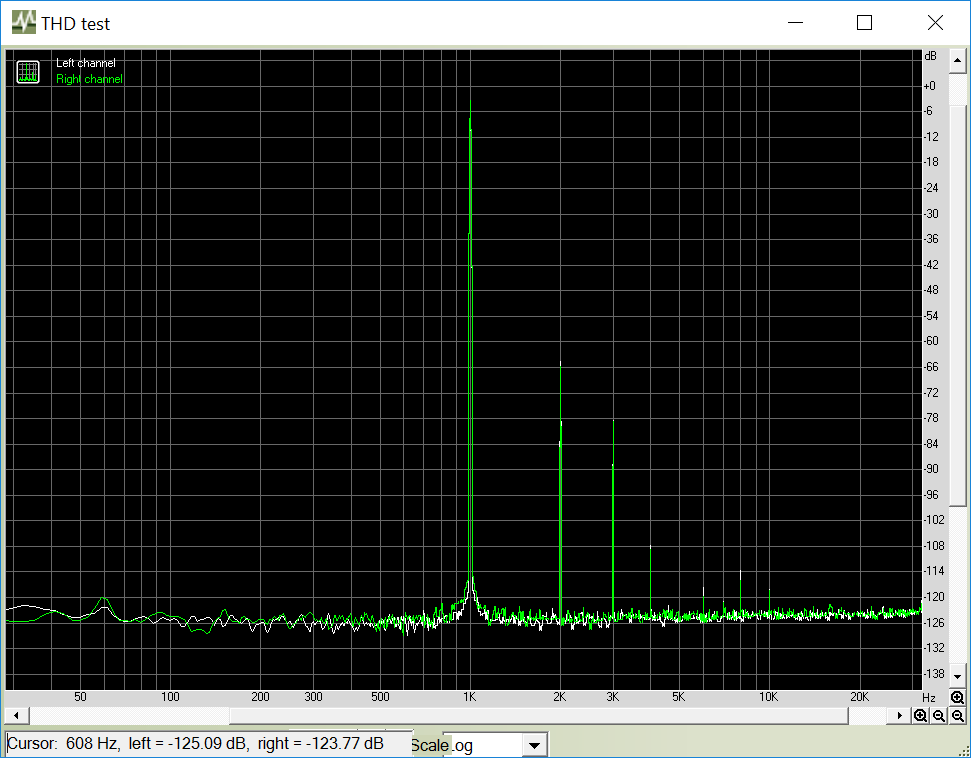

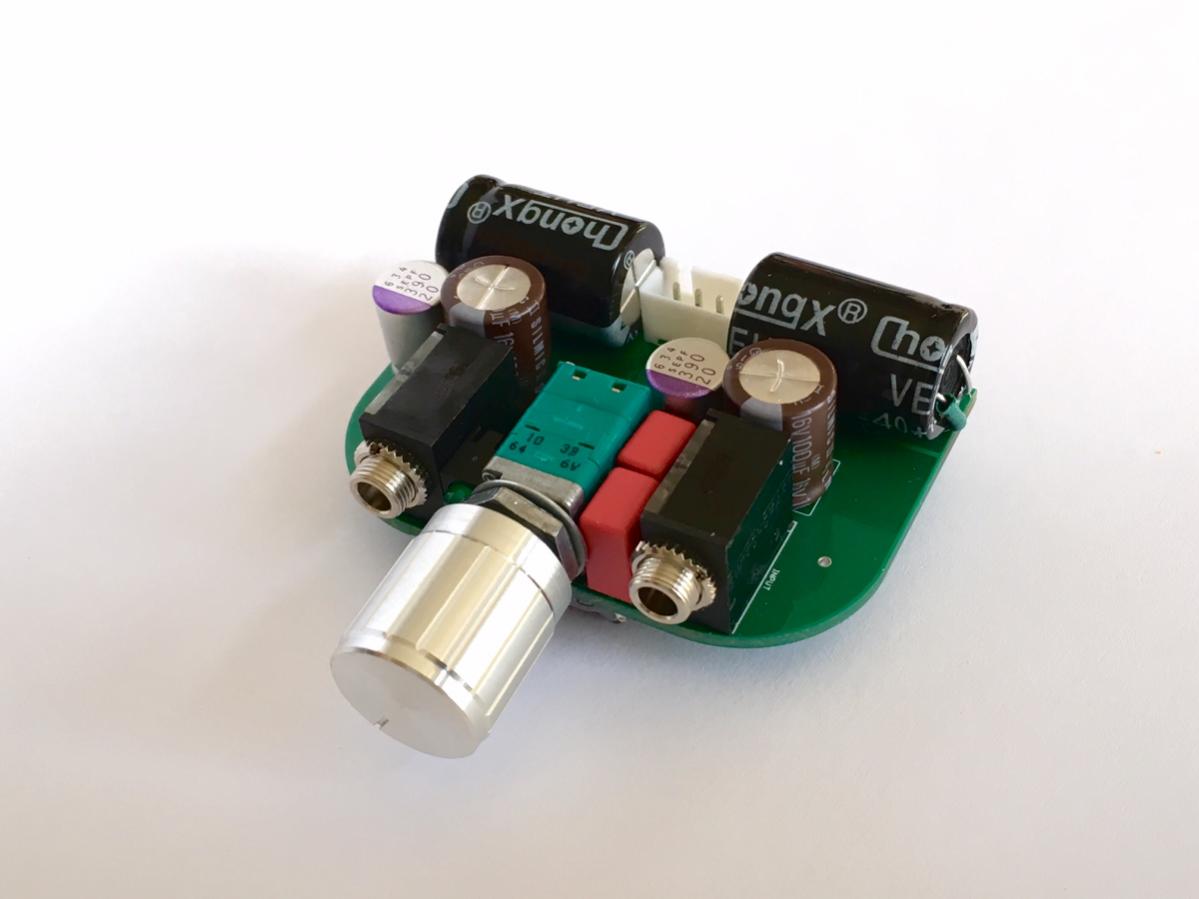

Some playing around with my personal cap-rolling test-bed.
On inputs: Wima 2.2uF + Elna Silmic II 4.7uF
On outputs: Wima 1uF + Elna Silmic II 100uF + Panasonic OSCON 390uF
On power rails: no-name (Chongx) 2200uF 24v (12mm dia x 20mm long fits) this will let me try a higher power supply voltage of 19v.
Spent some time last night listening to it - very very nice combo and fits nicely on the board. Super bass extension and midgrange smoothness and treble clarity with no harshness or sibillance. I just got some DT770-250's for a friend and listened to them for a while. I like the DT880-250's better. The 770's are sealed back and bass reflex (with a small port) - they isolate sound well, but for my ears, sound a tad too bright. Looking at measured curves shows more HF extension and a peak near 10k compared to 880's. If your hearing is soft on the highs, you may like 770's better for their treble enhancement.

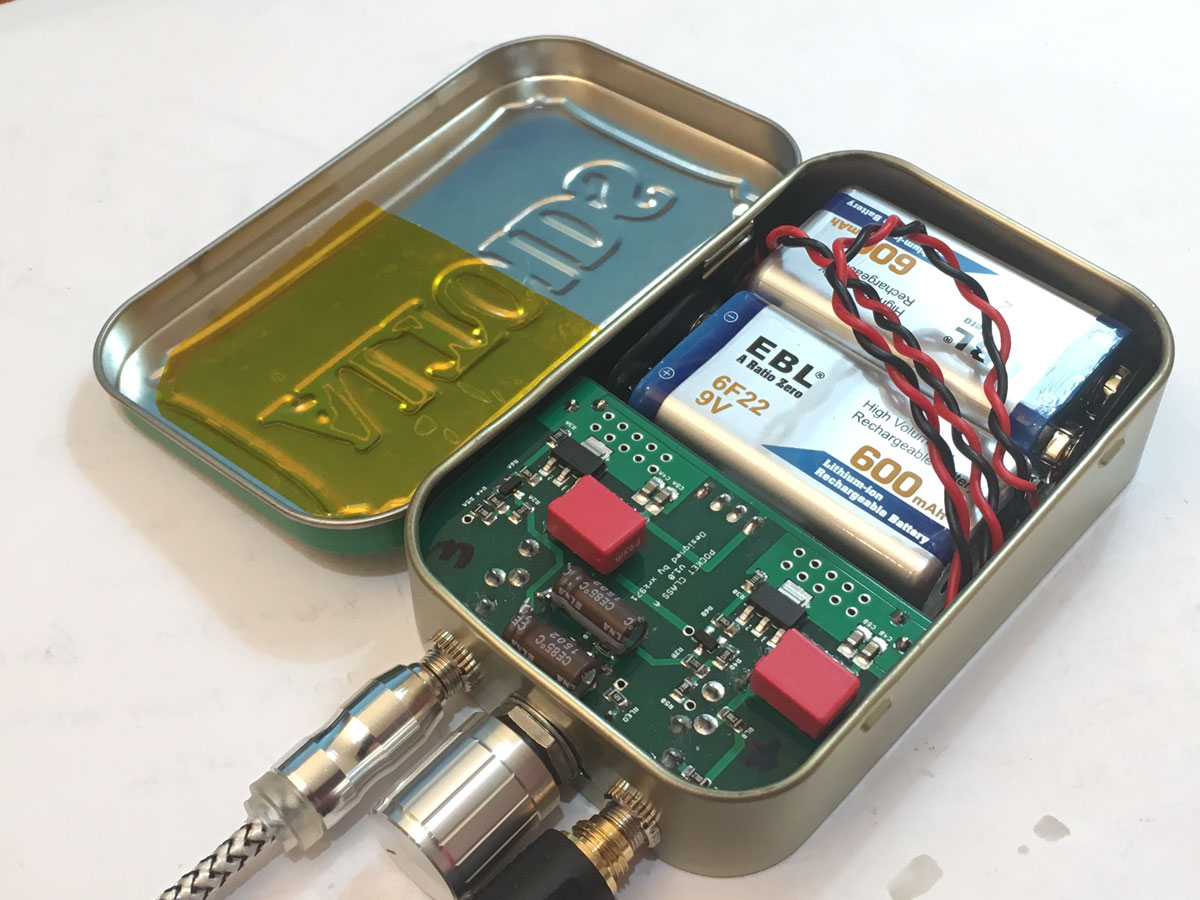

If you want to run the amp in desktop mode with a 19v PSU - I recommend a higher rated rail cap. I found a non-name Chongx 2200uF 24v from Aliexpress that is 13mm x 20mm but can fit perfectly in the tin (see photo of above PCB now fitted into tin). I have not been able to find an equivalent 2200uF cap from a major label. The Chongx, btw, measured better than the Nichicon on my LCR meter with 0.06ohm ESR (10kHz) and 2000uF. Over 3 samples pretty consistent. $1.39 for bag of 10. Will take 3 weeks to get to you though.
https://www.aliexpress.com/item/25V...rs-25-V-2200-UF-size-13-21mm/32741284380.html
