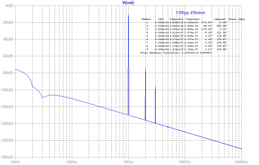

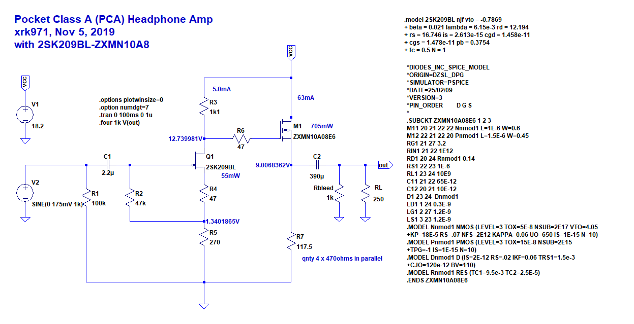

Btw, the BF862 JFET is EOL and so is the ZVN4306 MOSFET, so I just ran a new simulation using the 2SK209BL ( I know that only GR's seem to be available so I reduced the current to about 5mA to be compatible). I replaced the ZVN with a ZXMN10A08 MOSFET. Both parts seem to have Spice models.
The interesting thing is that it all seems to work with basically the same settings as before with slight change of R3 to 1k1. I am recommending that the output bleed resistor be changed to 1k so that it does not pull down the impedance too much when using lower impedance cans.
Here is revised schematic:
63mA bias at 16.3v and 76mA at 18.2v supply.
Here is predicted THD (0.06%)and FFT (mostly H2 and less H3 and nothing else) for 1Vpp into a 250ohm load:
I am going to have to test it out - but looks like it can all work.

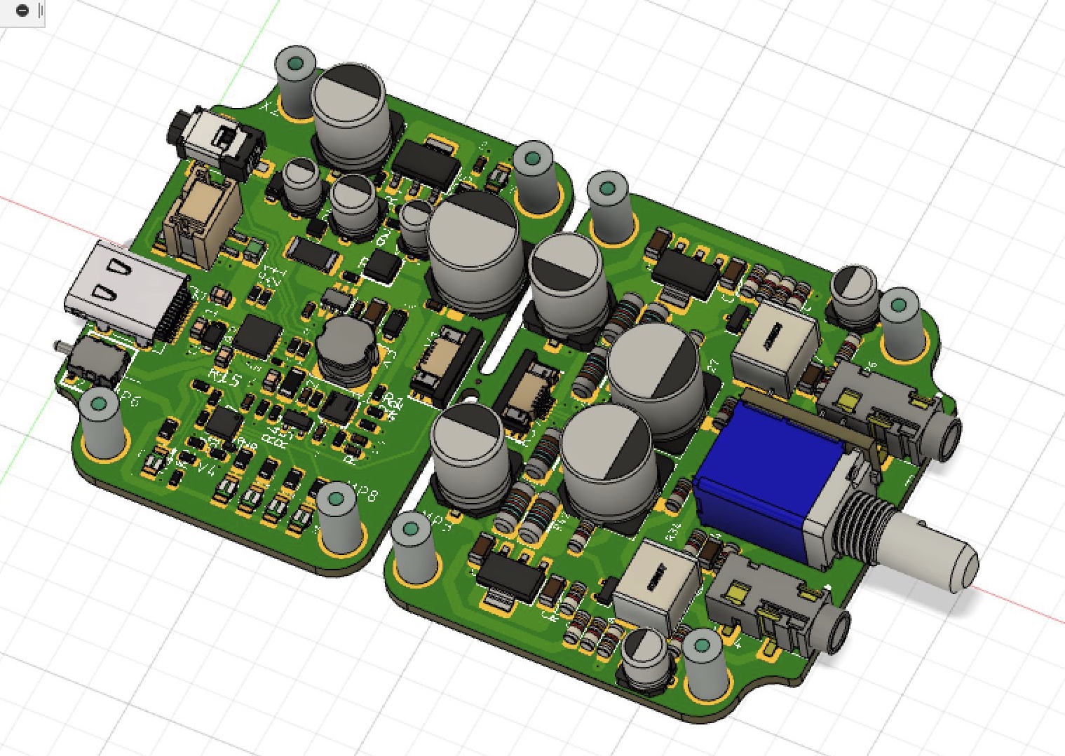

Just a crazy idea for the future...

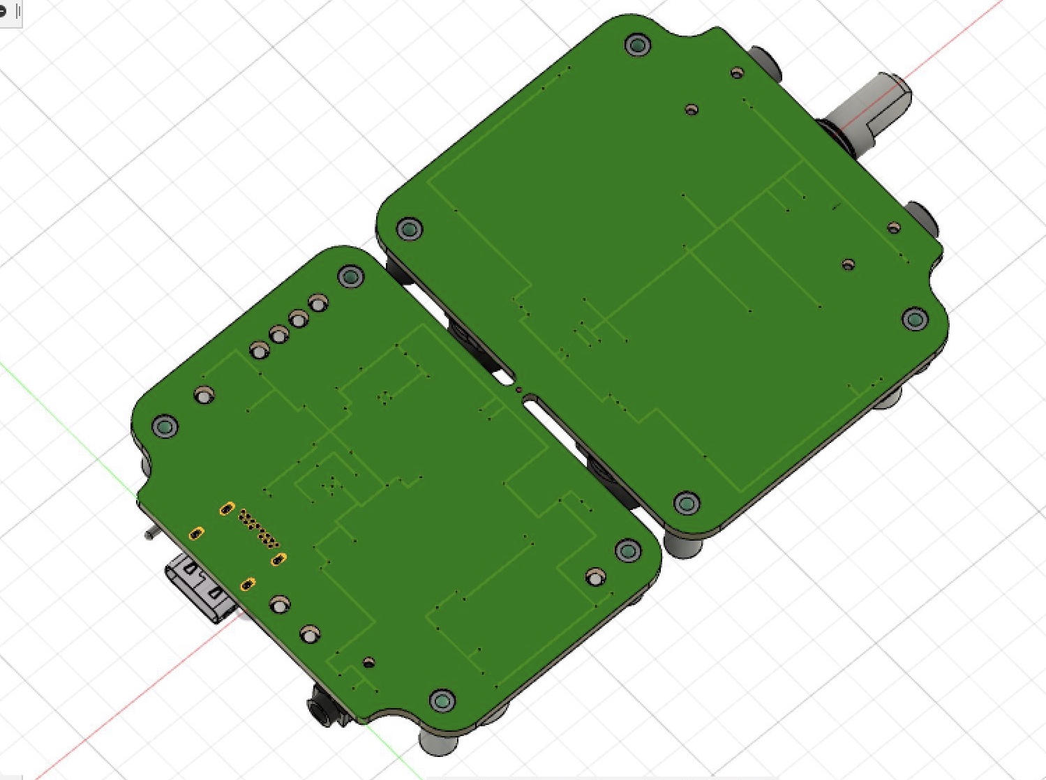

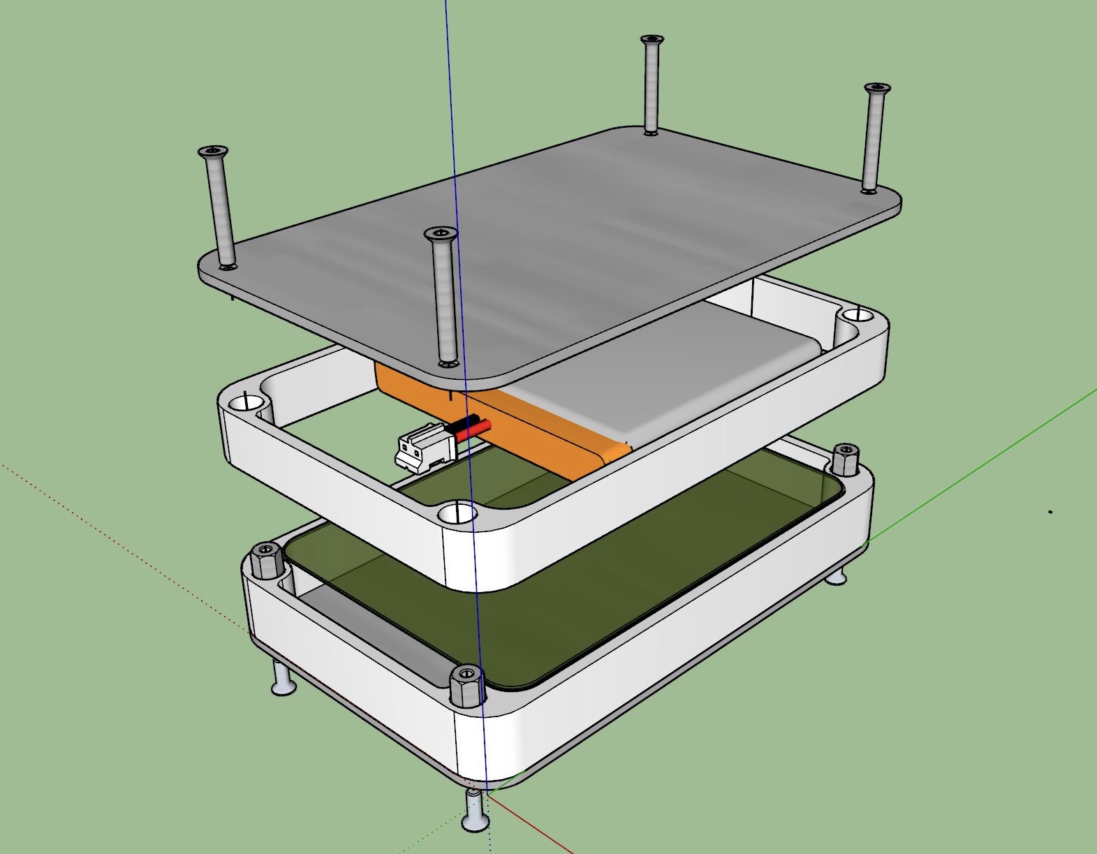

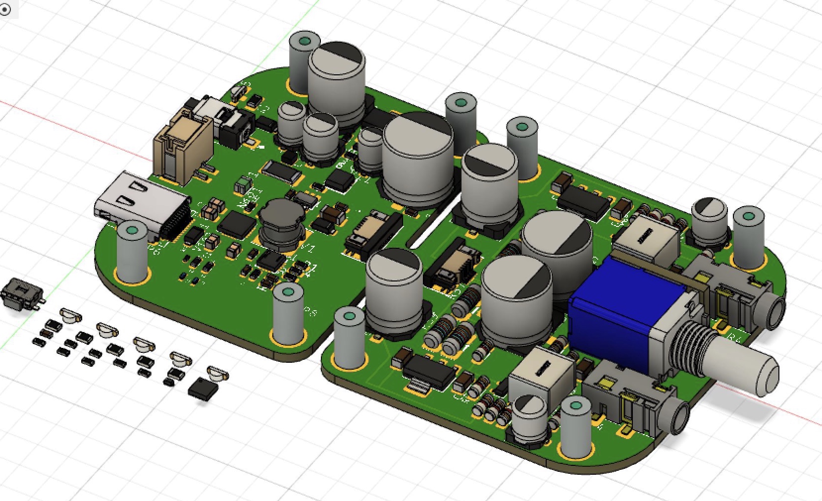

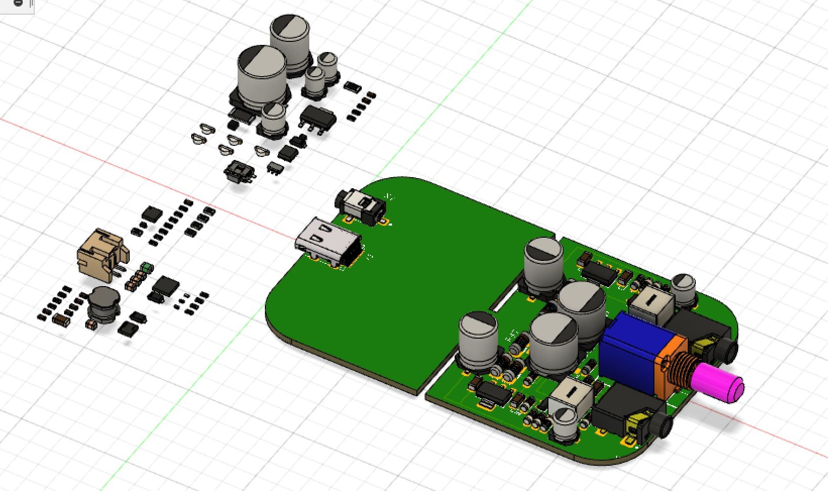

What about a Ready to Run (RTR) fully assembled PCA Mk II with integrated LiPo battery charging (via micro USB) and management system, DC-DC step up, capacitance multiplier soft start, and STL files for making your own 3d printed case? Or use same mint tin if desired.
JPS64 has been busy again...
More progress from JPS64. The amp will have a 4100mAhr LiPo battery. It will for either the 3D printed case (will provide STL file) or the traditional Altoids tin.
