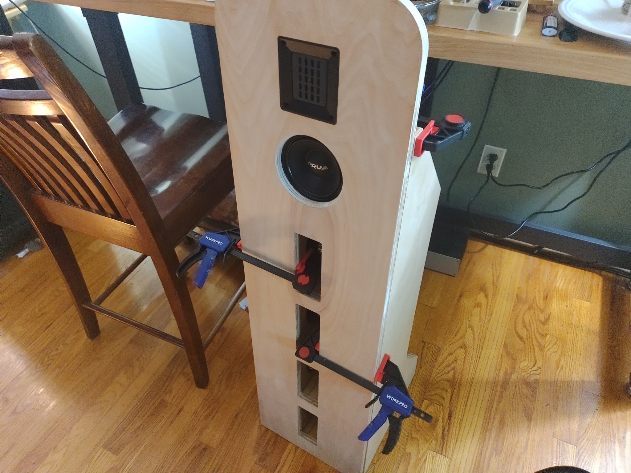

About ready to add wings, going over all the edges with filler and sanding smooth. Screws to mount the drivers should arrive from parts Express today. Looking at the woofer wiring. Don't want to mess this up!
Nice to at least have them standing up like speakers!
Back to drilling heat sinks for the XA 252. Just read about a member here using it on a pair of Theil speakers very well. They apparently go very low in resistance, 2 ohms or so, average 5.
Russellc

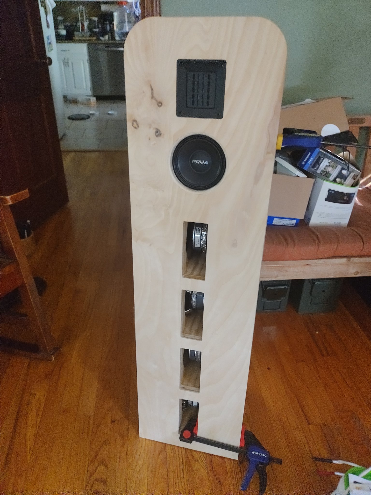

I have one speaker full of woofers, 4 in the other one. This is just drilling and driver fitting. It will all be undone, bass unit drilled for wiring, final fill and sand. First paint followed by fine sanding. This will be a satin finish not a gloss. Then the feet will be mounted.
Then reassembled. Yeah I'm not fooling myself. I will trash wire them for a listen!
I also have all the stripping in place that the wings screw into, and the wing's guide holes drilled through. Also got the tweeter mount hole drilled in faceplate.
Need to go to hardware store and get appropriate screws to match threads in wave guide. Mount tweeter in waveguide and mount that assembly on front panel. Need some nice screws to attach wings to the stripping.

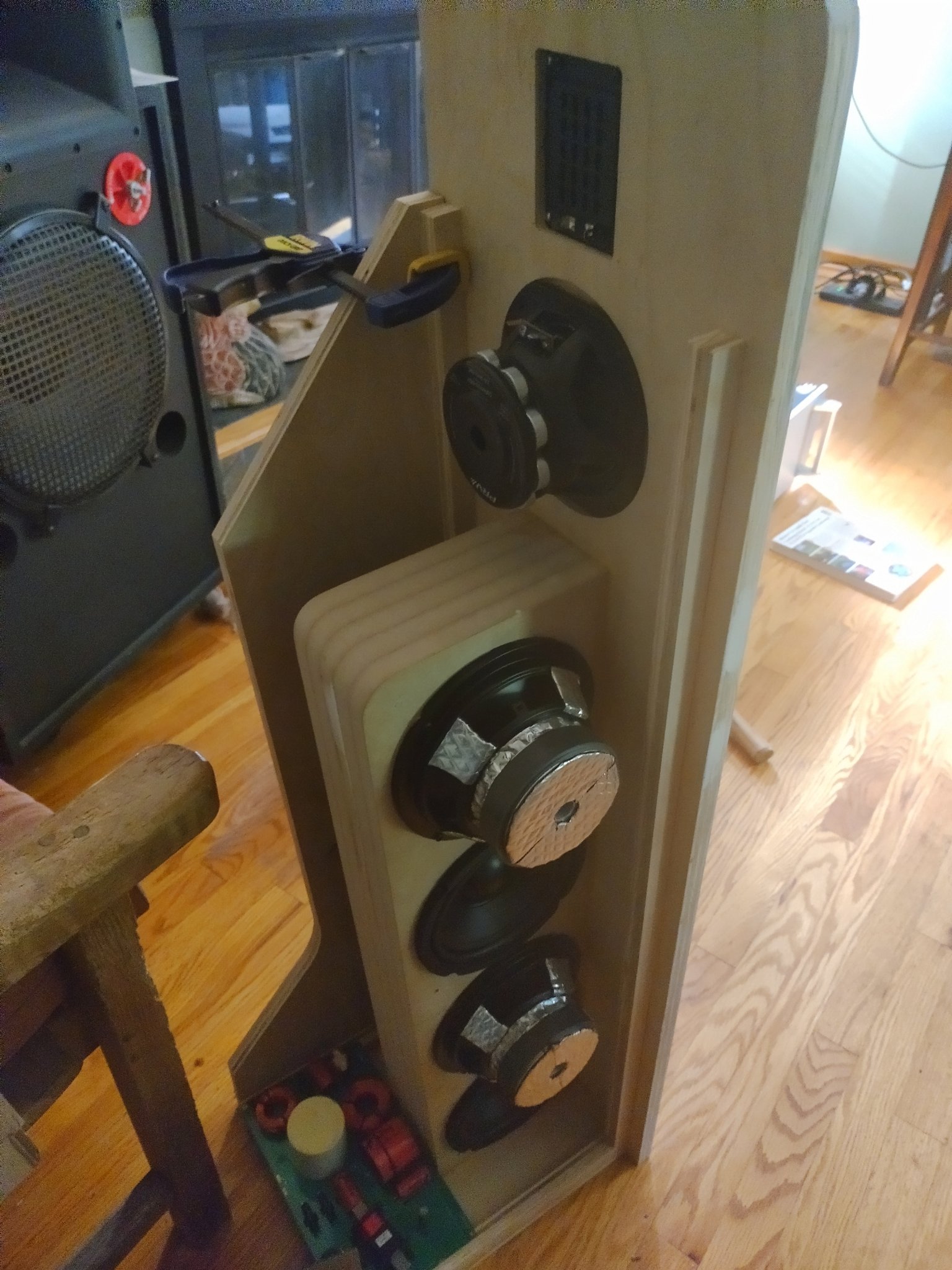

I suggest buying a couple extra woofers. Have mine all fixed with the vibration killing stuff and all installed, but I put a Phillips head screwdriver through the surround on two of them. Fortunately I had 4 extra...
.. particularly vexing after taking time to stick the anti vibration stuff to.
The other thing is the peel back gasket for the tweeter/Waveguide. The short button head screw isn't quite long enough to engage the threads. There are s few small bolts holding tweeter together that press against the pad. I cut on the gasket to give clearance, and the screws were just long enough.
Bubba
Do not use their gasket. It’s too thick and besides, bumps against all the screw heads. Just apply a thin bead of silicone RTV sealant if you wish but, really - for an open baffle application no sealant needed. More for use in a box speaker like a bass reflex or sealed to prevent air from woofer leaking through.
Oh well, they installed with cuts I made, I guess it matters not, so that's good! And a few pics:
