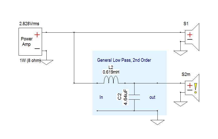

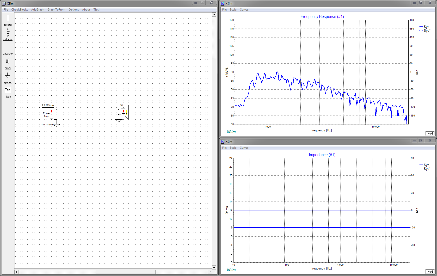

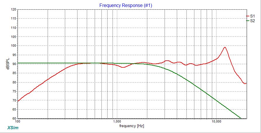

Just a quick tip to getting the slope you want in XSim. Here's how I do it.
First, I create my schema, with the actual driver (S1) and an ideal driver (S2). S1 has the FR and ZMA files imported. I then use the Circuit Blocks to select the preferred filter alignment and cut off frequency. For illustration I chose 3kHz and 0.7 Q
attachment.php
In the FR chart, I then select S1 and S2 (but not System). I adjust the "mod sensitivity" of S2 to match S1. Now you can use the green line as a reference point, while you go happily mucking about with crossover components on S1. This technique is especially useful when you must use a notch filter in addition to slope.

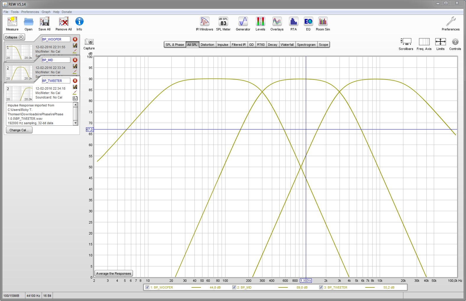

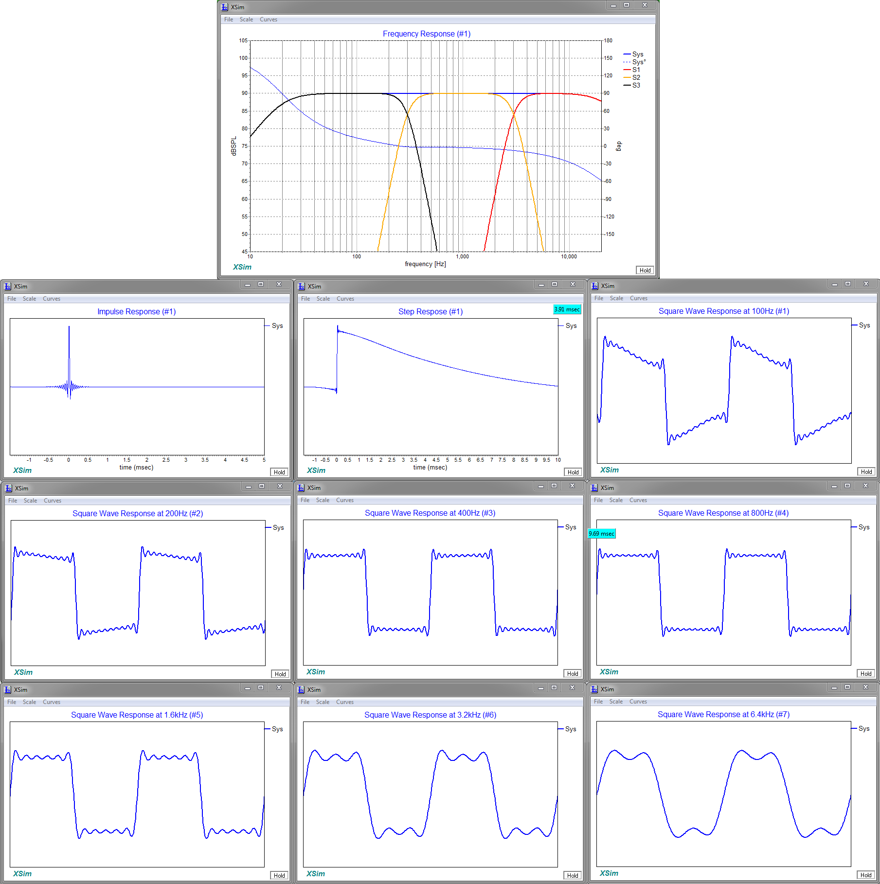

eriksquires thanks high value tips, regarding creation of target curves they can also be created in Rephase as seen in picture-3 where 3x bandpass targets is imported to 3x ideal drivers in XSim.

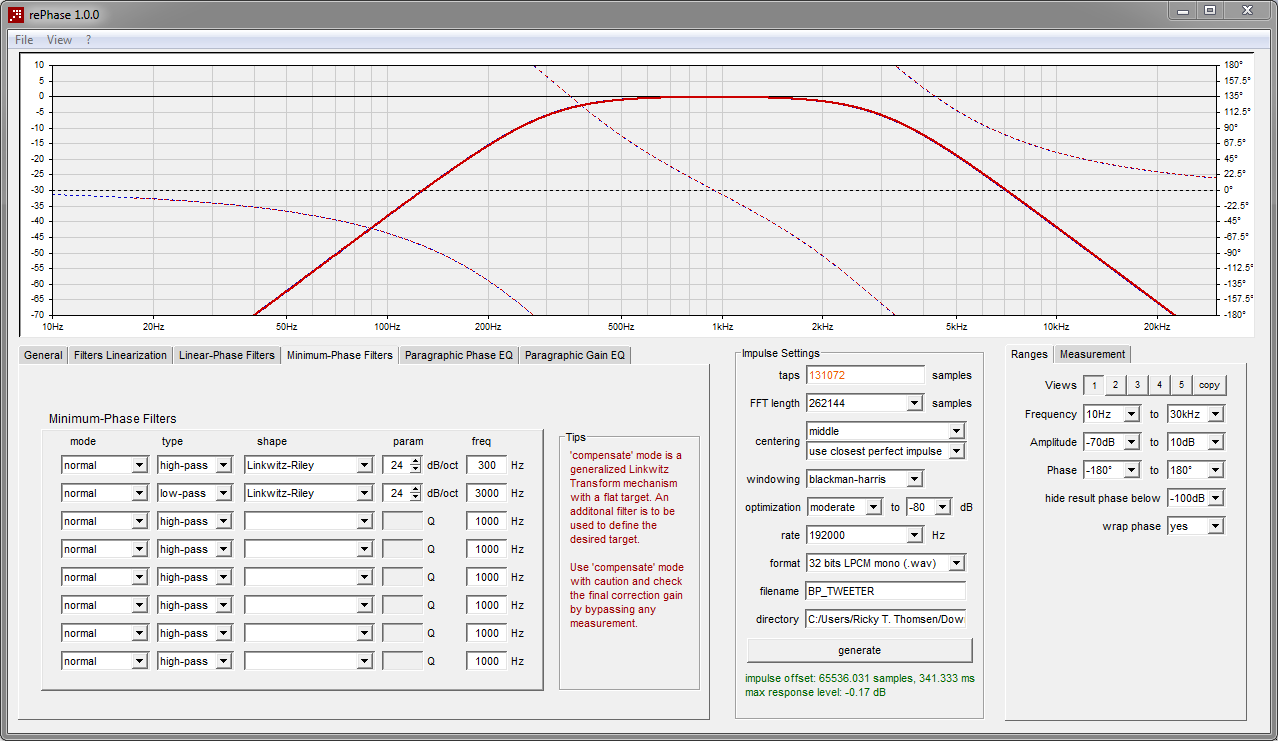

Create target slopes:
1. Midrange bandpass is created in Rephase as seen in picture-1, use some higher value "Taps" and "Samplerate" to get less interpolation of phase and frq response and generate a 32bit IR.wav file.
(Into Rephase should one look for Bessel second order use LR2 combined a PEQ at XO point frq with Q=0,58 +1,3dB which is created in the the tab named "Paragraphic Gain EQ")
2. Import IR.wav file in REW and offset SPL level to around a realistic 90dB area and zero align IR with button "Estimate IR Delay" before export "Measurement as text" and remember add extension dot-frd, picture-2 is slopes seen into REW.

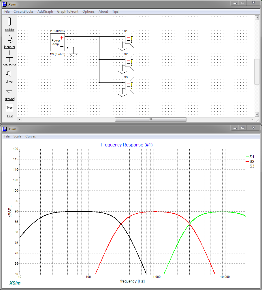

3. Link that frd-file to a ideal driver in XSim and fine tune SPL with "mod sensitivity". In picture-3 3x passband from Rephase is linked ideal drivers woofer is BW2 20Hz - LR4 300Hz, mid is LR4 300Hz - LR4 3kHz and tweeter is LR4 3kHz - BW2 22kHz.
Also in past learned from bwaslo over Trynergy thread that if we want to see square wave response from a speaker system and don't wan't to run a live sweep and the noice it makes, then export system response from a measurement program as frd-file. Link that frd-file to one ideal driver and in "Addgraph" "More" "Square Wave Response" window sweep frq up and down to see systems waveshape.

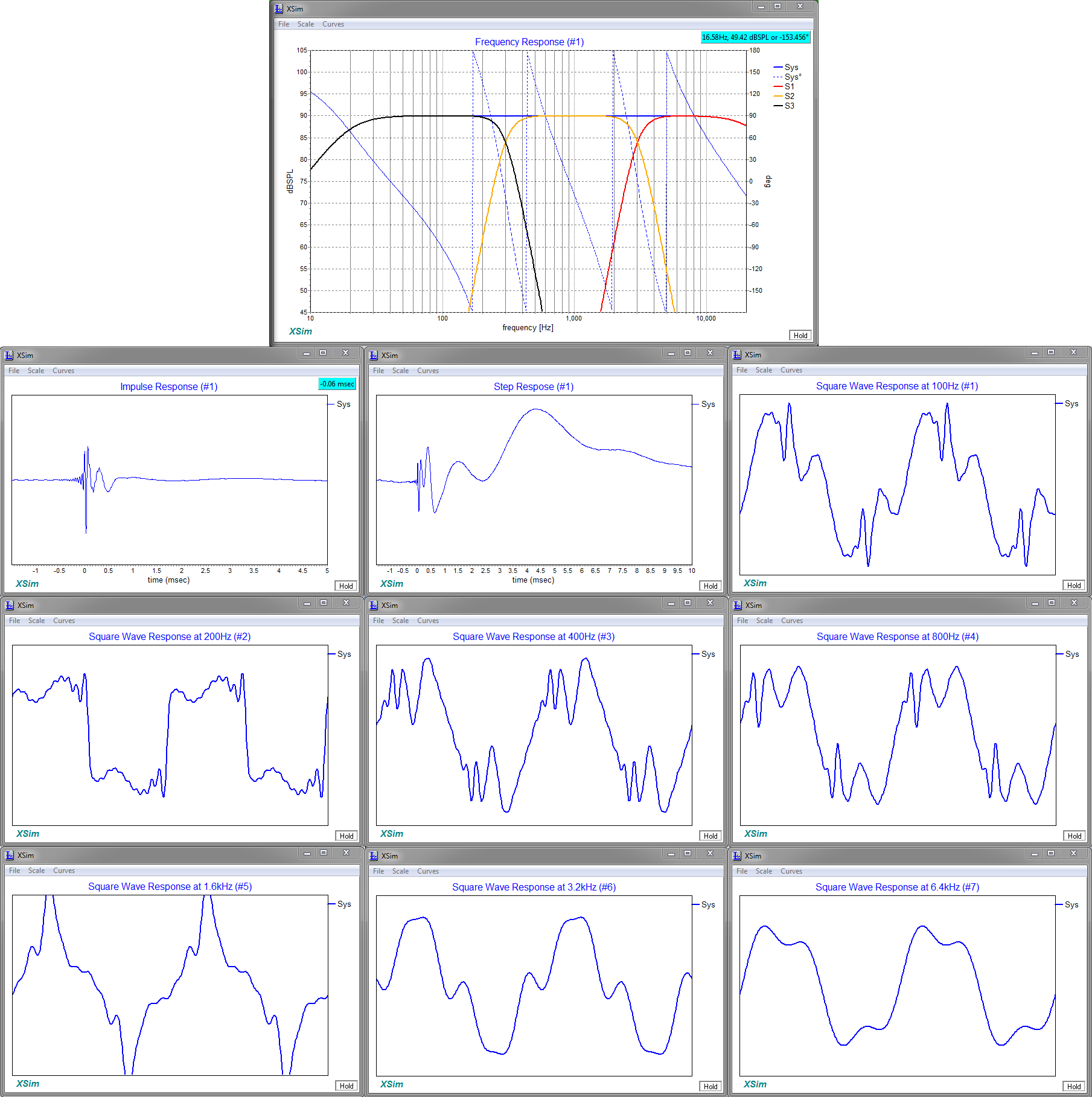

Speedtest you best 🙂
Rephase can do complicated ones.
Common for all three below they have system stop bands at BW2 20Hz - BW2 22kHz and XO is LR8.
1. All filters are IRR.
2. Stopbands are IRR and XO's are FIR.
3. All filters are FIR.
