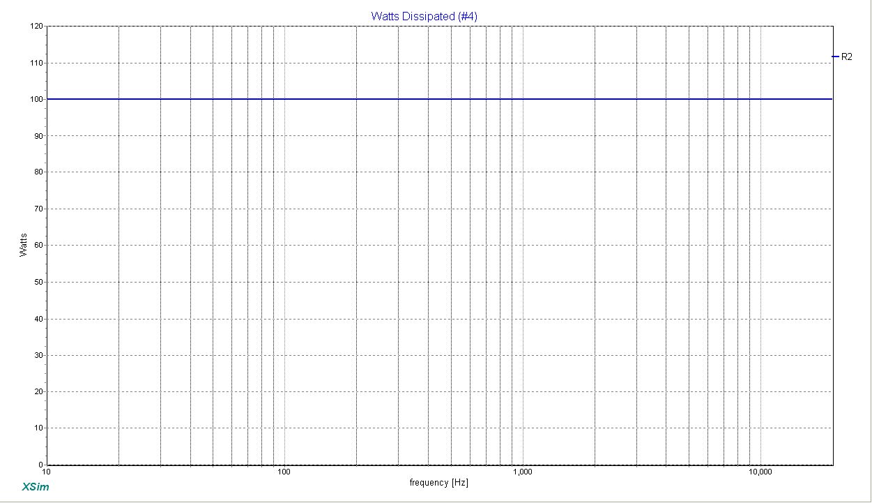

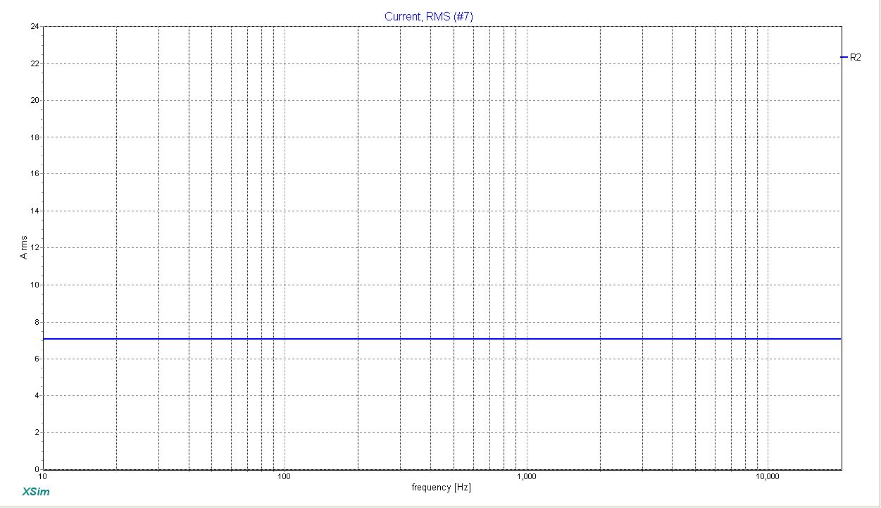

Hi Bill,
been playing around with your neat simulator.
Something is bothering me though. The circuit
shows a simple 4 ohms resistor acting as a load
to the amplifier.
Vout= E rms= 20 V rms
R1= 4 ohms
Current rms =I rms= E rms/R1
I rms=20/4= 5A rms
Power dissipated =Prms= E rms*I rms= 20*5= 100 W
Simulator shows dissipated power correctly, yet current rms
as current peak.

Oops. Looks like you're right, I'll have to fix that. Thanks for the bug reprt.

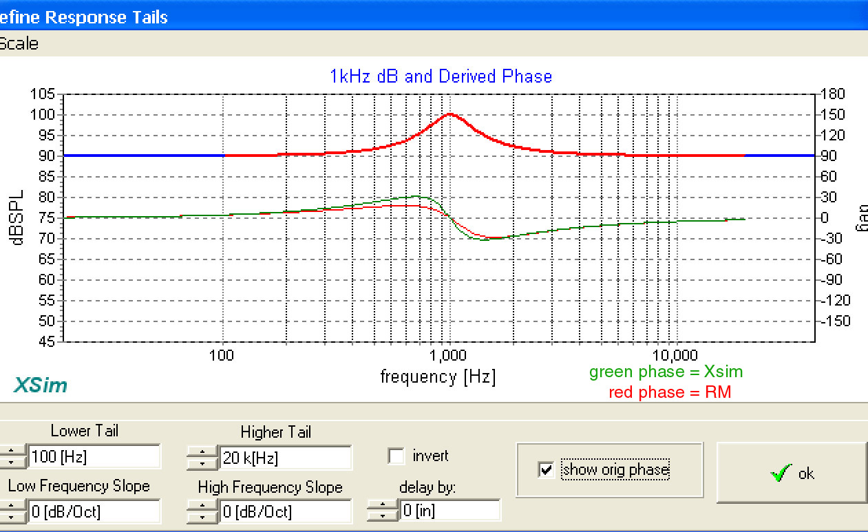

Has anyone tried the derived phase option in the driver tune window? I'm not sure if it is just my system but it does not seem to render correctly and I have trouble getting out of it. I found that if I tab through the data entry boxes and hit return, eventually I hit the one that closes the window.
I also do not think that I'm getting good phase from it, any tips for how to do this?
I tried some traced driver files without phase and the derived phase doesn't seem right.
I also cannot get out of the derived phase pop up menu without crashing.
That menu really lacks the "Close" button.
