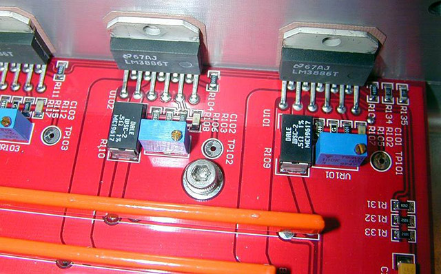

The leading P in PM35AF (Post #222) indicates that the chip is manufactured in China. National doesn't/didn't have a fab in China.
Fresh from Deep Throat (my source in TI):
ICs produced after the TI acquisition of National Semiconductor in 2011 are marked according to the TI marking standard: National Semiconductor logo followed by YMLLLPG3, where the "P" indicates the A/T (Melaka plant A), and "G3" is the level of environmental friendliness of the package. The insolated package will be the same except there will be an "E3" rather than a "G3" as its environmental friendliness level is different.
I've attached a picture of a known genuine National Semiconductor LM3886T of ~2010 vintage. Pardon the image quality. The marking is done with laser - not silk screen.
For those who wish to mince words can use "counterfeit" rather than "fake" if that makes them feel better.

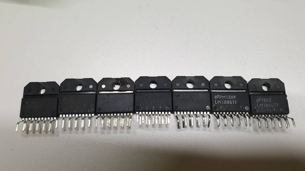

Ti does have a factory in China:
Texas Instruments News Center - News Releases
Ti does produce silk screen Lm3886:
Tomchr XY bought lm3886 kit #1 - factory number does exist:
PDF form Ti:
http://www.ti.com/lit/an/snoa039c/snoa039c.pdf
PM52AE:
P= wafer plant, China (sub-con)
M= assembly plant, Malacca, Malaysia
52 Y/W = 2015 / week 12-17
AE= The die run code is a two letter alpha code, ranging from AB through ZZ for each device

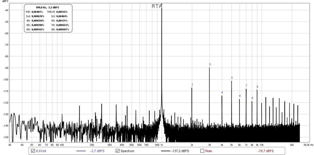

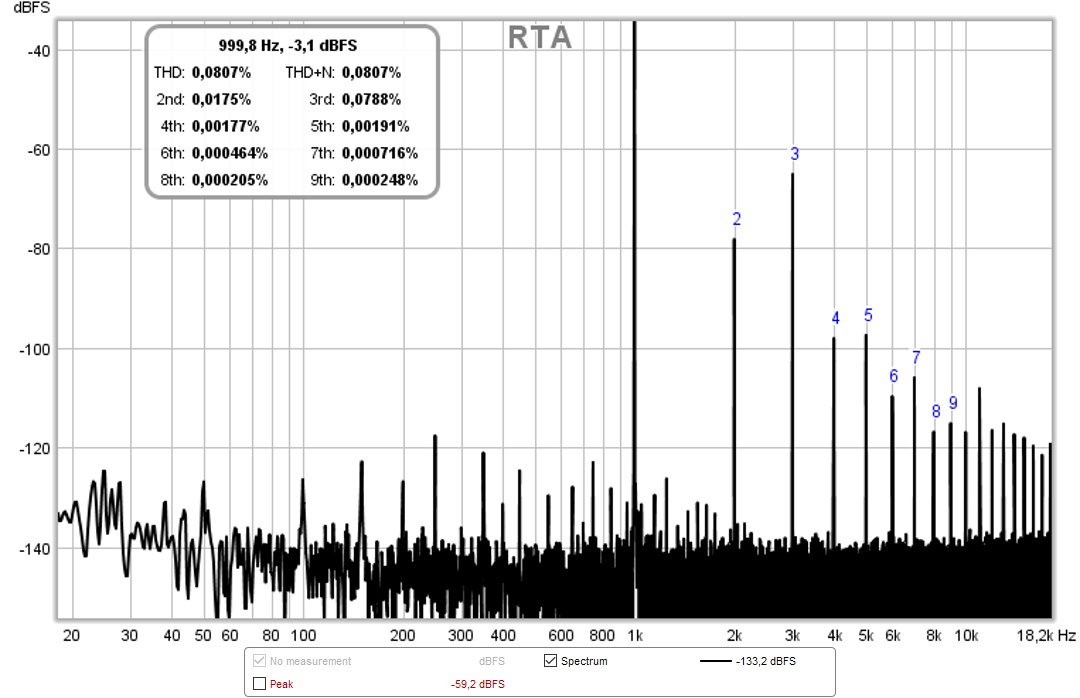

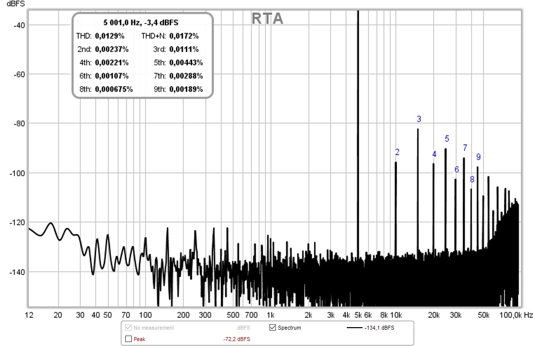

Got a new batch of xy kits.
Up and running.
Close to posted thd measurement in this post at 8 ohm at 8 volts rms. 25 volt rails.
As my heatsink is small and insufficient heatpaste I got 0.1 % distortion at 3,5 ohm, 5.7 volts rms.
So heatsink is even more important than the board.
And thermal tape is horrible with this chip
Up and running.
Not sure I'd say it's "even more important". There are just more than one way to degrade the performance of an LM3886-based amp. Inadequate heat sinking is one.
Tom
