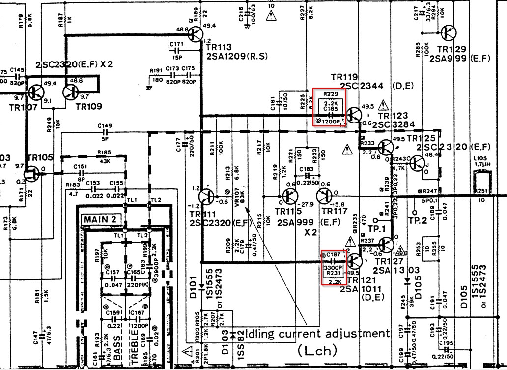

A500 - what is behind R and C in in driver's bases?
as we have Yamaha A500 repair thread it might be right place to discuss what is the reason for R229 (2.2k), C185 (1200p) and R231 (2.2k), C187 (3300p) in bases of driver transistors?
If all this is for oscillation suppression, why not single 100 ohm resistors? And perhaps 220p across BC?
And why caps values different for NPN and PNP drivers?
Strange that A500 must be simpler circuit than A700, but in A700 there is no such RC in driver's bases.
Another resemblance I saw in NAIM NAP140, but there was slightly different configuration, but again similarity to this is the different values for R in NPN and PNP driver's bases.
And again, what for all this stuff?
Thanks.
