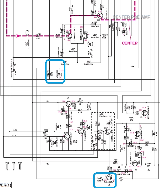

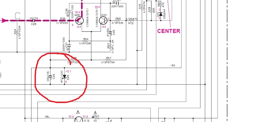

Based upon your supplied information and extrapolating (I'm assuming that there is NO DC voltage at the speaker outputs until the relays engage in DIAG mode), check the voltage across D25 on the POWER1 PCB. It should be -12V DC.

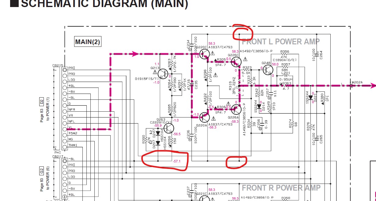

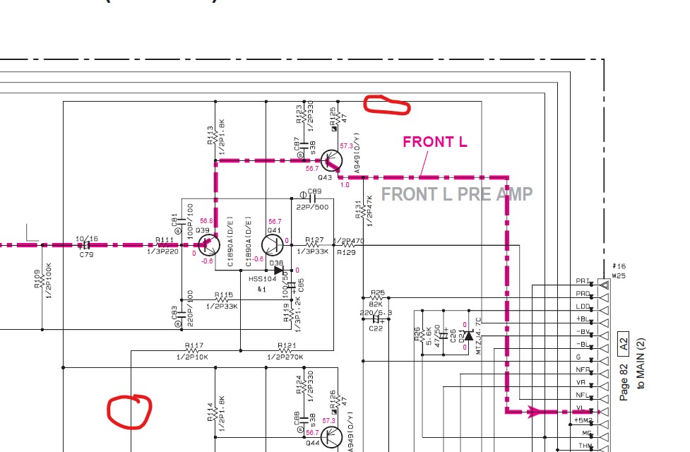

The way to fix this is to work with something definite and that (to me) has to be the fact that each power amplifier is self contained. Each is complete in itself and should have no DC on the output as long as:
1/ The supplies are correct.
2/ There isn't a fault within that part of the circuit (unlikely all of them have the same fault).
So four measurements should get you some kind of answer as to what is going on.

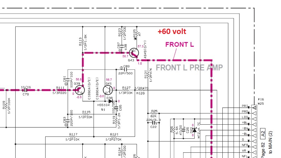

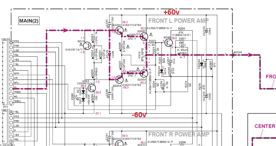

There should be +60 volts and - 60 volts present on the output transistors.
There should also be + 60 volts on the front end circuitry.

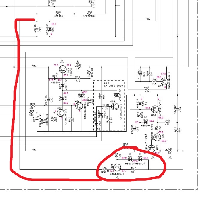

Common to all, and so first to check is this little auxiliary -12 volt rail.
If that is missing then trace the supply back to Q21 and R37 see if the -60 volts input is present there.

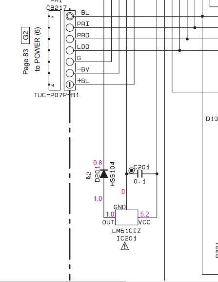

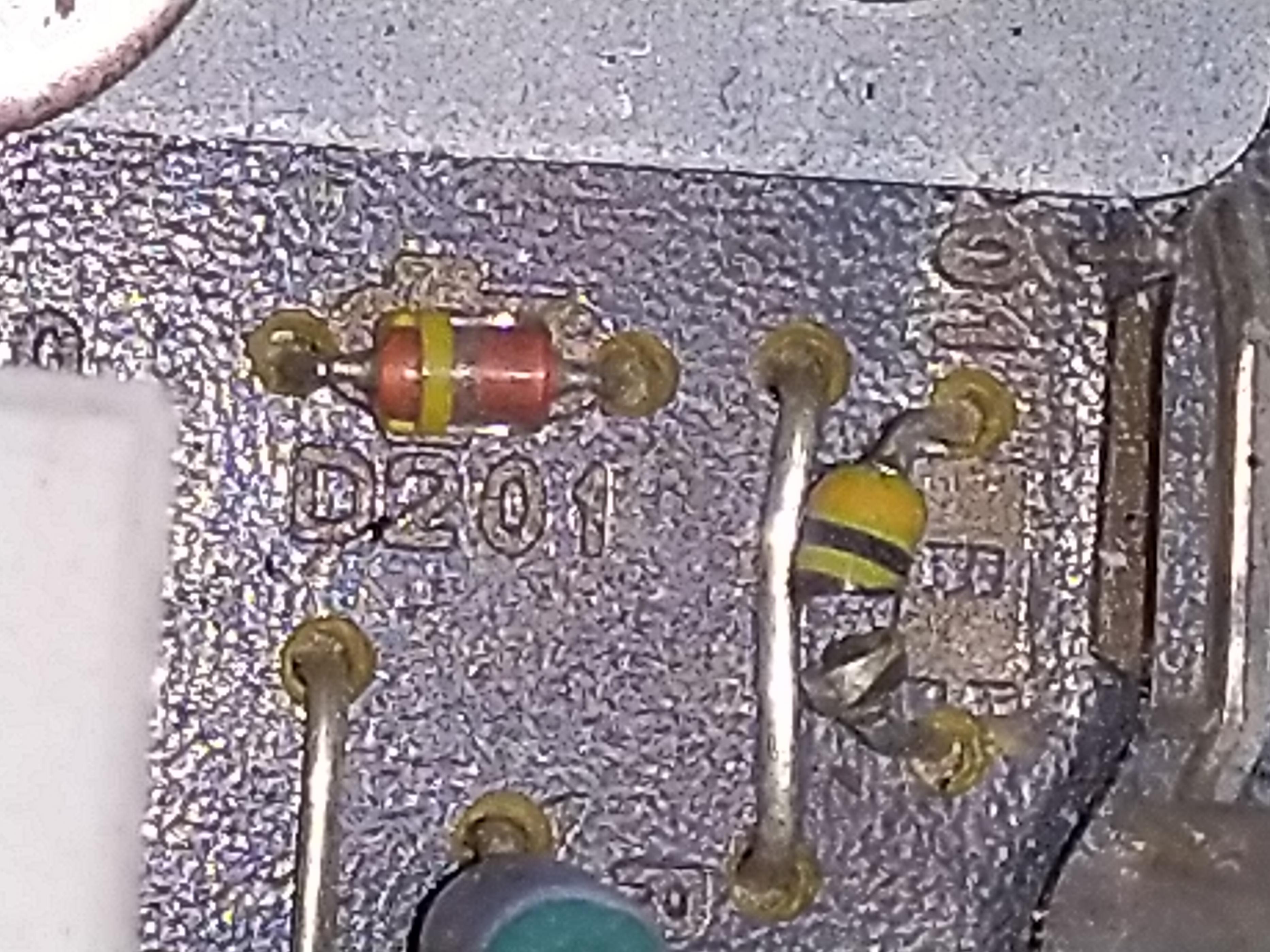

Hello Mooly, Hmmm. Look what I found while doing those measurements, I found this little resistor that I'm guessing may be slightly out of spec lol 🤪. Now I need to actually pull this entire unit apart to replace it, I know why I became an auto mechanic lol. Anyways what should I check before replacing and powering up the unit as I don't want to just blow the new part. Thanks again for helping me thru this, I probably would have given up after I took the cover off and seen how complex these amps have become if it wasn't for all the help from you and the rest of the diyaudio members. Anyways any other information or advice you can give at this point will be greatly appreciated. Thank you so much,
Mooly, it's the MAIN (2)PCB and it's the C201 resistor. You are the best, I appreciate your help more then I can ever express, thank you.
Ps. Yes it was working perfectly when I turned it off and later that day I went to turn it on and it turned itself off 3 seconds later.
C201 would be a cap and in fact the part does look like a tubular ceramic cap. The LM61CIZ is a temperature sensor IC. Unless you have cracked the resistor somehow in working on it... I would suggest its always been like that. The cap is for decoupling and it would probably work OK without it.
I wouldn't worry to much at this stage over that part... do the fault finding as I suggested. There is a fair chance that auxiliary rail I mentioned is missing.
