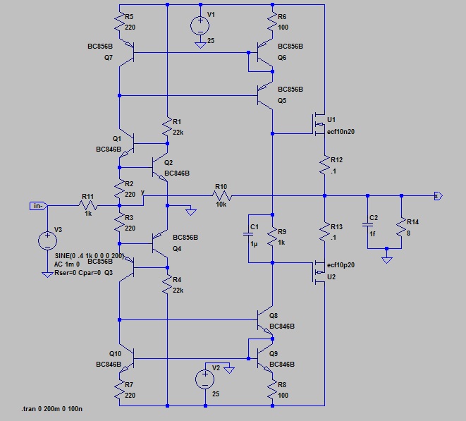

I was in the mood for modifying an old amp i made ~10 years ago.
Change R9 to set idle current - 500R -> 0.5amp.
It does not need any compensation.
It is stable into capacitive load.
The openloop gain is not that high, but the harmonics fall nicely of.
CLG is 20dB
OLG is 82dB
And the amp will be able to compete with an gainclone amp regarding size.
Bandwidth is >350KHz.

You can drive it from a jfet buffer like in this paper:
http://www.tkhifi.com/div/Erno_Borbely_fet_articel_2.pdf
Or you can choose a good cheap opamp like: LME49721M to drive. Both types have no problem with the 1K Zin.

I wouldn't drive it from complemetary JFET buffer - it sounds inferior to SE and SE can't drive it.
And if we choose an OpAmp as buffer we might as well use the LM3886 or OPA549 as amp.
So, stop offering bad solutions and change the amp so that Zin=10k or more (without added complexity)

Hi WuYit.
Juma wanted a higher input impedance. And i suggested a buffer like the One Lineup pointed at.
You can get a high input impedance, but it will be on the cost of speed and offset.
The speed is mainly because it is a CFB design where in+ is grounded.
This amp sounded good, but did lack performance into difficult load as it used BJT outputs which loaded the VAS stage heavier as load was more lowimpedant.

Sorry Sonny, there was a misunderstanding - I don't want anything. When I want something, I make it myself.
I just noticed that potentially fine amp could be sonically degraded by use of inappropriate buffers. I built and tested more than my share of amps and buffers (including those listed in Borbely's articles) and it's my opinion that slight change in your amp's topology (to achieve higher Zin) would be very beneficial. But it's your amp...

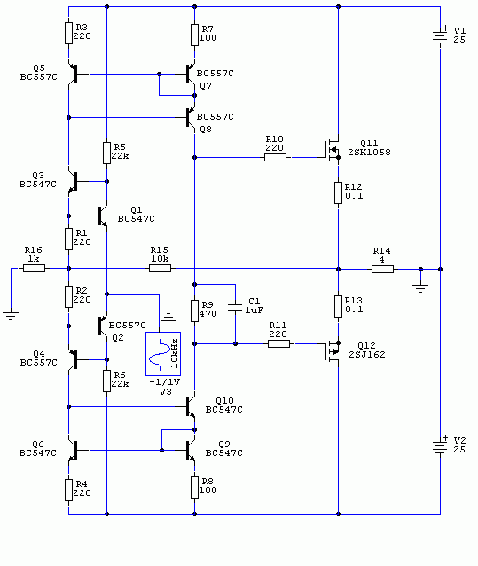

- Yet another amp - simple inverted with 10x gain, mosfet output stage
