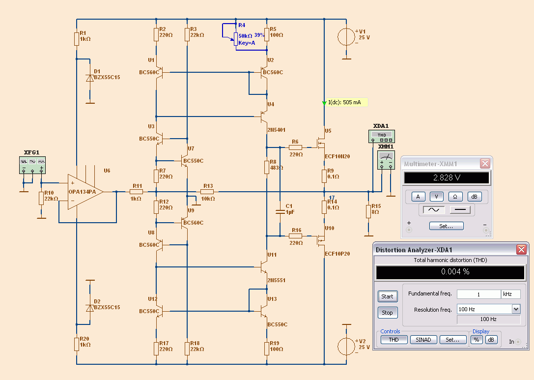

OPA134 + Sonnya Amp
I tried the JFET buffer, but got too much THD (0.037%)
So I added one OPA134 preamp at the input.
Now THD is only 0.004%.
See diagram.
To adjust DC-offset to zero I use one 50k-trimmer (R4)
I used transistors BC550C, BC560C and one 2N5401, 2N5551
