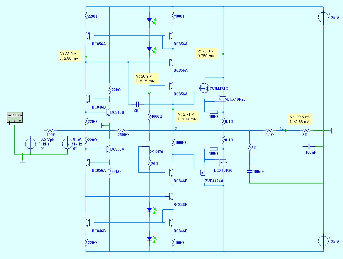

Some SPICE Play
Well Sonnya,
I hope you excuse me, but after the talk in the SSA thread about the sound of 1000V / uS, I had some fun with your very elegant design, which I really like.
I had a vision of having balanced pairs of these taking the current o/p from my Buffalo DAC . . . . but before I got into that I could just try driving into the 100R input resistor from IVY - which can drive headphones.
In real life I would begin with your design and try each mod one at a time see how each change sounded - but there is nothing that revolutionary just regular measures.
I would be interested to compare this with with my DC linked version of Motzilla
cheers
mike
p.s. would probably have regulated + & - 30V for early stages

He! It sounds Like you are going to build a powerdac?! 😀
You could easely use it directly from the dac's current output. It is a good idear to do as you have done. The buffer stage before the exicon lowers the distortion at higher frequency.
In the revised layout i am working on the last days i have added ksc3503 and ksa1381 as a bufferstage, and this at the same time gives lower distortion at lower idle current in the exicons.
I am happy to hear that you would Like to experiment with it.
If it has your interrest it Will be available within a week or two. I would Like to hear your comments too.

Your comments & circuit gave me the idea for powerdac - it's most minimalist so I like the idea.
Also reducing value of FB resistor decreased distortion very much.

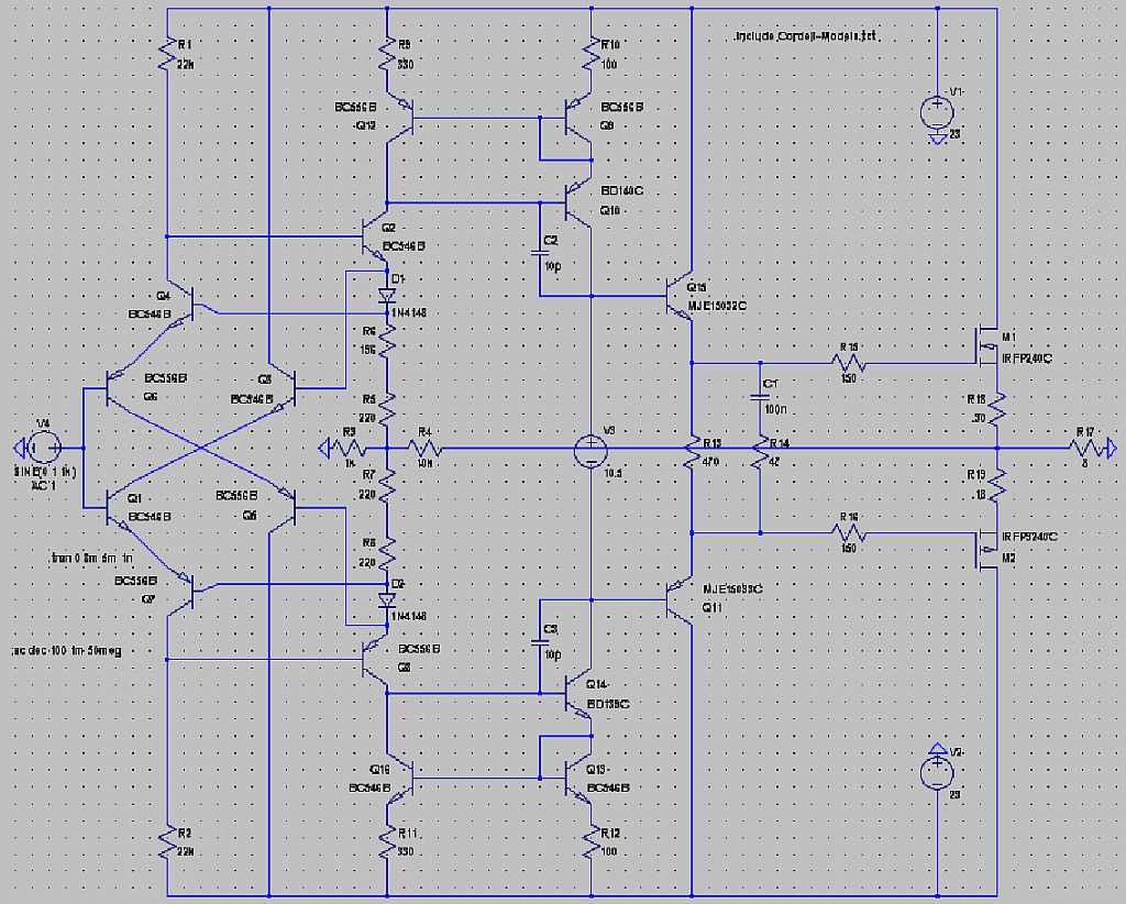

For the last version of my circuit (the last one in this thread) i got really low THD above CLASS A level, by adding a buffer stage before the mosfets. And it is 1/5 of the idle current in the mosfets.
This will be send to production next week.
So end next week i will have the PCB's up and running.
What i hope for this design is that i get really low THD of 0.006% just before clipping . But measurements will tell there story of it.

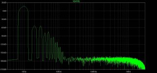

Like soOOOo. Or not?

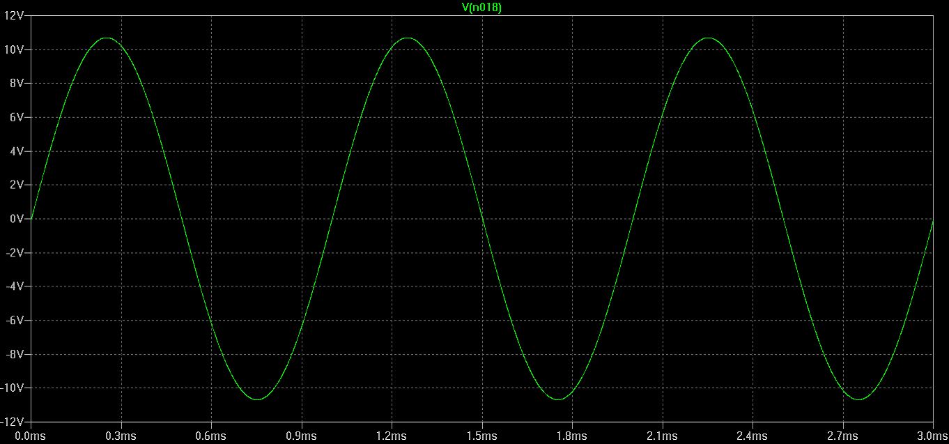

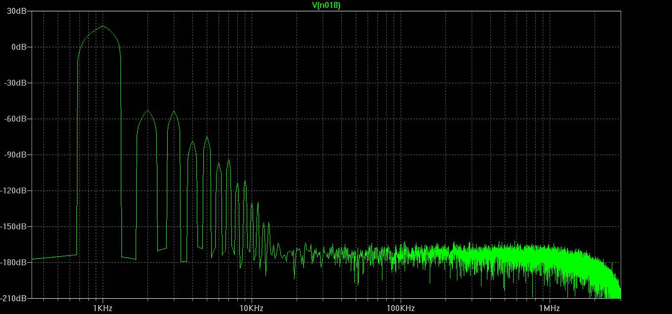

It was interesting what Kenpeter proposed, I tried this and here are the results. Not bad at all... at 180mA idle works well too...
See the difference to my version. There is 30dB less on second and third harmonic. 😎
hm, you have hf switching hiss. it is -180db down @10MHz😱
in Kenpeter's proposition there is no HF hiss from >10KHz😀
but anyway I like you project very much🙂
My design switches more aprubt than with bipolar.
My gain is 10x higher also
- Yet another amp - simple inverted with 10x gain, mosfet output stage
