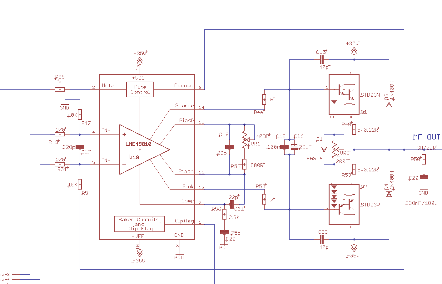

Sorry for the raining of post's... 😀 If it can be of any help, this is my final circuit that is tested with all kind of loads's and works super stable under all possible circumstances.
Note, the supply rails is relatively low, because we needed more current headroom in lower impedances. In this setup the STD3's can double output power into 4 ohm which was very important for this application. The base stoppers are zero ohm links and not used after all. Also not visible on this part of my schematic, each supply pin from as well the driver as the darlingtons are de-coupled with a 100nF ceramic SMD cap.

Bias
Dear Panson and other readers,
Since this is a solid STD03 tread, I think this stuff is also useful for other readers. I've seen many other STD03 DIY and commercial designs where the pre bias isn't right, or get measured the wrong way. This degrade the stability and thermal tracking. You can change the idle bias more forgiving, but the pre bias must be a truth fixed 2.5mA and as precise as possible.
It is hard to measure exact current, so here my way to measure and to be sure the pre bias current is 2.5mA
Who reads the data-sheet carefully knows that the diodes in the STD03N will have a forward voltage of 705mV by a forward current of 2.5mA
The diodes in the STD03P will have a forward voltage of 1540 by a forward current of 2.5mA.
So to set the pre bias on exactly 2.5mA do as follow:
1: Set the pot-meter (the one between the diode string) for the idle bias all the way to 0 ohm
2: Measure the voltage across the two bases of the STD03N/P
3: The reading should be 2.25VDC
4: Now after warming up adjust the idle bias current to 40-60mA.
It is very advisable to make the pre bias adjustable with a potential meter to avoid variations.

Bas,
The whole point of the diode stack is to apply a constant voltage between the bases. "Constant" is a relative term here as everybody knows (or should know) that the voltage across a diode depends on temperature. But as the Vbe's also vary with temperature, the "constant" voltage across the diodes set up a constant quiescent current in the output transistors.
However, the diodes aren't perfect. They have some dynamic impedance and other non-idealities that prevent them from being perfect, ideal voltage sources. As a result, the audio signal applied at the base of the output transistors will cause a little bit of AC current to flow in the diodes. Recall, that an emitter follower has a voltage gain of slightly less than unity. Thus, the voltage applied at the base is roughly equivalent to the output voltage. This is pretty big compared to the 2.5-ish volt across the diode stack. So... The current through the diode stack varies slightly (both from the diode non-idealities, and from the fact that an increasing load current on the amp output will cause higher base current to flow --> less current available for diode stack) and, hence, the bias voltage across the diode stack varies slightly as function of the input signal voltage vs time. This means the quiescent point for the output devices changes ever so slightly as the input signal changes. It should be fairly intuitive that this has the potential for causing all sorts of harmonic mixing and, thus, harmonic distortion.
The 10 uF cap from base to base (across the diode stack) makes it so that the bias voltage between the bases doesn't change significantly when audio frequencies are applied to the amp input. This does lower the THD. I measured about an order of magnitude reduction in THD with/without cap. I.e. from 0.0x % THD without cap to 0.00x % THD with the cap in place.
As far as I know the cap doesn't do anything for the overall amp stability. It may help a little with bias thermal stability, but that's really a guess. I chose to add the cap because of the 10-fold reduction in THD.

Thank you Tom for this good explanation. It makes me understand the function of the cap. Did you also experiment with different values?

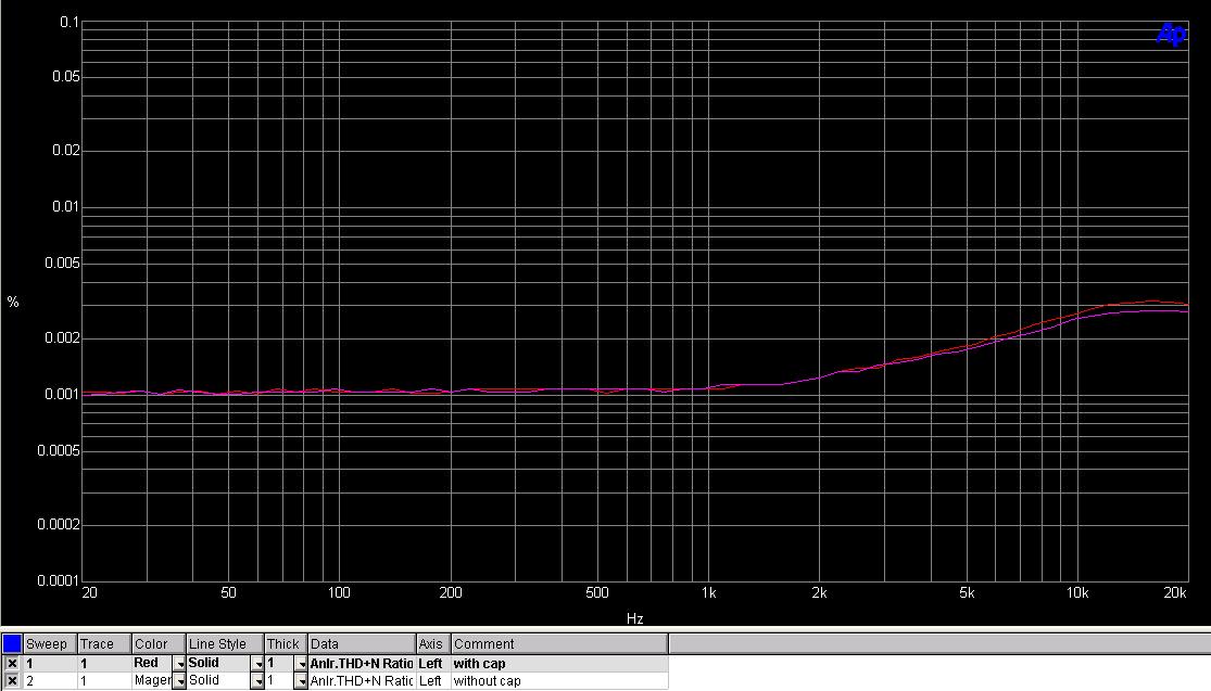

Yes, it does. I can remove all caps (cap across B pins, cap across C and B) now.Does this mean all your oscillation problems are solved now with adding the output inductor and resistor?
We should look at the voltage across the diode stack or differential voltage across base pins instead of the base to ground voltage. The differential voltage across base pins (or across the diode stack) is nearly constant. It can be verified by a DVM in AC mode measuring the base to base AC voltage. The amp input can be 1 kHz generated by a PC sound card. You won't see the level comparable to the output signal. You may see mV over there.
Dynamical resistance of a forward bias diode is less than one ohm. For instance, a 1N4148 dynamic resistance at 2.5 mA bias point is about 50 mR. The 03N/P diode dynamic resistance will be more or less the same. This tiny resistance will not cause any bias point variation during operation. Even it does. It will be negligible compared to that caused by the trim pot, thermal tracking error.
A 10 uF cap impedance is 16 Ohm at 1 kHz and 0.796 Ohm at 20 kHz. It is higher than the dynamic resistance of the diode stack.
In my test unit, I don't see any difference between using and not using a cap (470 uF || 0.1 uF) across the base pins (diode stack and trim pot included).
I did not experiment with different values, I just slapped 10 uF on there and called it good.
Bottom line is that the cap needs to make the voltage across the diode stack constant at audio frequencies. So figure it should set a pole no higher than 1~2 Hz.
The input impedance of the bipolar transistor should be on the order of (beta)*Re. With two pairs of transistors in parallel, this becomes:
8000*0.22*0.5 = 880 ohm
2 Hz cutoff: 1/(2*pi*R*C) < 2 Hz --> C(min) = 1/(2*pi*880*2) = 0.90 uF.
Note that I'm using the high-beta versions of the devices. The minimum beta is about 8000. The factor of 0.5 is because the input impedance of the two pairs in parallel is 0.5x that of just one transistor.
~Tom
Odd... I included the cap because I wanted the voltage across the diode stack to remain constant. I've also seen commercial designs (Parasound A23) that used the cap. Theory says the voltage should be constant. Good commercial guys put it there... So I put it in there. You don't like it? Take it out... Easy... 🙂 It's not mission critical.
Thanks for sharing your data, though. Data (usually) doesn't lie.
~Tom
