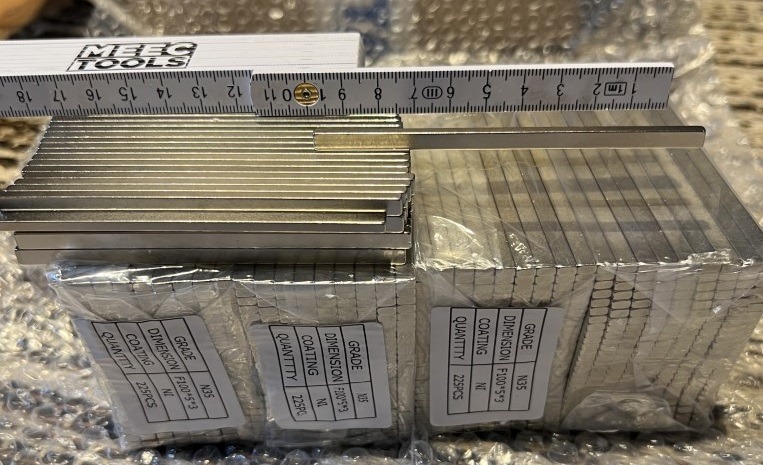

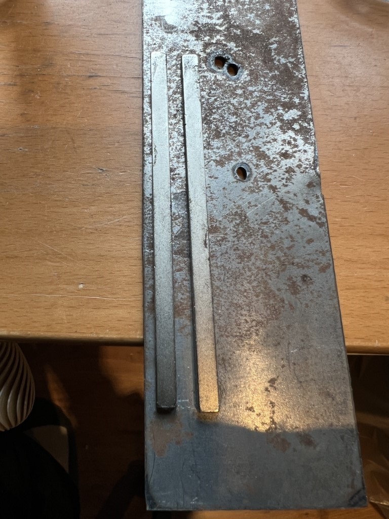

Got the magnets:

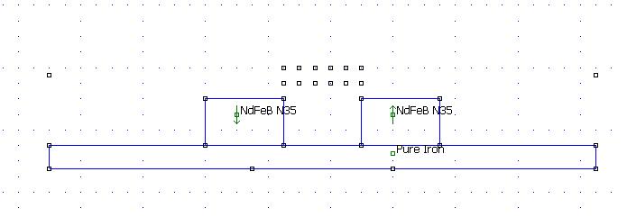

So how correct is the FEMM analyzis?
I put two magnets on a 1.5 mm steel plate:
Set it up in FEMM:

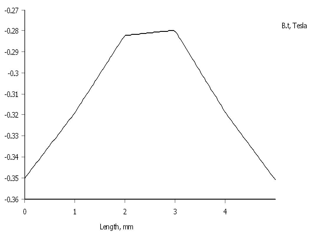

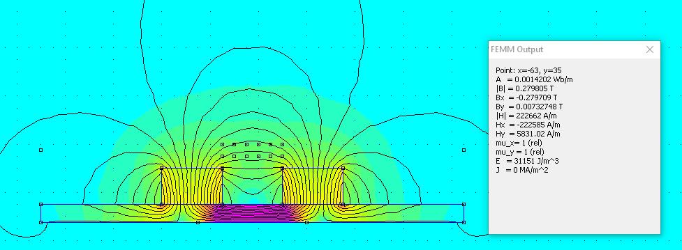

Magnetic flow density between the magnets 1 mm above the magnets:
Magnetic flow density between the magnets 2 mm above the magnets:
I then measured the reality, the Hall sensor is about 2 mm from the edge of the probe.
With a distance of 1 mm in the first parts of the video the Hall sensor is barely over the magnets.
The density shifts heavily as in the first graph above. Perhaps it has to do with that the magnets are not symmetric on the steel plate.
With a distance of 2 mm in the last part of the video, the Hall sensor is right where the membrane should be.
Compare with the second graph above.
So I'd say that the FEMM simulations can be trusted.

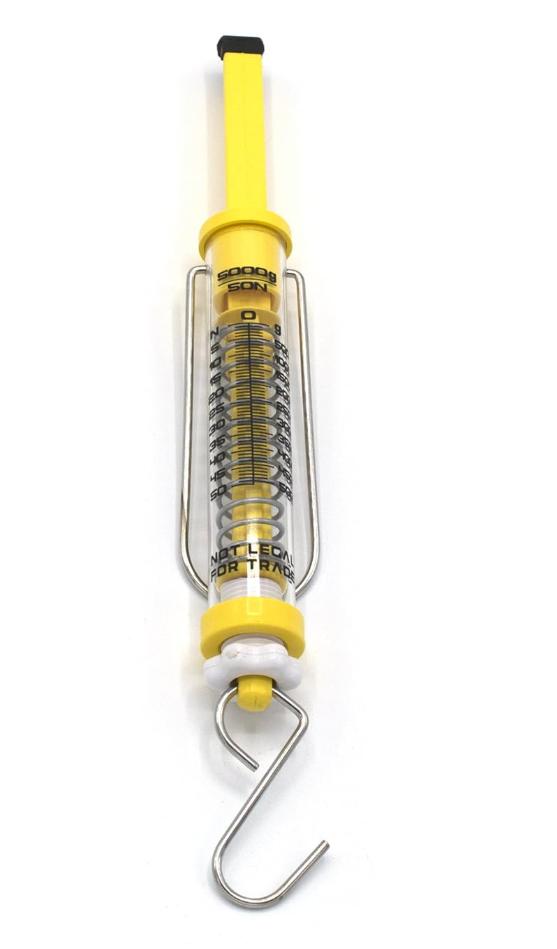

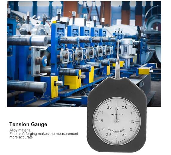

Still no idea what tension one can expect in a planar?
The black rubber foot at the top can be pressed against the membrane, so one will use it upside down.
To make the pressure area larger, an extra foot is easily design and 3D printed.
Anyone know where to buy it in Europe, not being a company?
