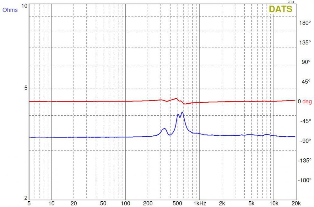

Here's a version I translated to English. I bought a pair a year or so ago and they didn't have the big 7 KHz dip. The Heil AMTs have undergone multiple design changes over the years so the dip may have been fixed.

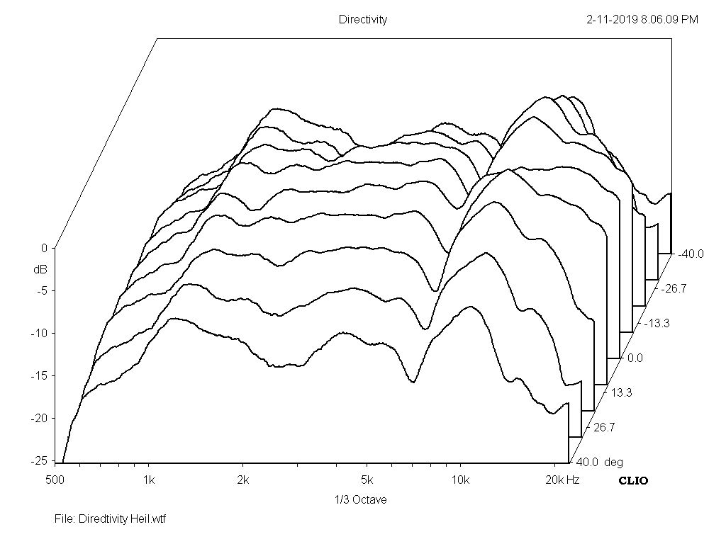

Could post the off axis curves out to 90 degrees horizontally and vertically? Actually 125$ a piece is a steal considering the current prices of the better domes.
Can't do that only looked to 40 degrees after that your pointing at the side of the driver, I will post what I measured there is another in a thread @ Lansing Heritage can't get into the site.

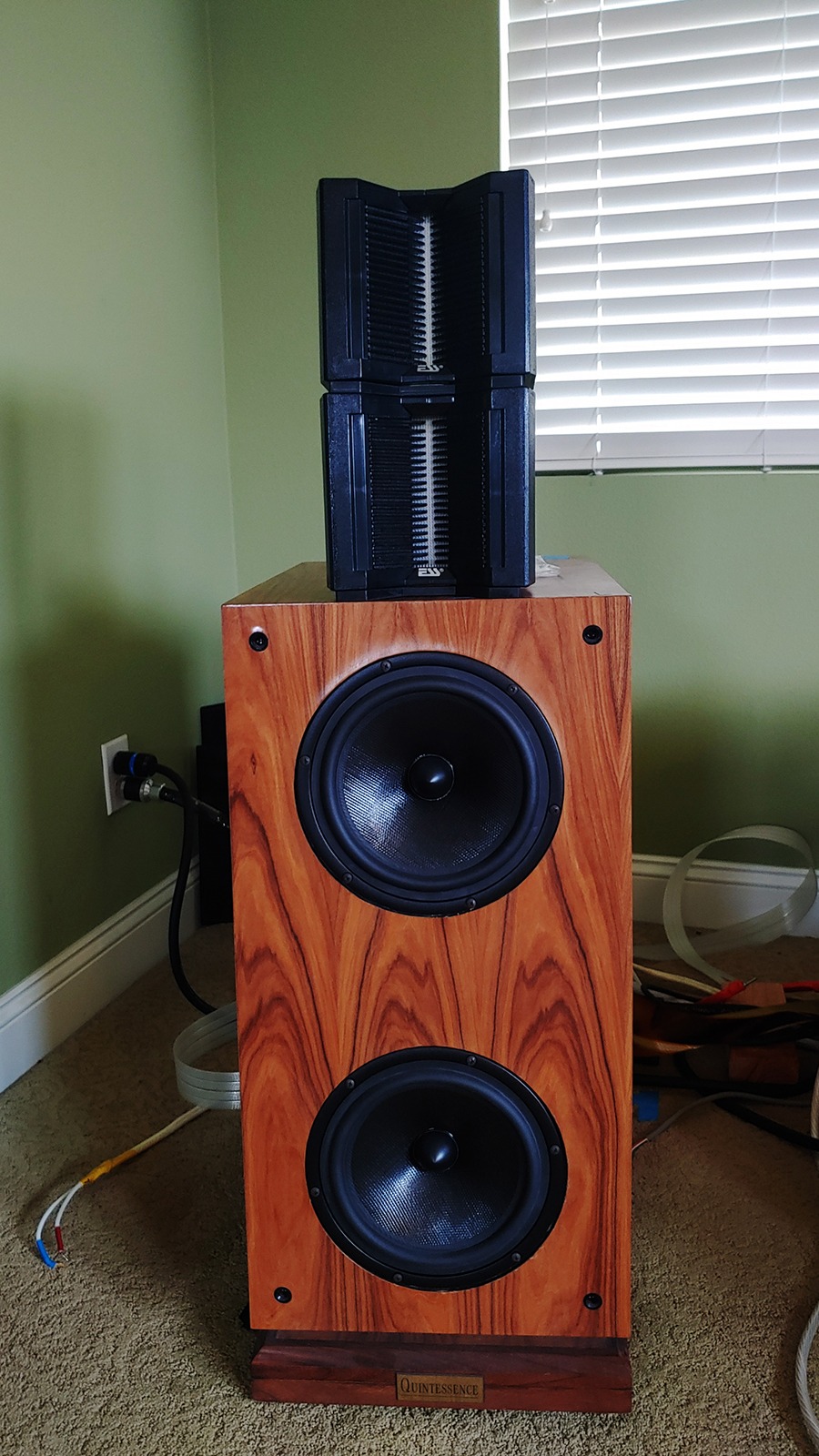

I currently run doubled AMT-1s (top AMT-1 leaned back ~15 degrees to improve vertical polar coverage) on top of Belle bass bins as surround loudspeakers in my 5.1 array (bi-amped with a miniDSP 2x4 HD). This was a very large improvement over the stock tweeter and midrange horns/drivers in the Belles--even compared to when I was tri-amping the Belle drivers and correcting the time misalignments and the non-flat SPL response.

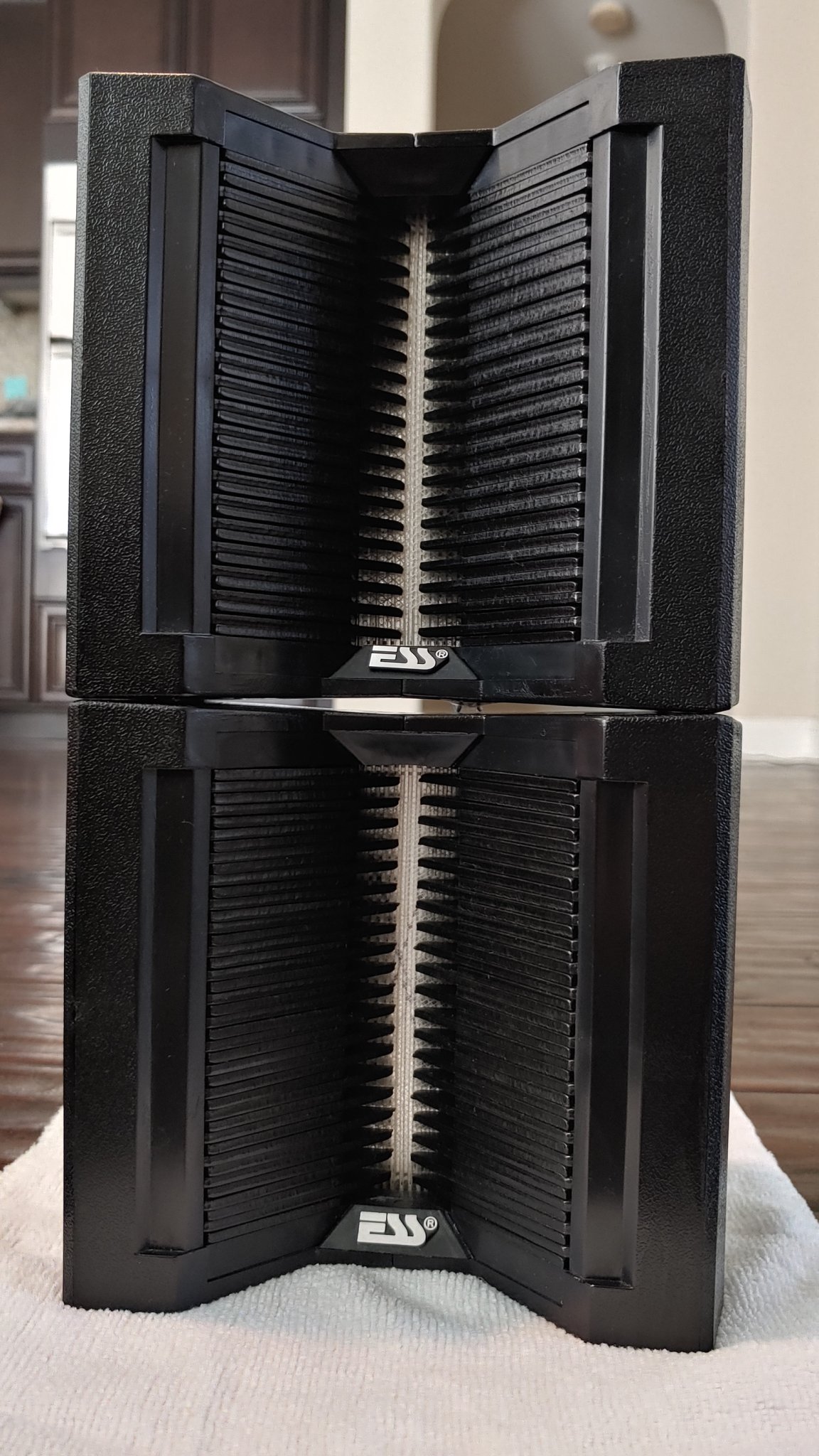

When you stack the AMT-1 with both AMT's in "stock" configuration (ESS label on bottom), there seems to be some magnetic repulsion between the two. Is this how you are supposed to stack them or perhaps flip one upside down?
And can I assume the Purple wire is "+" and light blue wire "-"?
Finally, is it recommended to wire them in parallel or series? I presume series is better since AMT-1 already has low impedance.
Thanks.
I didn't notice any magnetic repulsion issues. Yes, I stacked them like you show. I suppose you could invert one of them if it bothered you. There's a lot of steel in one of these units (i.e., someone said 14.5 lbs), so the magnetic field around the diaphragm is not materially affected by what's occurring outside of the driver's external envelope.there seems to be some magnetic repulsion between the two.
I would check the polarity of the leads/wire insulation color via REW measurement of phase/SPL.
Since they are 3.2 Ohms minimum impedance, I wired in series. I don't know many amplifiers that could stably drive a 1.1 Ohm minimum impedance if you tried to wire in parallel.
Finally, I stacked them at a 15 degree angle using a bit of neoprene material I had on hand as a wedge spacer. This configuration works very well to spread out the narrow vertical polars.

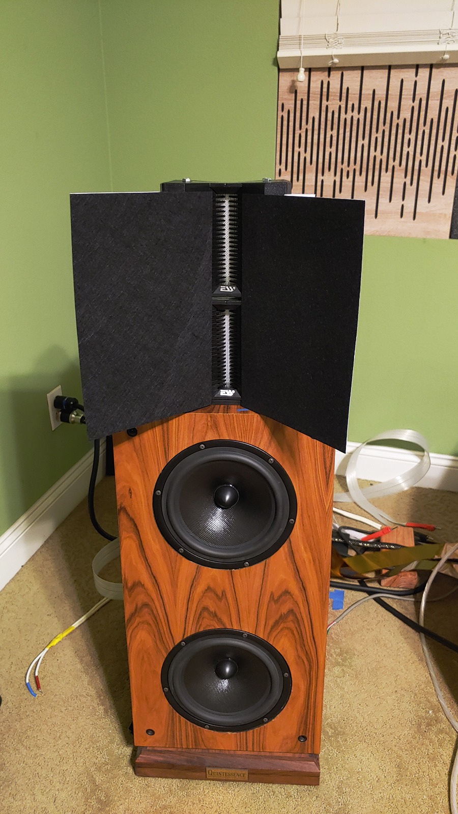

I already have the velours. Trying to see if I want to try adding wings before or after velour so velour covers the wing too...
I tried damping the backwave in monopole, but I prefer the dipole sound. I do have pretty good mix of diffusors and absorbers in this room already..

Drawing inspiration from other people making Wings for Heil AMT's:
https://community.klipsch.com/index...with-wings-possible-kit-for-heritage/page/22/
Some of the wooden wing designs seem like a lot of work, and I don't see why the wing material needs to be wood. Looking at some easier-to-make alternatives, but for now I stuck the velour sheets in sort of a wing configuration to see how sound changes. It changes a lot but not sure I like the direction it's going, e.g. fuller lower ranges of vocals but less sparkle and air..
