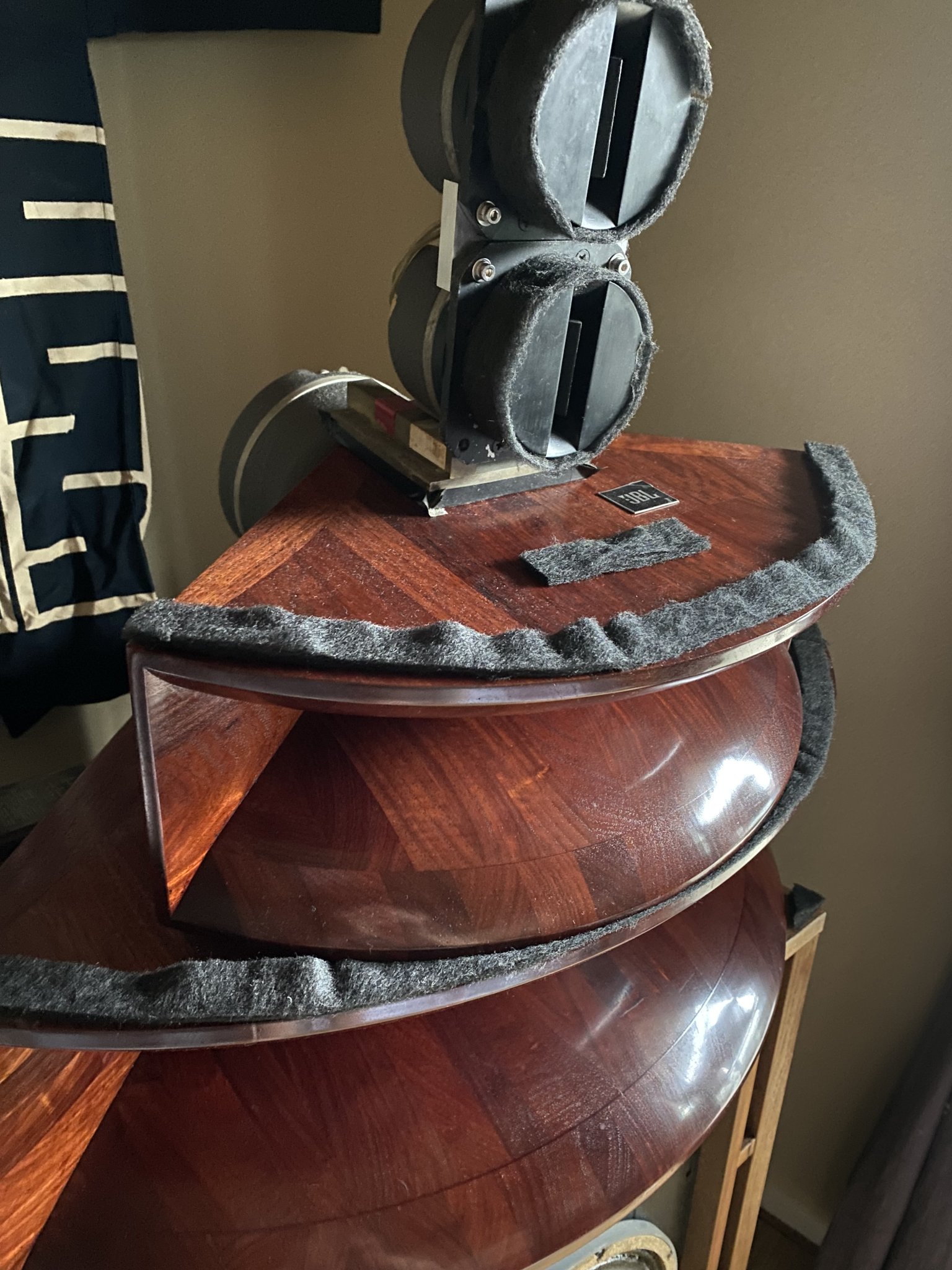

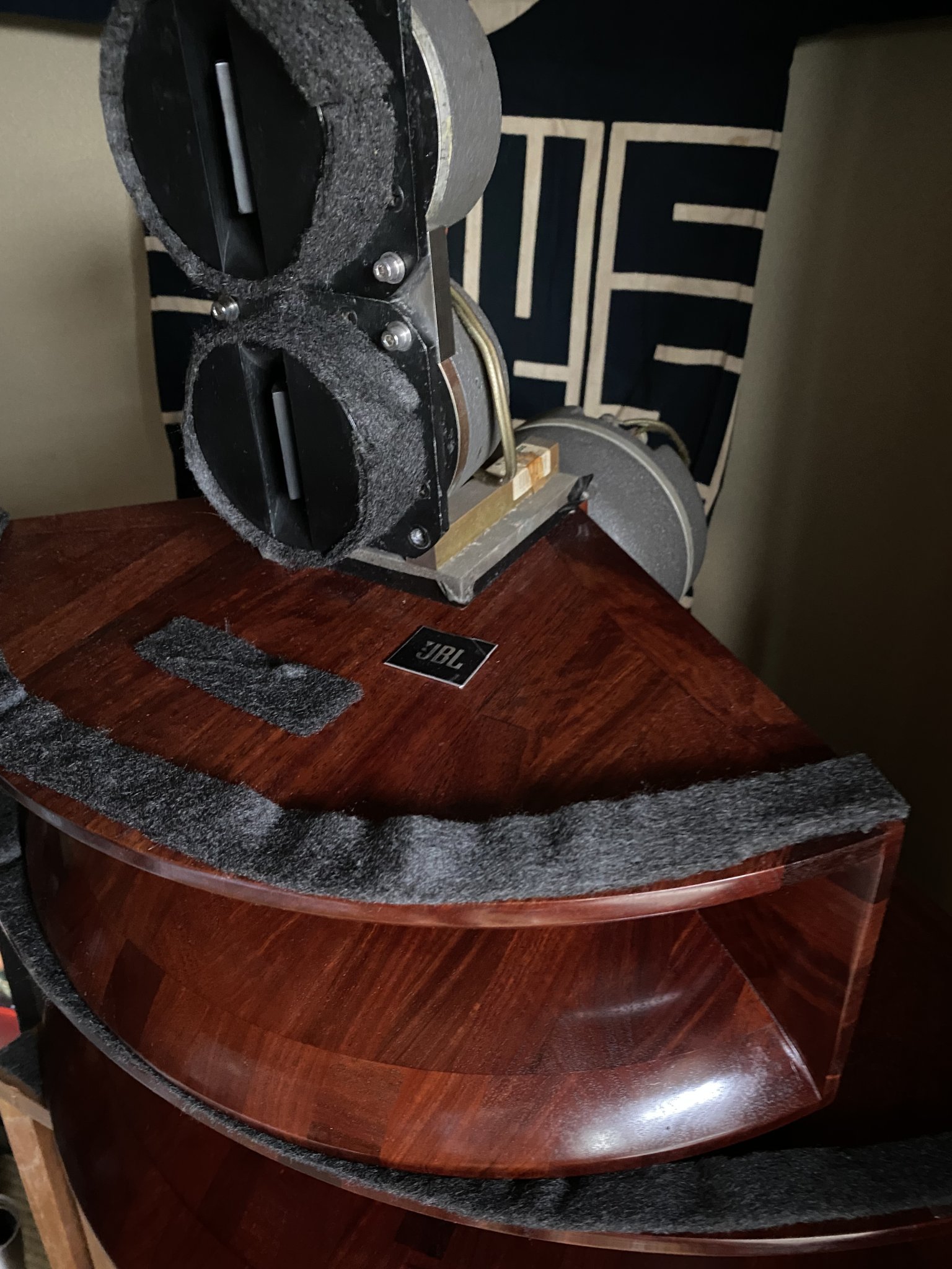

Can you describe how the sound improves with applying carbon felt over, and around the edges of your Yuichi a290....you indicated that theThe answer I was able to come up with after discussing it with a friend of mine who also uses the A-290 was similar to Mr. kevinkr's. I think they are surprisingly similar.
Diffraction occurs at the opening of the horn, making the sound cloudy.
In my case, I dealt with the problem in the same way as Mr. kevinkr with the following two points.
1. I made a 4-way crossover with mid-high at approximately 2KHz. The sound of 5KHz is not emitted from the A-290.
2. Affix carbon felt to areas where sound absorption is likely to occur.
Acoustic improvements were more effective at the edges of the horn opening.
Unfortunately, the appearance of the belt-shaped carbon felt attached is not fashionable. It is necessary to consider measures to improve the appearance, but I think it is highly probable that it will remain as it is because the effect is dramatic.

I wish I could explain in detail, but unfortunately I don't have the English ability to express the details.Can you describe how the sound improves with applying carbon felt over, and around the edges of your Yuichi a290....you indicated that the

The comparison work with and without carbon felt was easy to understand among the setting changes. Comparisons were easily made by simply pasting and peeling. However, I remember that there was no significant difference in the graph that measured the frequency characteristics. It is also a pity that the graph data cannot be presented.
I would be lucky if I could quickly find an image of the A-290 from that time. If you can't find the image, Currently, the speaker system is on hiatus due to plans to replace the amplifier. I think I'll try to remember those days and install it again.
In any case, after tomorrow... I'll need some time.

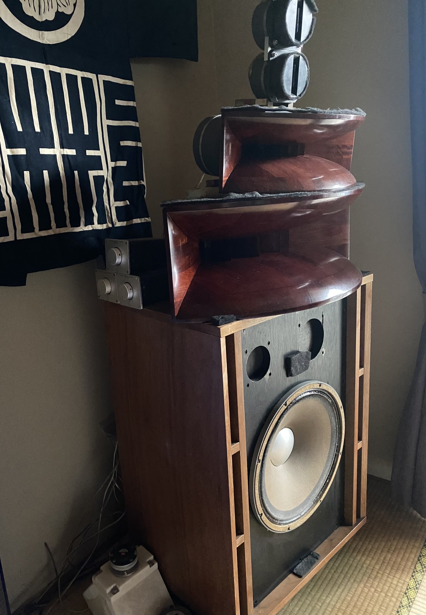

I remembered those days and reinstalled the speaker system. The enclosure is given an elevation angle with respect to the floor so that the axial center of the woofer unit faces each ear. Each horn is also angled towards the ear. The time alignment is adjusted by the Mini Shark, and the signal is supplied from the amplifier to each horn after being adjusted by a Luxman transformer attenuator.PS: Can you post a few pictures of what it looks like?

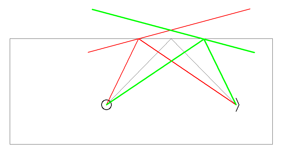

Please excuse if somewhat off topic, but would such reflections be a good deal less problematic with the smaller TN4001 horn-and further less problematic with a higher (triangular peaking at 11 ft) ceiling?I was always under the impression the Yuichi A290 was a biradial design, which in some ways helps in keeping coloration to a minimum while loading the driver down past 300 hz. There is a jump (flip) in vertical directivity around 1000 Hz. This isn't an issue most of the time, but it can make the ceiling and floor reflectons add up to a shouty kind of FR balance.
Smaller can mean it lets go at lower frequencies. On the other hand it might be OK if your waveguide is designed to be wide. In any case, you need size to go narrow.with the smaller
Consider this when assessing your ceiling. I've illustrated below that a ceiling that slopes upward going back (green) will allow you to go wider before needing to treat your ceiling.
Its not necessarily a problem, just an observation of character in the vertical plane off axis. A high ceiling is much better in a few ways for integrating wide HF dispersion drivers, depending on how the room is treated.Please excuse if somewhat off topic, but would such reflections be a good deal less problematic with the smaller TN4001 horn-and further less problematic with a higher (triangular peaking at 11 ft) ceiling?
