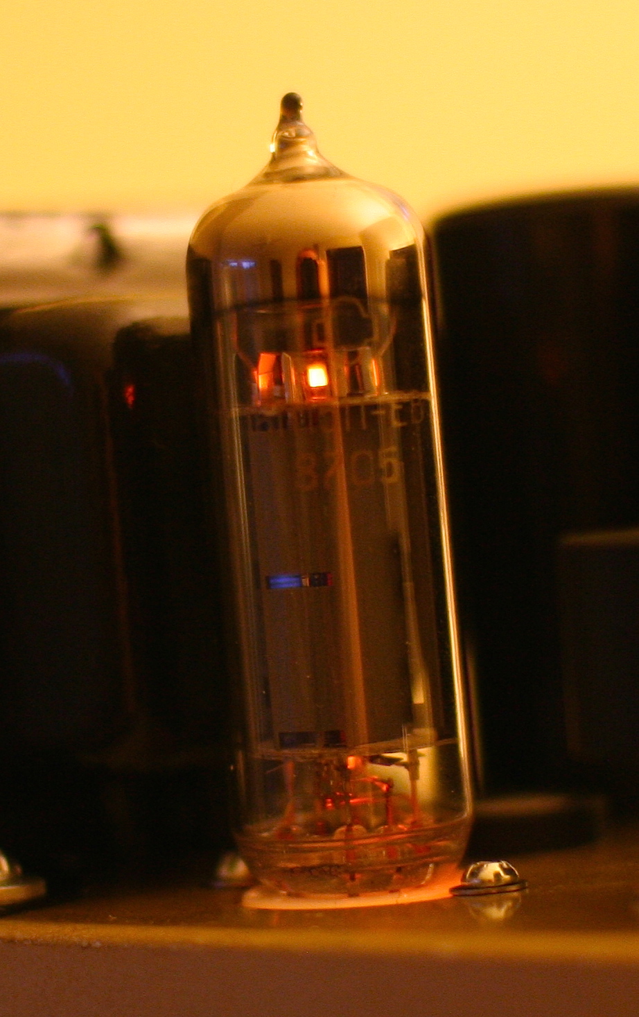

Grid casts blue glow on inside of plate
This is pretty cool !
Look through the small window in the plate structure and you'll see some blue lines on the inside surface
[ it is apparently, not an issue Blue Glow in Electron tubes ]

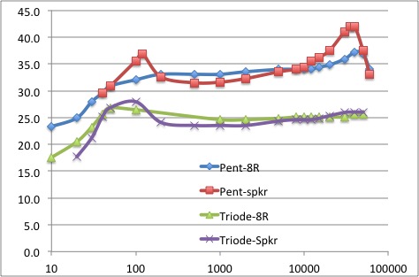

I also hooked up the ole signal generator to play some sine waves and makes some measurements of the amplifier gain/frequency response with both an 8R resistive load and a single full range speaker ( http://www.diyaudio.com/forums/full-range/280669-improving-chn-70-a.html ) I wore my Bose sound cancelling headphones for this part !!!!.
The FR plot shows the frequency response at the anode in Pentode and Triode mode with the two different output load conditions. The speaker produces a tell-tale hump in the base region around 100Hz to 120Hz (hmmm, box is tuned a little high maybe ?). The overall gain with plate-to-screen feedback (Triode mode) is clearly lower as expected. The benefits of this feedback also show up as a flatter frequency response.
However, the pentode mode with it's higher output impedance shows a rising gain with frequency along with some resonance peaking in the treble at 35kHz. The horizontal scale on both charts is frequency in Hz (log scale). The vertical scale on the first chart is gain (dB) at the anode; the vertical scale on the second chart is gain (dB) of the OPT - since it is a step-down transformer the gain is less than unity.
At 10Hz I could easily see the cathode bias LED brightness flicker - a sign that the dynamic resistance of these LEDs is greater than zero at these low frequencies. Do I care ?

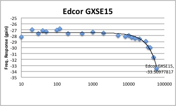

I was able to measure the signal at the anode and the output of the OPT and use it to get an FR plot of the Edor transformer. It looks pretty decent indeed. There is a resonance in the OPT at around 68kHz and the waveform gets distorted at the extremes of frequency - outside the range of interest.

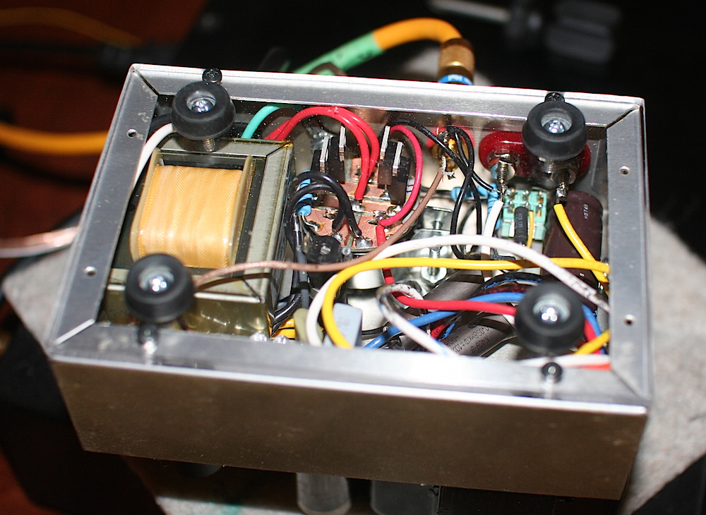

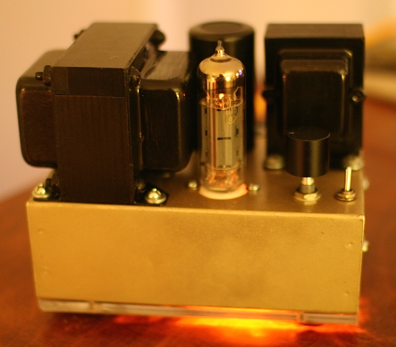

Joined 2009

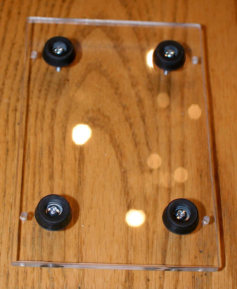

I decided to fashion a cover plate for the bottom of the amplifier using thick perspex/acrylic. I get to look at the birds nest inside and the cathode bias LEDs light up the table-top as a convenient 'power on' indicator 🙂

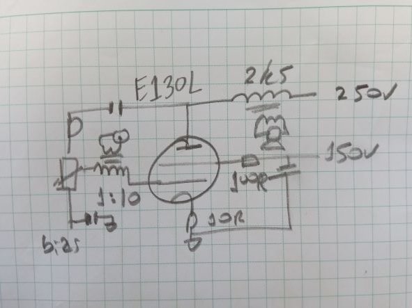

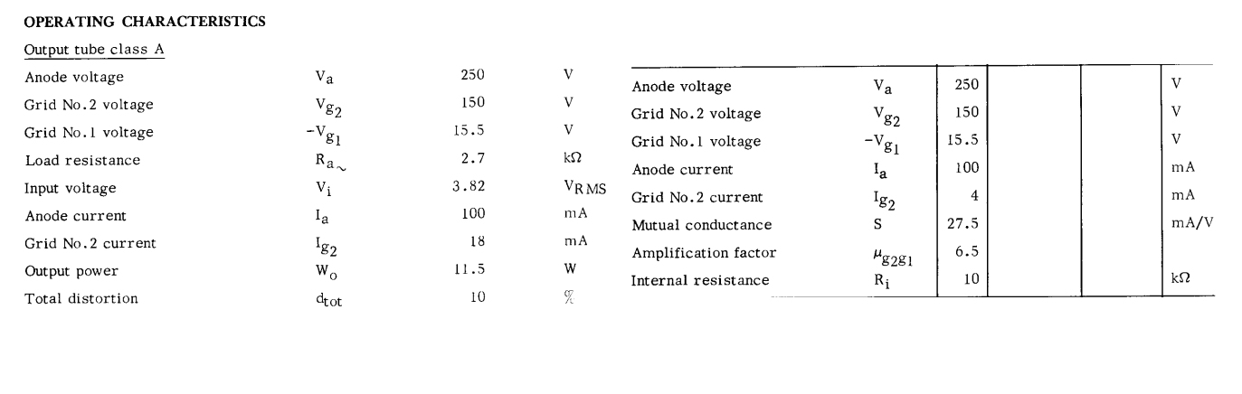

Last week I got two E130L as a gift, and couldn't resist prototyping a SPUD with them. I used the datasheet values (see attachment) for the operation points. At the input I used a Hammond 107X (reversed this gives a step-up of 1:10) with Schade Feedback applied. I was indeed getting about 10W out, but with a lot of distortion. I then dialed the feedback so that I could still get about 5W out with 1.3VRMS in (which is what my DAC puts out). At this setting the THD at 1W (1khz) was about 0.6% - not that bad.
At higher frequencies the THD was raising. I also did a STEPS (from Arta). At LF distortion was terrible, as could be expected with the little Hammond, but from about 120Hz onwards it stabilized at about the 0.6% at 1W, going to about 1% THD at 10kHz.
The step-up would probably not work with triodes and SS because of the capacitances, but with pentode I had some hope 🙂
Edit: for the feedback string I used a 2.2uF cap, 220k resistor and 100k pot (to easily adjust the FB ratio).
I have some other priorities now, but I could see this working nicely.

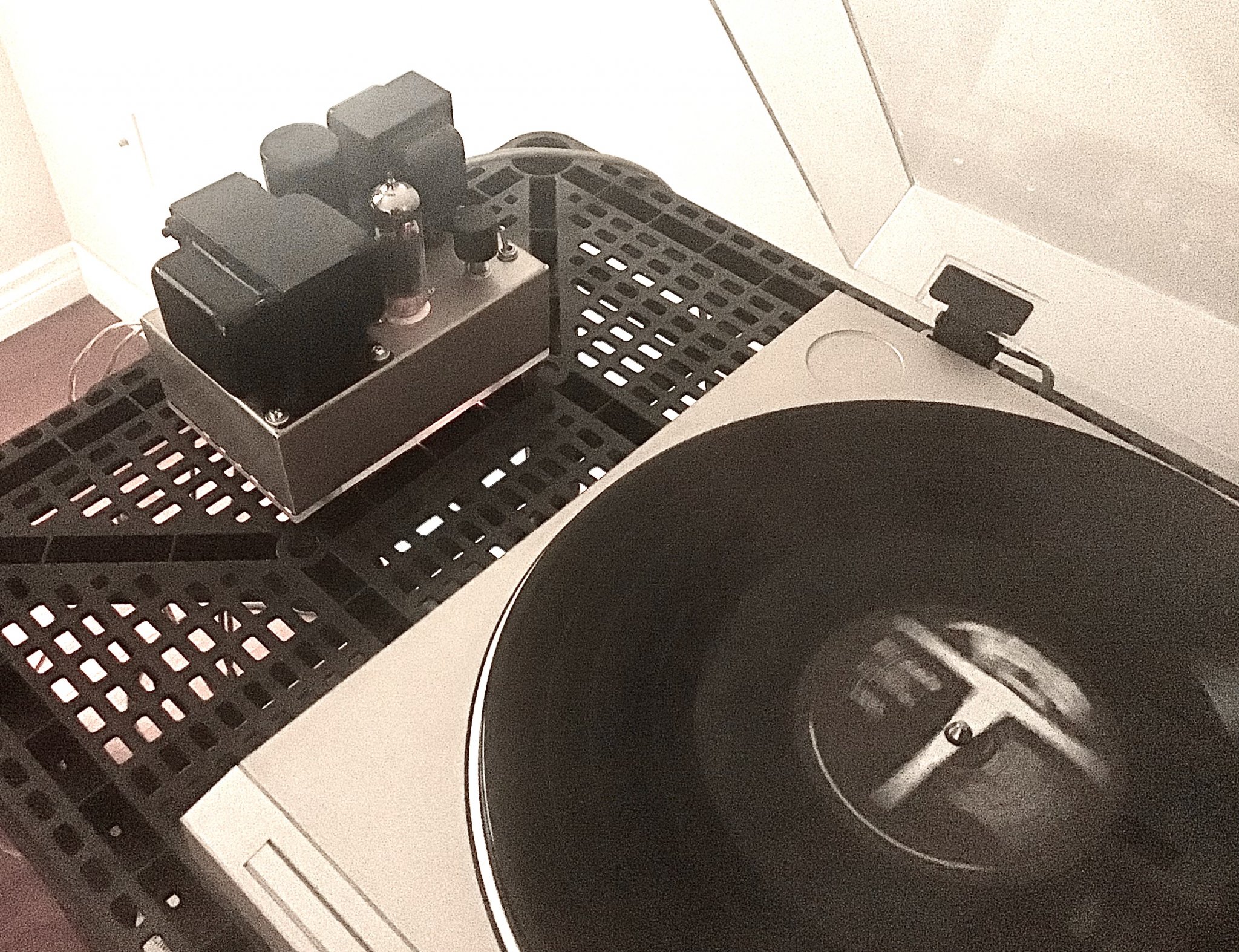

Man, I hooked up the Yukon Gold today. It’s playing through my big Audio Nirvana 15” Super Ferrite Big’un speaker. The source is my Pioneer PL-2 turntable with an unknown cartridge (maybe ortofon) playing Getz/Gilberto (1964 but re-released 2020). Phono amp coutesy of my Marantz 1530.
Now, it sounds just wonderful. The EL84 is switched into pure triode mode and the volume is low as this is a sensitive speaker. Bass smooth and deep, no treble harshness, no hum at all. Could it be better? - there’s not quite the clarity and openness I enjoy from my SS amps which maybe an OPT limitation, or it’s further upstream.
