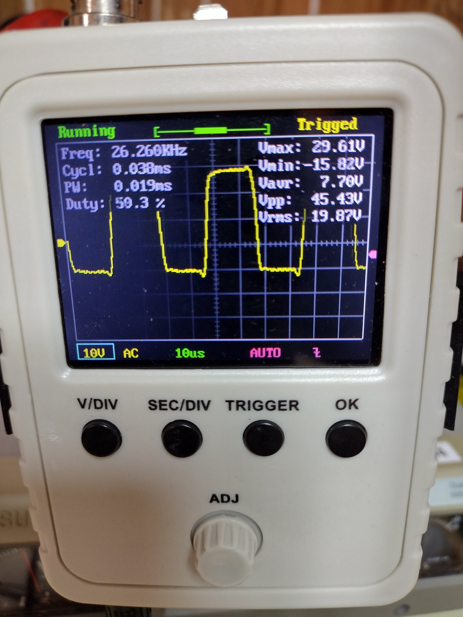

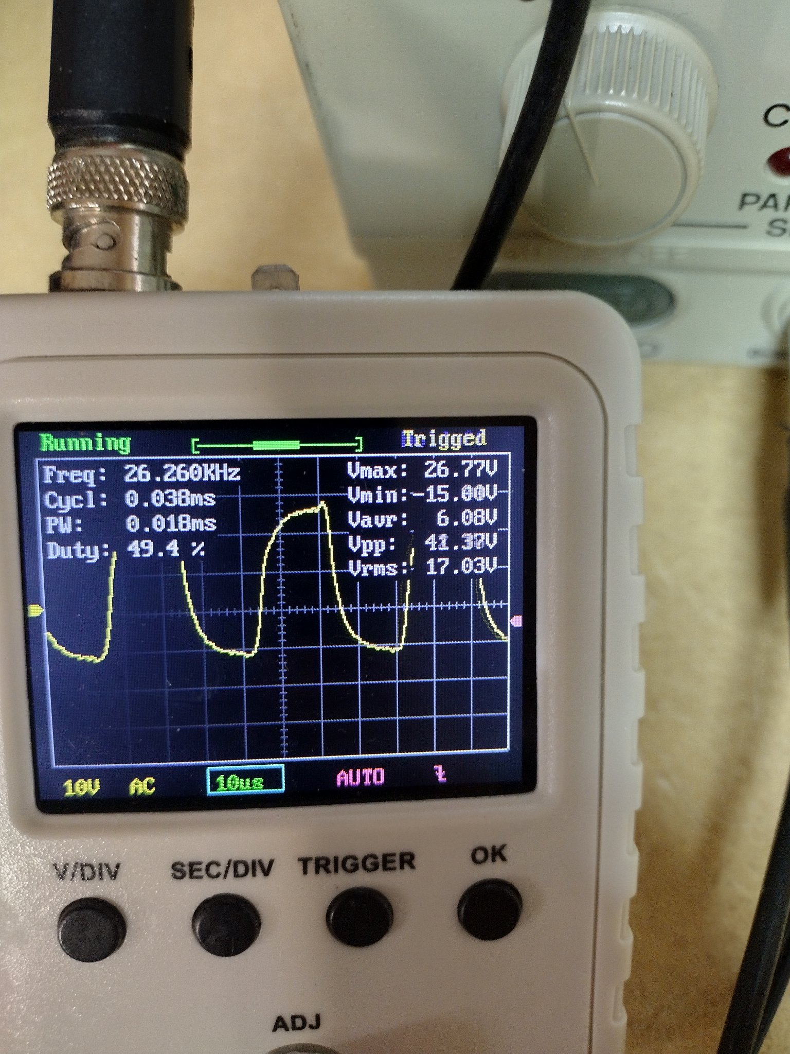

The first image is the output of the IRFZ44 and the second image is after it goes through the transformer (input to the rectifiers). The rectifiers are removed. I am new to the amplifier circuitry but the other amps that I have worked on still had a nice square wave with the rectifiers removed.

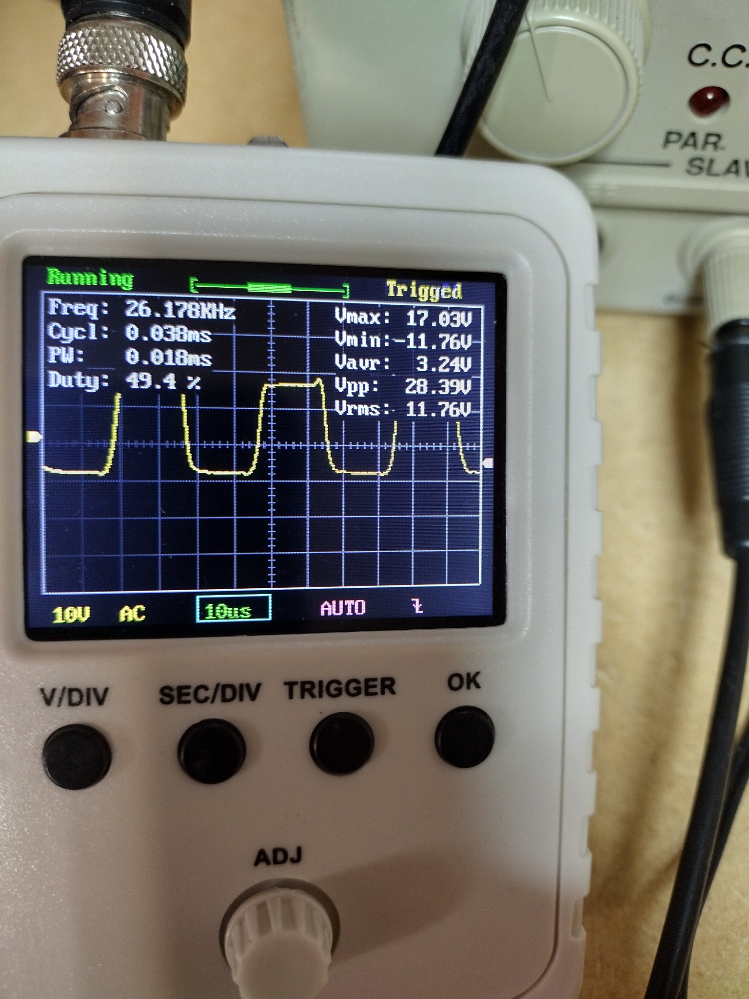

What was the ground for the scope connected to for the second photo?
Try connecting it to the secondary center tap.

Yes the waveform looks like what I expected. The amp will not idle within the 2.2A limits of my power supply. The manual gives an idle current of 0.84A. Can I turn the bias all the way down and then power it up?

As a side note on the ground point, if there is complete isolation from primary to secondary or a very high value coupling resistor, you must use the appropriate grounding point to get a reliable reading.
