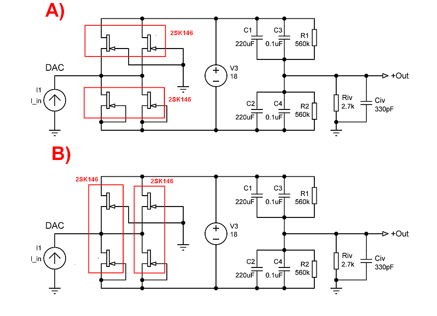

I have got 4x 2Sk146 which I want to use in the SEN topology. For the single channel I will use 2x PCM1704 in parallel. Since 2SK146 is two JFET in one aluminum enclosure I would like to ask how to connect two 2SK146 per channel (A or B from enclosed schematics to better cope with heat dissipation/alignment?
Thanks,
Bern

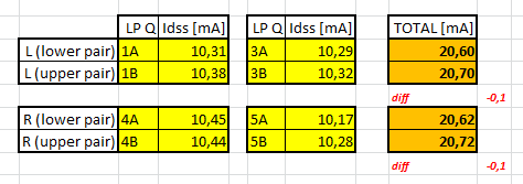

I've measured Idss of my JFETS (2SK146BL). The total of lower and upper pairs of Jfets are 20.6 and 20.7mA for the left channel and 20.62 and 20.72mA respectively for the right channel (see enclosed details). Do you think that 0.1mA Idss mismatch/difference could be an issue? If so how could I limit the adverse impact?
Will end up as a small DC at the current input.
Add a small degeneration resistor to the source of the higher current and trim the DC voltage to Zero at the current input.

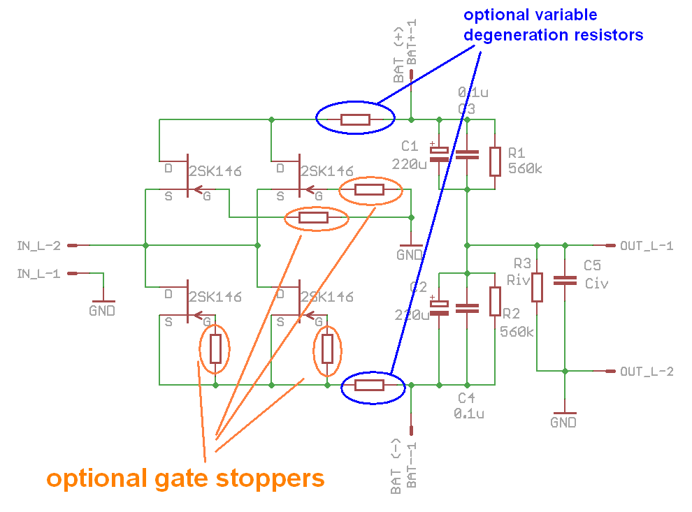

Please have a look on schematic I added OPTIONAL resistors (gate stoppers and degenerate resistors). Is it correct?
I am going use SEN and 2xPCM1704 in parallel per channel.

Gentlemen (in general and no one in particular),
Many thanks for your interest over the many years; I am truely flattered.
While the SEN / CEN IV look deceptively simple, they are quite complicated to implement and requires good understanding of analogue electronics.
Above all, they require the use of floating power supplies and hence are suspectible to grounding and noise pick-up problems.
If you do not process such skills, I suggest you try something easier for beginners, such as the excellent ZEN IV by Nelson himself.
You will find a lot of details here :
Zen I/V Converter | Pass DIY
Zen I/V Converter
My apologies for not being able to nurse every individual projects to theri successful conclusion.
If you have a technical issue involving the circuit design that has not been addressed before, I am of course interested to know.
Patrick
