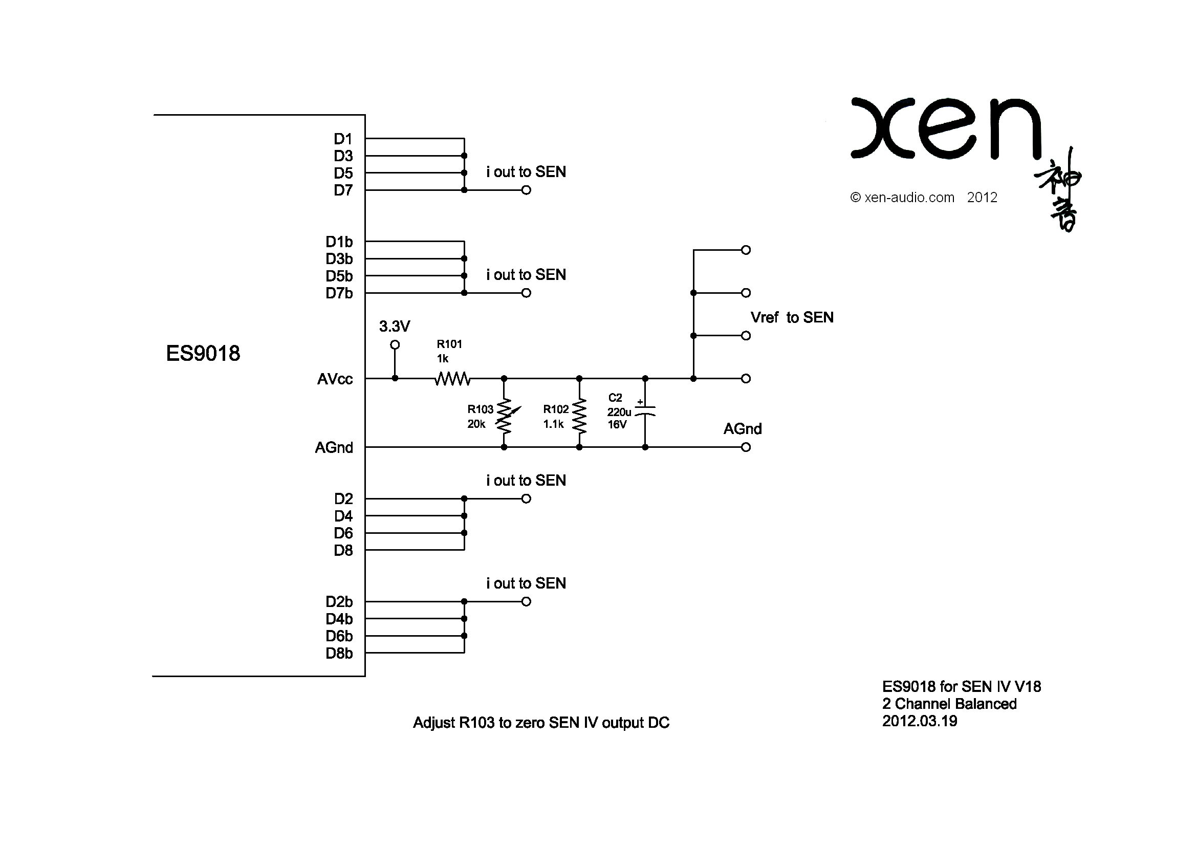

why such a high value for R103? to keep current noise and loading down since its directly across the reference?
Felipe, i was talking about a variation (not much variation) what Nic did, which relies on the jfets being very well matched, if they are you can delete R103 altogether and make R101 and R102 1K (tightly matched, i was suggesting a Zfoil resistor network part) or really 1-2K would probably be ok, higher will have less current noise but higher voltage noise, lower will load the dac analogue reference too much.
So why do we need R103 and why 20k ?
As Nic was the first to test build this, and the only one so far, I wanted to play safe and to include a means to adjust output DC of the SEN IV.
This you can achieve, in addition to good matching, by making Vref adjustable.
To implement this, instead of using 1k for both R101 and R102, I deliberately use 1.1k for R102. When R102 is then paralleled with a 10k resistor, the equivalent resistance will then be back to 1k, and thus Vref is then exactly 0.5x AVcc of ES9018. A 20k linear trimpot has 10k at the min-position, so that is why it should be 20k, and not anything else.
Then you will ask why I would choose 1k for R101 and R102. With AVcc = 3.3V, the current through them is 1.6mA nominal, so it does not load your AVcc excessively. As seen by the JFET gates, it has an output impedance of 1k//1k = 500R even without C2. This is low enough to drive the gates without compromising bandwidth. You may, if you wish, reduce these further to 500R or even 330R without any real drawbacks, as long as your Avcc power supply can deliver an extra 5mA. So feel free to try.

> which voltage for Vref to SEN?
Vref = 0.5x AVcc of ES9018.
See :
http://www.diyaudio.com/forums/atta...n-minimalistic-iv-converter-es9018-sen-iv.png
Patrick
VRef = 1.65V

So as I supposed R103 it's to trimm voltage needed for the VRef to SEN
Hope this is clear enough.
Patrick
Using R101 & R102 1K can I delete R103 20K trimmer? it's not clear if it's necessary to use or not C2 220uF 16V?
Yes.
Yes, you have to.
C2 has a different function. It filters any noise at Vref originating from the Avcc.
But you can experiment with values and cap types to see if they make any sonic difference.
Patrick

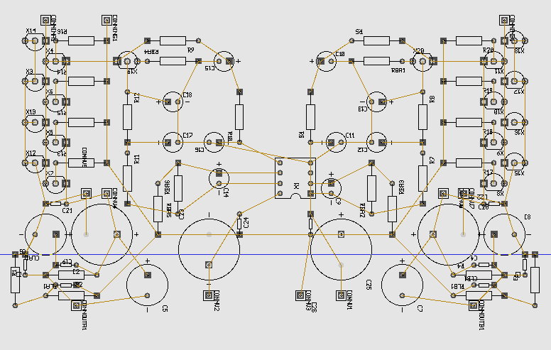

Trying this for PCM 1794
The op-amp I/V stage after my PCM1794 DAC is now measurably the weakest link in my system. So I want to try out this I/V.
I'm planning to use 2 op-amp servos and 2 extra 2SK170s (per channel) to suck out the 6.2mA bias current - see pdf. I'm hoping this will also solve any thermal drift issues.
I'm planning to recycle the 49720 op-amps from the old I/V stage for the new servos.
I've matched Ids (Vds=12V, Vgs=0V) of all quads of 2SK170s. All quads sum to 34.46mA +- 0.01mA.
I have a set of switching power supplies 4 of 24V and 1 of +12V-12V. I also have linear power supplies 4 of 18V and 2 of 12V. I'm hoping the switching ones will be OK.
I'm building it on perfboard with balanced halves back-to-back - see png file showing two halves which will be back-to-back.
ngspice says -135dB 3rd harmonic, 3.978V output.
I've read the thread but haven't read the journal article.
I'm an analog novice.
Any comments on this plan?

Please excuse a dumb question.
Relating to the circuits posted here at the beginning of the thread, the output is taken from two points parallel with the NiMH battery supply, which have very low Ri, typically less than 1 Ohm. I don't get how a significant output voltage can be obtained from such a small resistance in parallel with the output.
As explained in the article, the floating supply is in a separate current loop as the signal path, and then the two can be considered so.
The output impedance as well as the IV conversion gain is purely determined by the R_iv.
You can easily set up a Spice model and check this for yourself to help you to understand.
Patrick
As to the PCM1794, I would suggest you replace your entire servo circuit with a simple current sink (to a negative voltage) of 6.2mA adjustable first.
You should first try this out on a breadboard before making any PCB.
You may well find that your current source (depending on design) is stable enough not to require a servo.
See also Ryan's schematics as a reference.
http://www.diyaudio.com/forums/digi...minimalistic-iv-converter-12.html#post2935106
And if you still think you need a servo, then you need one which uses the SEN output as the servo input.
Patrick
as Patrick already said, try the simple version first. Its still the lowest noise sink.
You´ll find that this current sink will be the dominant noise source in this circuit anyway. Any more complex circuitry introduces additional noise without giving a practical benefit, since the simple JFET-sink works stable enough and finds it final working point within a minute or so.
