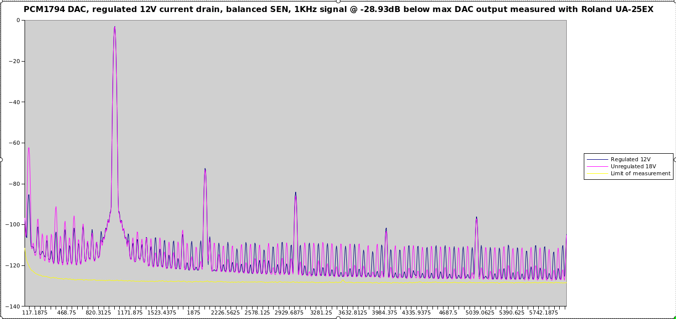

I determined that the floating 24V SMPs were the source of my noise problem.
I have done a test with regulated linear supplies with much lower stray capacitance between the mains and low voltage side and the noise is now below what I can measure on both the unbalanced SEN half and the balanced output. If I turn my 100W tube amp up to full volume I can still hear a little noise from the new PSUs if I put my ear within about 6 inches of the tweeter of my 88dB speakers. Normal listening volume is 30dB below this where it is inaudible.
I also grounded the current drain PSU and the SEN end of the shields of the output cables.
Listening test tomorrow.
The new PSUs are nothing special - 20RMB each I think (about $3). They are 12V. I also have some unregulated 18V ones to try.
I did another measurement with the sound card. Noise is down below the measurement floor but distortion results don't look that great. 2nd harmonic is about -40dB and 3rd about -70dB some 4th and 5th, nothing else. Much worse than I was expecting. I'm not sure if I'm measuring right or if my servo has messed up the circuit or perhaps it's just not balanced right. Another possibility is that the SEN input impedence is too high for the DAC but I have used quads of jfets so I think it should be about 8R.
Maybe time to try removing the servo.

SEN PCM1794 measurement
I have got some measurements from an ADC with balanced inputs. I was comparing my power supply options for the floating supplies.
FWIW, here are the results. I had to dial down the signal from the DAC to -30dB to avoid clipping in the ADC. I was mainly interested in noise which shouldn't be affected except that the SNR should be 30dB better than shown. The distortion results are probably not representative though and they are still way higher than I was expecting.

I believe your results. I'm not that confident in mine.
Spice indicates that the distortion is quite sensitive to getting the operating point right - I don't think I'm there yet.
There are also quite a lot of differences in the circuit I'm measuring and I'm using a real DAC chip which I know doesn't like driving anything but a virtual ground.
