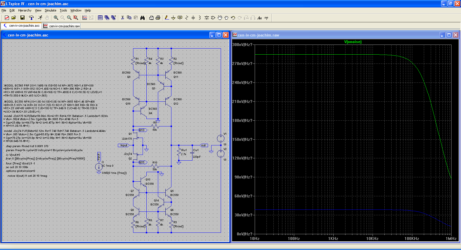

For Joachim's circuit in post #99, THD is 0.0016% in Spice.
- Without 4x 370R loading resistor, THD is improved to 0.0012% for lesser voltage swing at input FET drains.
- Without the 4 helper BJT, THD is increased to 0.003%.
- Without 2x 50k feedback resistor is THD is 0.0021%.
So plenty of choices, whether to go for simplicity or the last few dBs THD.
We'll stay with the Wilson mirror for now.
I think I had a thinking error with Calvin's circuit. I think I get it now about the biasing.
My apologies to Calvin.
Still, my prejudice remains against exponential devices.
But I guess the real test is a listening test.
See if I have time to put a proto board together, using 3 separate supplies.
Patrick

Noise plot of Joachim's circuit.
Upper trace, without load resistors. Lower trace, with load resistors.
Joachim is right of course.
Noise performance is much better with load resistors.
Patrick

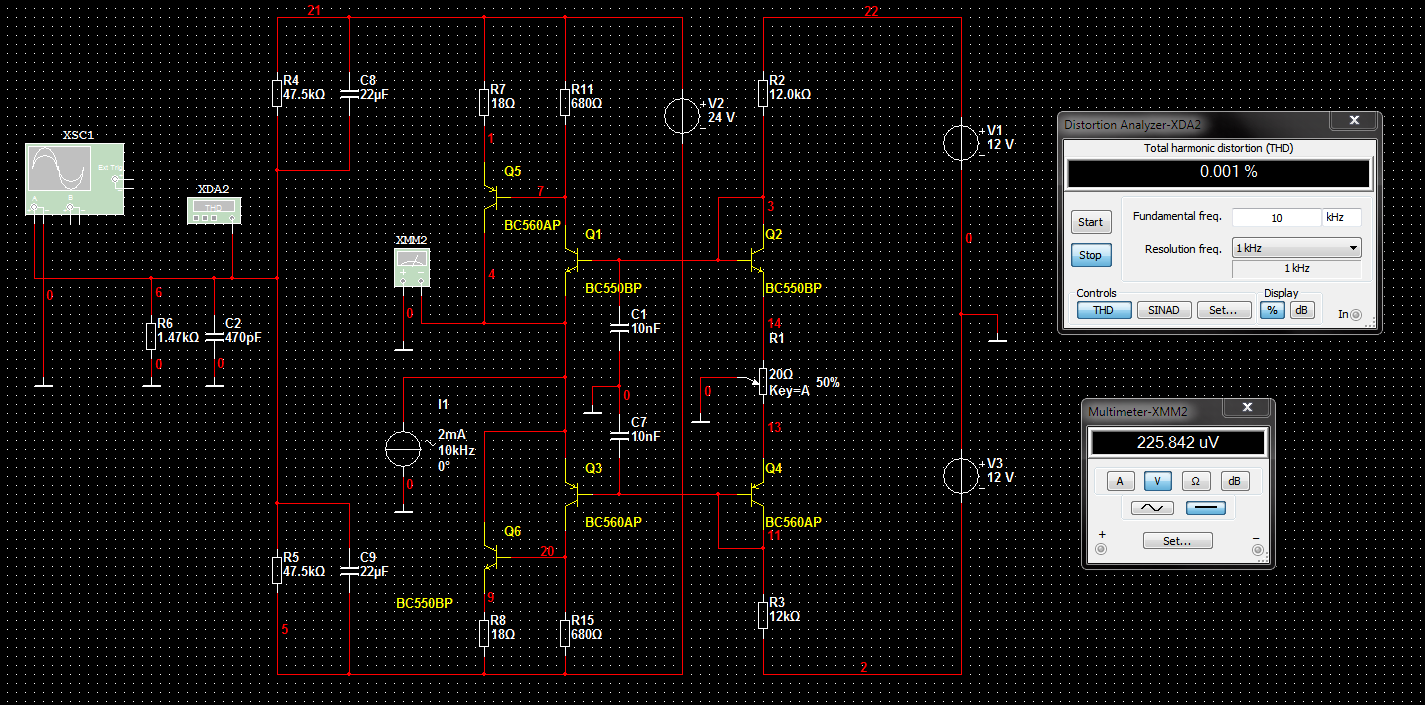

Piersma, i would call that a compound input stage. I have played around with the principle.
I like the adjustable input offset. Of cause your stage needs a floating supply plus a conventional supply. My idea with the output buffer has the same unconvenience.
What are the 10nF caps for or do i read it wrong ? I would use a high value electrolytic
in that place to lower noise by 3dB.

The BJT models are just those from manufacturer.
The JFET models are based on those in the forum, but with the Vth adjusted to match Idss.
If you already have a basic model, you can compare the constants to those in post#104 & 109.
The text is clearly visible.
I don't have the asc files with me. Otherwise no problem to post them.
Patrick
Caps
hi Joachim,
The capacitors (i.e. 100nF) are there only in a real life implementation to keep the basis of the BJT's firmly connected to (HF) ground.
(suppressing superious signals)
To maintain a low noise configuration a bigger cap is needed, say 47uF.

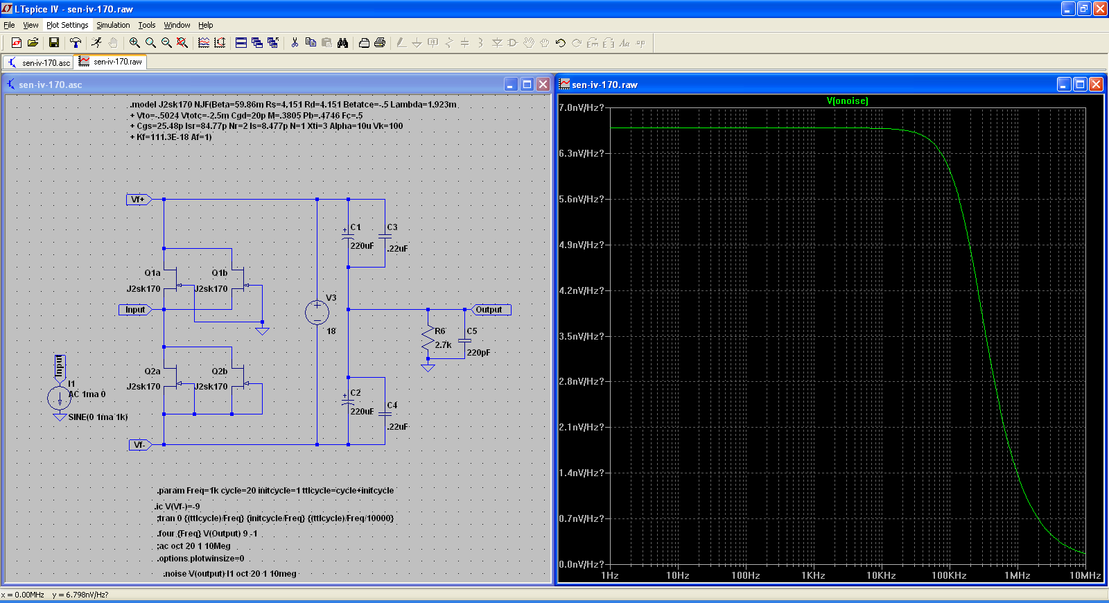

Table 3 says at no signal, there is a negative current of -3.5mA.
That means that the sum of Idss of the upper FETs has to be larger than that of the lower FETS, in order to supply this 3.5mA.
In the SEN circuit, you might need to add a source resistor to the lower FETs and trim that for zero DC out.
It also says that Vout of U2 in Fig.24 is -2.87V with no signal and Riv=820R.
That implies the output voltage of the DAC is at 0V.
(Vout - 3.5mA x 820R = -2.87V, hence Vout = 0V)
So the gates of the JFETs are still to be connected to Gnd.
To work out R_iv.
Assume you would like 2Vrms per phase, as most standard CD players.
2Vrms is approx. 5.6 p-p. The output current is 4mA p-p.
So R_iv = 5.6 / 4 = 1.4k.
As I said in the article, the JFET bias should be at least 2x the p-p output current amplitude.
So 8mA total Idss is minimum.
Hope the explanation is clear enough that you can work out for yourself for PCM1794.
Patrick

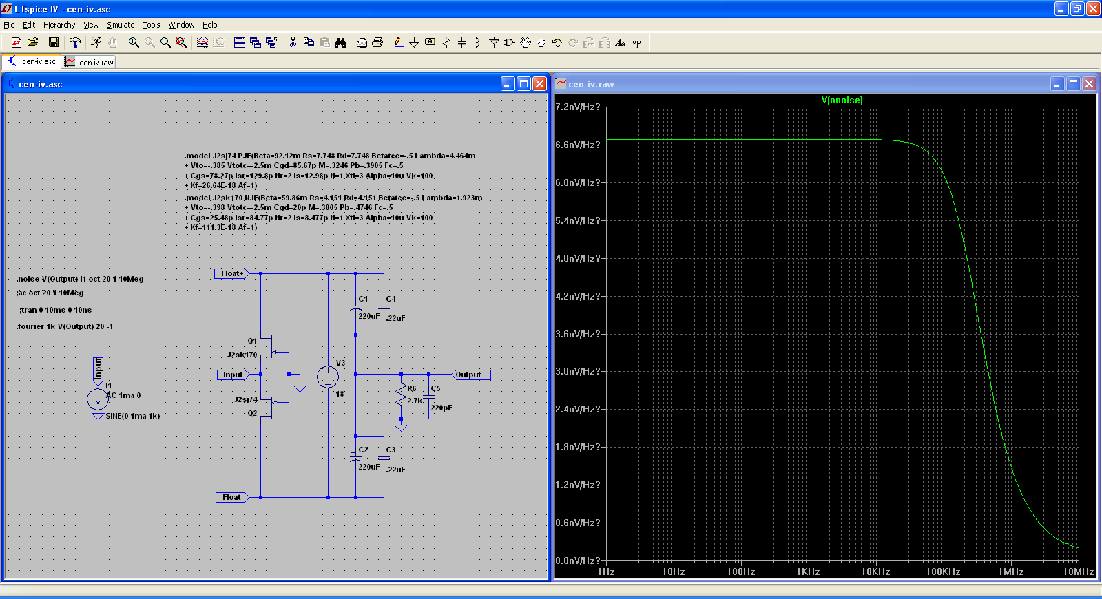

Thank your for detailed explanation, Patrick. The algorithm is perfectly clear, I sure can recalculate for 1794. Still don't understand how the circuit works, though, but that's my personal problem.
Is my understanding correct that I should use unipolar 18V voltage source and not a bipolar +/- 18?
I also wonder what's the point of doubling JFETs in Sen vs Cen. Scrolled through the thread but didn't see an explanation. Could you explain in few words?
