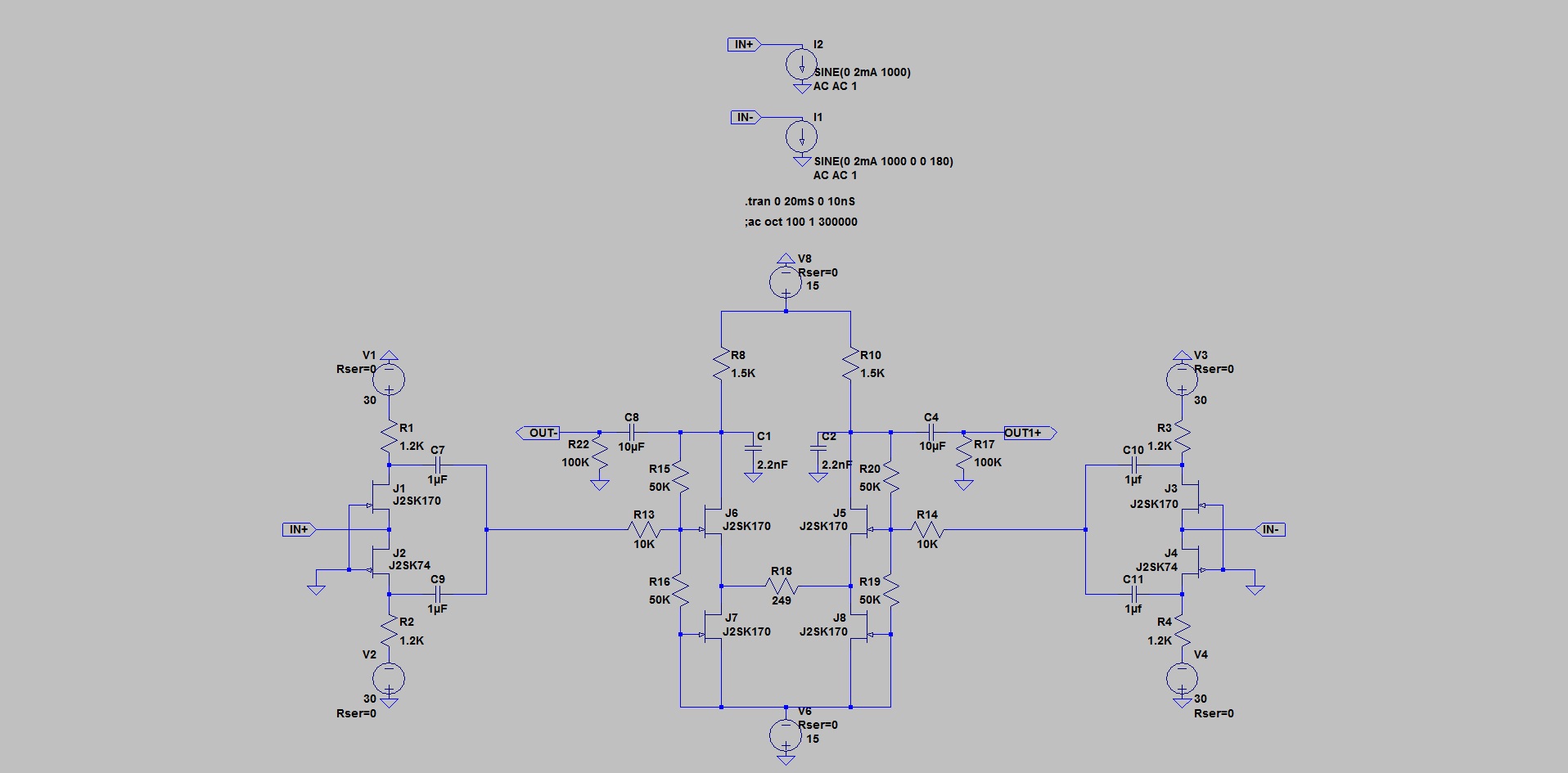

Iv'e been considering the addition of a balanced to SE conversion circuit for the balanced Zen IV used with my Sabre DAC. There have also been one or two other request in this thread. Something discrete is a must for me at this point.
I have looked and done some simulation work on discrete opamps like those from Nelson's article, Borbely, and others. To achieve measureable performance that would complement the Sabre and ZenIV, they became too complex for what I wanted to achieve. In the end, I came up with something I really like.
The good news is that you can also add some gain and the low pass filter in this stage and keep any fully differential ZenIV well within the Zen Zone (my opinion there).
More details about the stage itself are here.
Here is a balanced ZenIV with the new stage. This one has some gain to bring a lower level IV solution up to normal voltage levels if needed. To use it as SE, connect to the out+ and ground. Balanced outs are included as well.
If anyone spots a problem, constructive feedback is appreciated.
