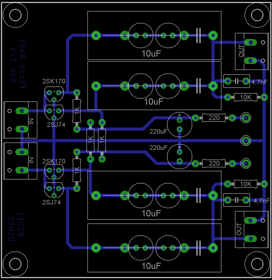

I want to build 4 of them for balanced operation. I just need to acquire some J74's! I have access to lots of K170's.
In that case it might be easiest to just order some sets through the vendor forum. iirc there are a few members offering matched sets of em. I say this cause my own attempts at matching did not quite suffice for my tastes (I used v-grades and matched em to 0.3 ma idss and had about 50 j74's versus 100 k170's which resulted in an offset of about 10mV at the input but some variance in the load resistors might be at play there as well). I would expect someone with better stocks to do better.
I'd also incorporate the suggested voltage divider to the gates from the onset so you gain a bit more flexibility in matching from the start. Then you can save the k170's you've got for an output buffer like the B1 or the one used by Borbely.

I have some 2SJ72 Jfets I can get from work, can i use those in place of the J74's? from the sparse datasheet i have seen, they are the same family. but the 72 will handle 600mw where as the 74 is good for 400mw. everything else appears to be the same. any reason why I couldn't or shouldnt use them??
Zc
I found some K147's and some J72's at work which are the same family as the J74/K170 just a higher current rating. I am going to attempt to use those however they are house marked so I don't know what the gain code is? is there a quick and easy way to set up a test jig to figure it out?
and what if the N and the P devices are different gain codes? would there just be asymmetrical distortion?
