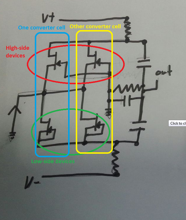

I believe in the righ size circuit the low JFETs are in CCS function; only high side JFETs change conduction/amplify the input signal. So if we use a PNP for low side, the emitter will oppose against the output signal, because base will be at a fixed potential (source from low side JFETs). In other words, will reduce the out signal and distorts it. The low side NPN version will serves a "loose" CCS but ideal is to define things with base reference (like some diodes) and use a emitter resistor to define the output current (making a "conventional" diode-biased CCS). These bipolars will become a single-ended buffer, with signal flowing in high side NPN.
If you don't use this DAC with low impedance loads, and not use with long cables, you can use the left side circuit. Really is a sort of "single-ended ZEN".
Interesting proposition, but unfortunately one/two problem exists: the JFETs will be subjected to only about 0.6V or so, so they will be starved. And the BJTs will be subjected to a enourmous/heavy base bias, so they will conduct a lot of current and will overheat.
In fact, simple circuits like Zen/Cen/Sen are beautiful but not lend themselves to easy modifications... just because they are so simple, one simple part change and behaviour change, sometimes drastically.
Only if DAC chip have same current offset from JFETs and have same output polarities - some are current unbalanced but is hard to match with the JFET, and loses precious current with loss os precious JFET transconductance. This means in practice one can use the "entire" ZEN I-V for each DAC output phase. Of course we will have 2 outputs (maintain balanced operation).
About output, will be tricky/picky to proper use even with emitter resistors, unless one use high values like 500 ohms to prevent BJT meltdown and loss of JEFT drain voltage, but so this results in rather high output impedance, negating most of the follower benefits...
how about this? we completely eliminate the -v side of the circuit. apologies for the crudeness but i only wanted to clarify the concept, as if it isn't simple enough already.
let's say the jfets aren't even paralleled. how would it perform compared to the original zen i/v? double the distortion?

Only one side JFET will work only with DAC chips with enormous current offset, and I don't know one with such high current. For offsetting this current we put one JFETs on low side for each high side JFET, resulting in original circuit 🙂
Using one JFET "per high/low side" instead a pair (resulting in one JFET for high side and one JFET for low side) results in higher input impedance, and for me works flawlessy for several DAC chips, like TDA1541 or AD1860 and cousins.

Some concepts at attached image.
The TDA1387 have a 1mA output offset, resulting very low current to use only with high side JFETs only, even if with only one JFET (one cell). Maybe this will work but with far-reduced performance.
So one can use high+low side as always, but is good to check the resulting voltage offset in TDA output pin and to check resulting JFET drain voltage. My adjustable MOSFET option can be adjusted for desired voltage offset. Of course, the adjustment can be applied to JFET version. The TDA1387 supports 0V to 1/6VDD voltage offset in their output pin. Or probably 1mA will not change things too much: experiment with "original" first. For alternative DACs using JFETs, search on ZEN-CEN-SEN thread (http://www.diyaudio.com/forums/digi...-evolution-minimalistic-iv-converter-183.html). In this thread probably one can find most resources about the JFET version/variants, since some members probably will be using chips like TDA1387.
PS.: I don't mention one thing yet: since low side devices in your drawing are N-channels, these don't contribute to AC output. You can dispense the "low side" capacitor and use only one attached to "V+" side, and gain a little output voltage. But is good to maintain the "low side" resistor (the resistor to V-) to better equate low side/high side JFETs dissipation.
