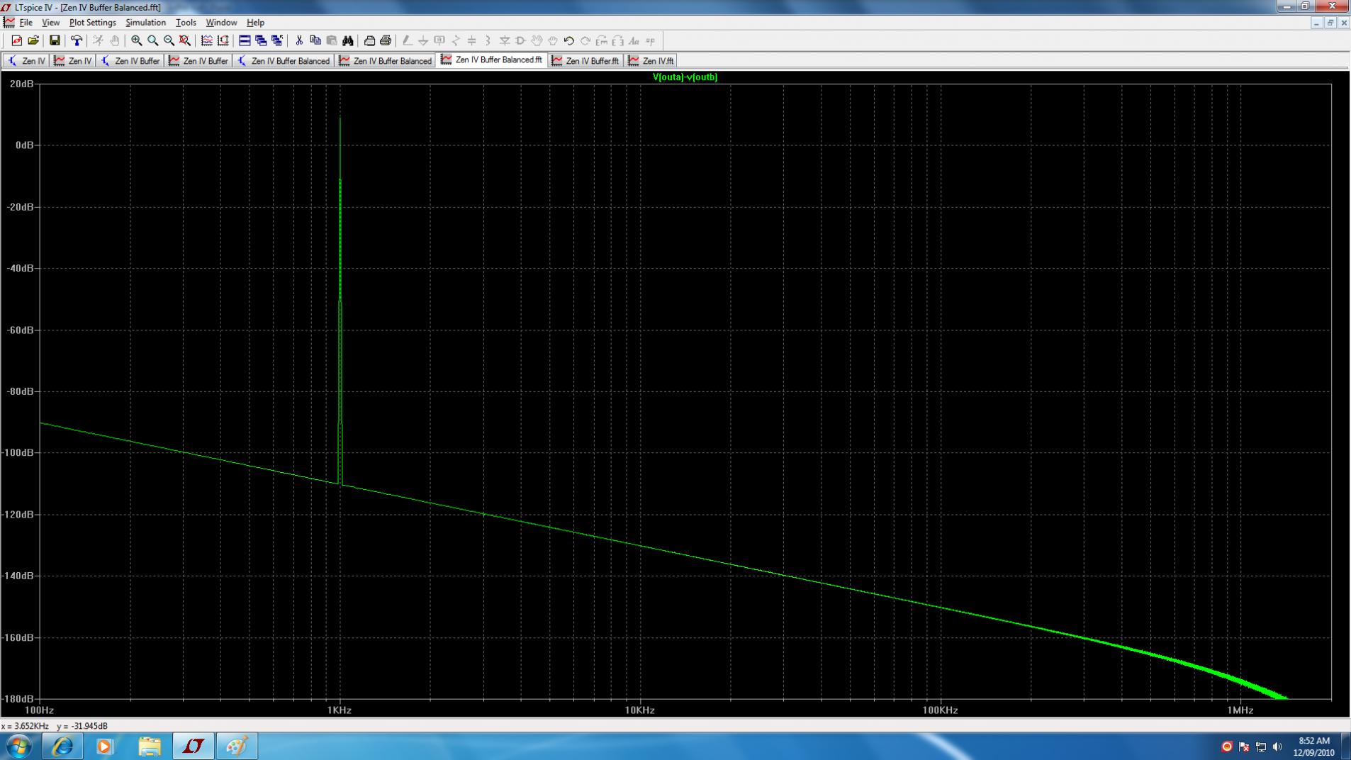

2SK170/2SJ74GRs are a bit difficult to find, but going to 3mA Idss is the correct move if you do not want to cascode. Also Yfs is (quite a bit) lower at 3mA than at 10mA, so it is not a 1:1 gain by paralleling. And your capacitances go up 1:1. So perhaps higher voltage is still the easier solution.

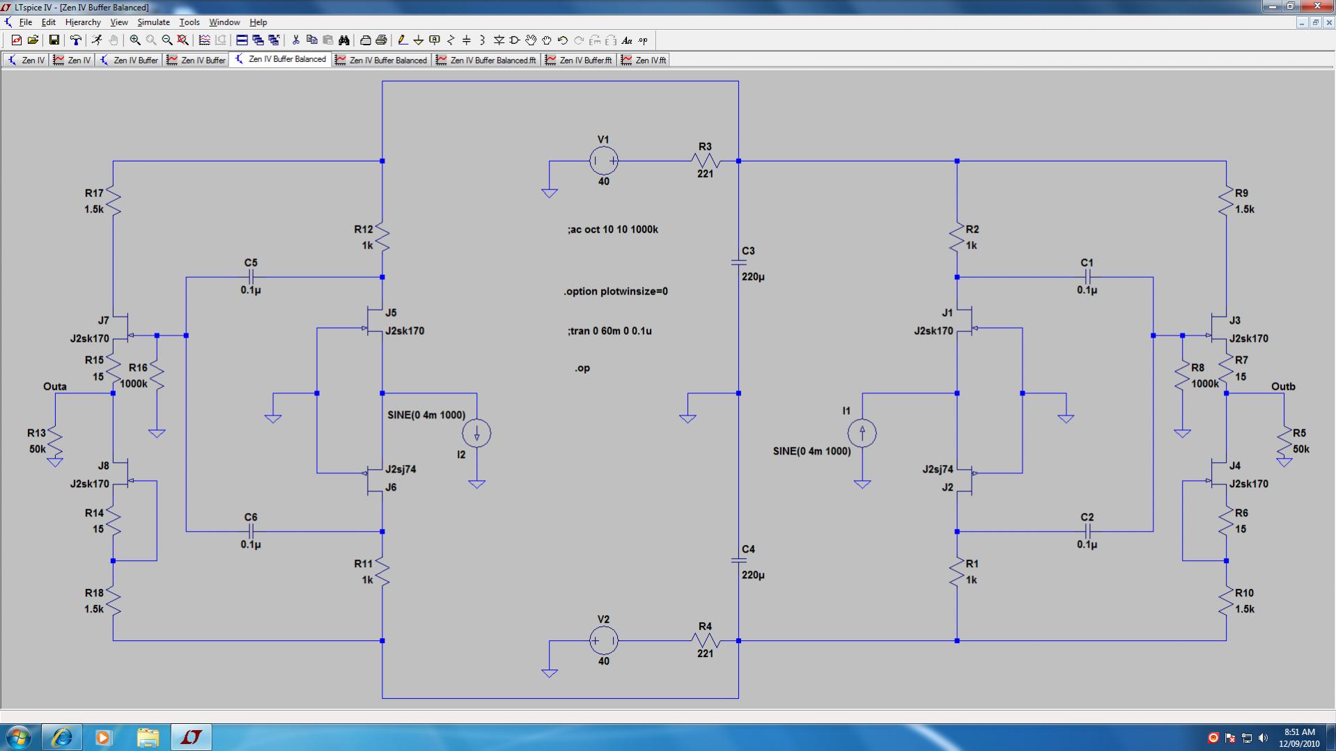

For your simulated circuit, you should consider changing :
1) C1,2,5,6 to 10uF minimum
2) R8,16 to 10k (using 500ohm to drive a 1k load is a bad idea)
3) add caps (100uF) to gnd after R9,10,17,18
I would use a complimentary follower with a single pair of 2SK170/2SJ74 and no source degeneration. Hardly any distortion with 10k load.

You are right patrick but there is a reasonable benefit in going for lower idss devices.
If you look at the data sheet a device with Idss of 10mA has a transconductance of 40mS, but a device with Idss of 3mA has transconductance of about 22mS if I parrallel 4 I get transconductance of 88 with a current draw of 12mA.
So I get more than double the transconductance (ie less than 1/2 the input impedance) with only 20% more current draw.
I will have a look at switching devices. I didn't know there were complimentary devices available or are you suggesting I build a D1 type circuit with these jfets.
