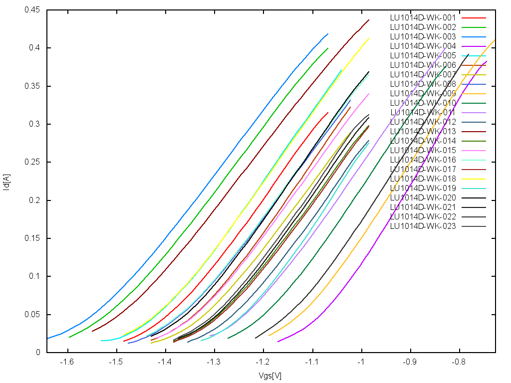

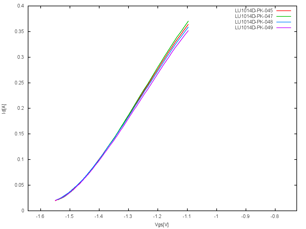

Here are some measurements for some we bought from Grey years ago (~4USD a piece).
As well as some others bought in China unmatched.
They were measured in circuit (a 200mA triode cell as used in the DAO headphone amp).
As you can see, even the prematched ones are not perfect.
For the triode cell to work properly, as even in the ZV9, one has to measure and adjust circuit accordingly.
See Nelson's original article.
In the DAO & DAO circlotron, we measured all prematched ones from Grey and from Deepsurplus from the same grouping.
With a large enough pool of >>100, we can match to < 0.5% over the working range.
