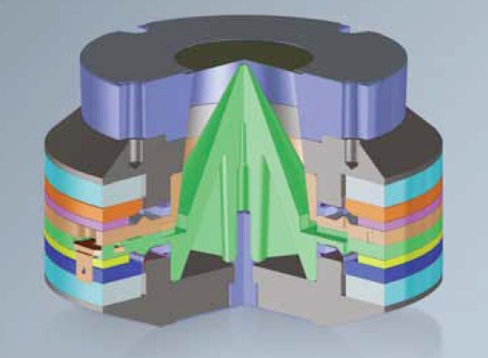

Cutaway of JBL's dual diaphragm ring radiators. (D2430K and D2415)
My goofy idea of how you could emulate the JBL using a ring of full-range drivers
Cutaway of the Apple HomePod

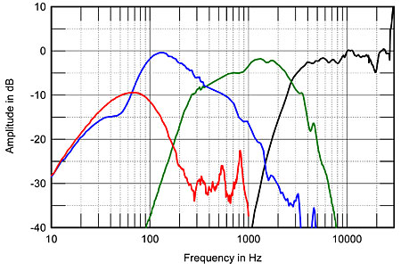

Here's the crossover for the KEF
Here's the overall response
Though I wasn't trying to copy the Kef design, I gotta admit they are really really similar. Similar polar response, similar crossover points. Kef data courtesy of Stereophile : KEF Reference 201/2 loudspeaker Measurements | Stereophile.com

If I arrange four of the MCM midranges in an array like the DNA Sequence speaker, I should be able to extend the beamwidth control down to about 750Hz. In the measurement of my waveguide you can see that the beamwidth begins to broaden in the midrange, due to the small size of the waveguide. (That was intentional, small waveguides "seem" to sound better than big waveguides, but the jury is out on that.)
Four of the MCMs raises the output to about 113dB on the low end, about 3dB more than my target. So that's good. They also due it with less power, due to higher efficiency. They're also an easier load; if any of you guys are running tube amps, the MCM array will be preferable to the Anarchy. The MCM array has a higher impedance and requires less power, but also needs a bigger box.
Here's the response shape with a filter in place. The filter smooths out the high frequency peak of the MCM, doubles it's power handling, and crosses us over to the midranges.

Still confused on the diff between Unity and Synergy horn.
Did find this explanation but it can hardly be so simple.
"The Synergy horn is like a grown-up version of the Unity"
First off, this is not legal advice, and if you are interested in finding out the difference between a Unity horn and a Synergy horn, you might consider consulting a lawyer.
Here is my impression, based on a hobbyist's observation of the two devices. These observations are based on my examination of a Lambda Unity Horn and a Danley Sound Labs SH-50:
The Unity Horn is a multi-entrant horn designed by Tom Danley for Sound Physics Labs. The patent largely covers the geometry of the horn. The patent is expired.
The Synergy Horn is a multi-entrant horn designed by Tom Danley for Danley Sound Labs. The patent covers the geometry of the horn, which has some important differences from the Unity Horn. The design is covered by a valid patent.
I can't recall if the crossover is mentioned in either patent. They are different.
- "Unitized" Image Control Waveguide
