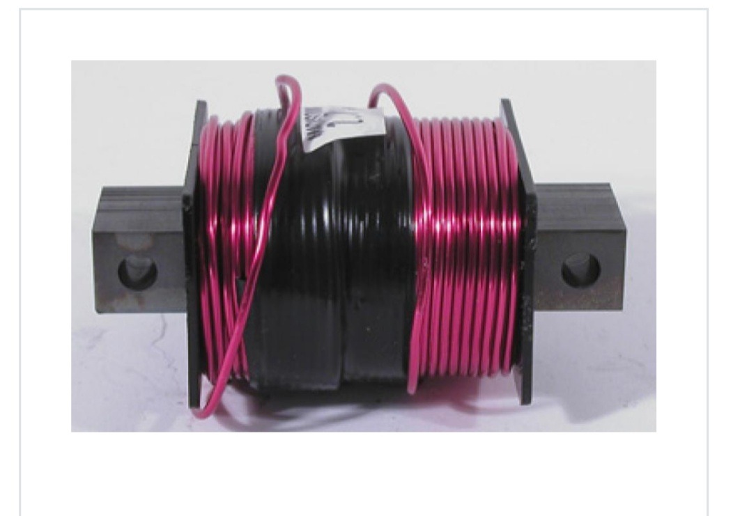

One question on inductors
The laminated steel core ones look like EI transformer i guess
What's the price differential with air core ones for a same value?
More or less i mean
Coils… well, that depends.
I separate:
Active speakers are for guys who dont know how to do passives
Regards J-C
I separate:
- for 2-Way i use Aircore whenever possible
- 3-Ways get Air for Midrange section. Most applications want/allow a R in Series to to the Highpass-Coil to GND, so a thin wire (1.0mm) Aircoil is almost possible.
- 3-Way Bass section I like to use I-Core coils, never had a Problem and quite low-R. Little distortion is ways below speaker distortion below 2-300Hz.
- Impedance corretion circuits usually draw low current and resonance-peak corrections using 10-27mH can be Core-types with thin wire.

This is the ONLY CORED type of inductor I will use. It's harmonic distortion profile is very ear pleasing and it saturates a bit more gracefully than most ferrite or sintered/powdered metal core types.

I guess you're talking about the only one in series with the woofer
Speaking instead of core saturation over sizing an iron core would not make the issue less dramatic like someone has pointed out?
