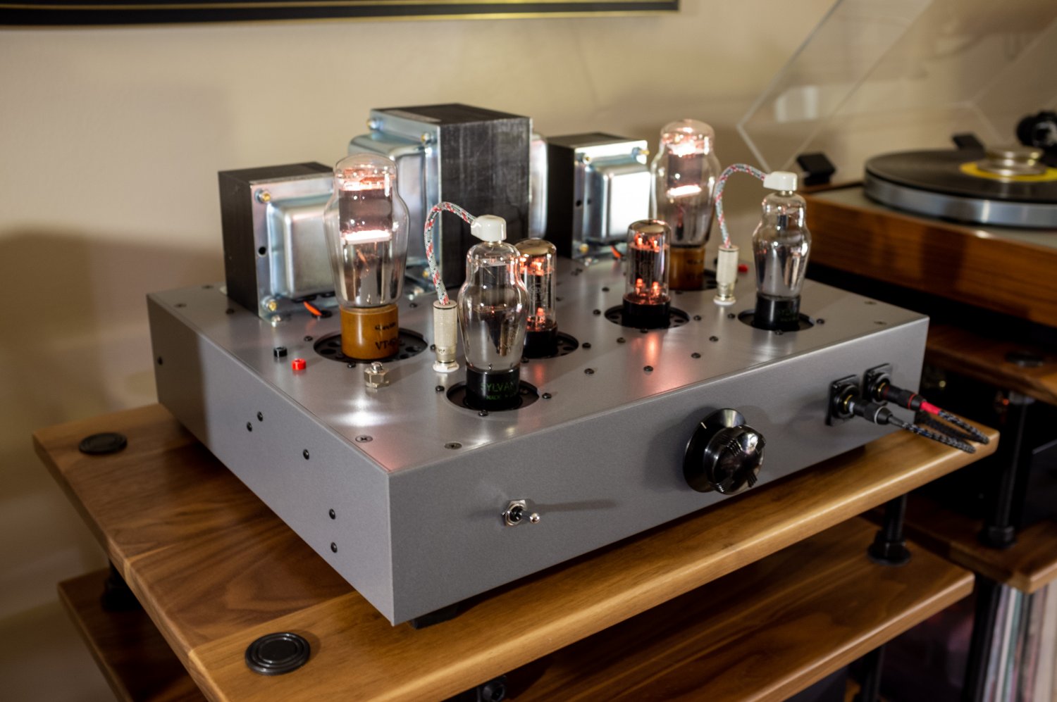

Just before the takeover, Brian helped me with custom mains and output transformers for my 801A amp. The mains transformers has a B+ secondary, a bias supply secondary, a heater winding, and two separate filament supply windings for the 801A, all shielded, probably one of the last custom mains transformers made. Output transformers are 5K:8ohm designed specifically for this amplifier. Very honestly could not have made this amplifier without his help, very grateful for it, but makes it all the more distressing to know that service no longer exists. I've picked up some texts, probably will begin the arduous task of learning to wind my own transformers for the future, have to start somewhere.
That is very sad.
