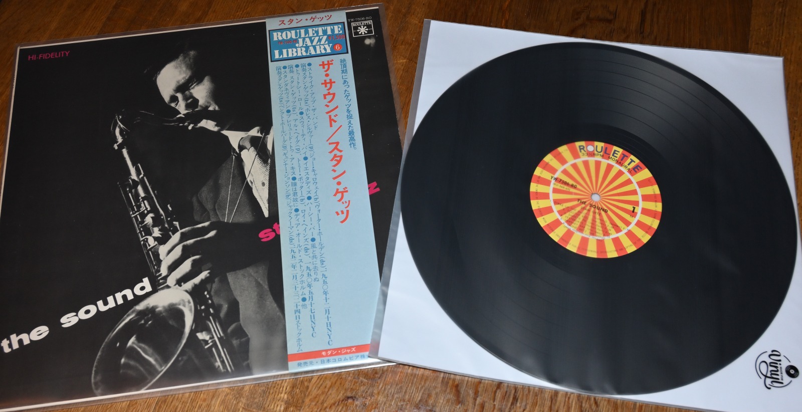

An example of an old record that changed from mediocre to perfect after a cleaning (in the batch that made the water in the cleaner yellow).
Record looks mint afterwards and very silent with almost no pops and groove noise.
Also I now know that Stan Getz really could play his instrument. So searching for old record you get some music you would never search for when streaming.
The record covers they used at that time are really heavy cardboard. Also record is flat so good workmanship.

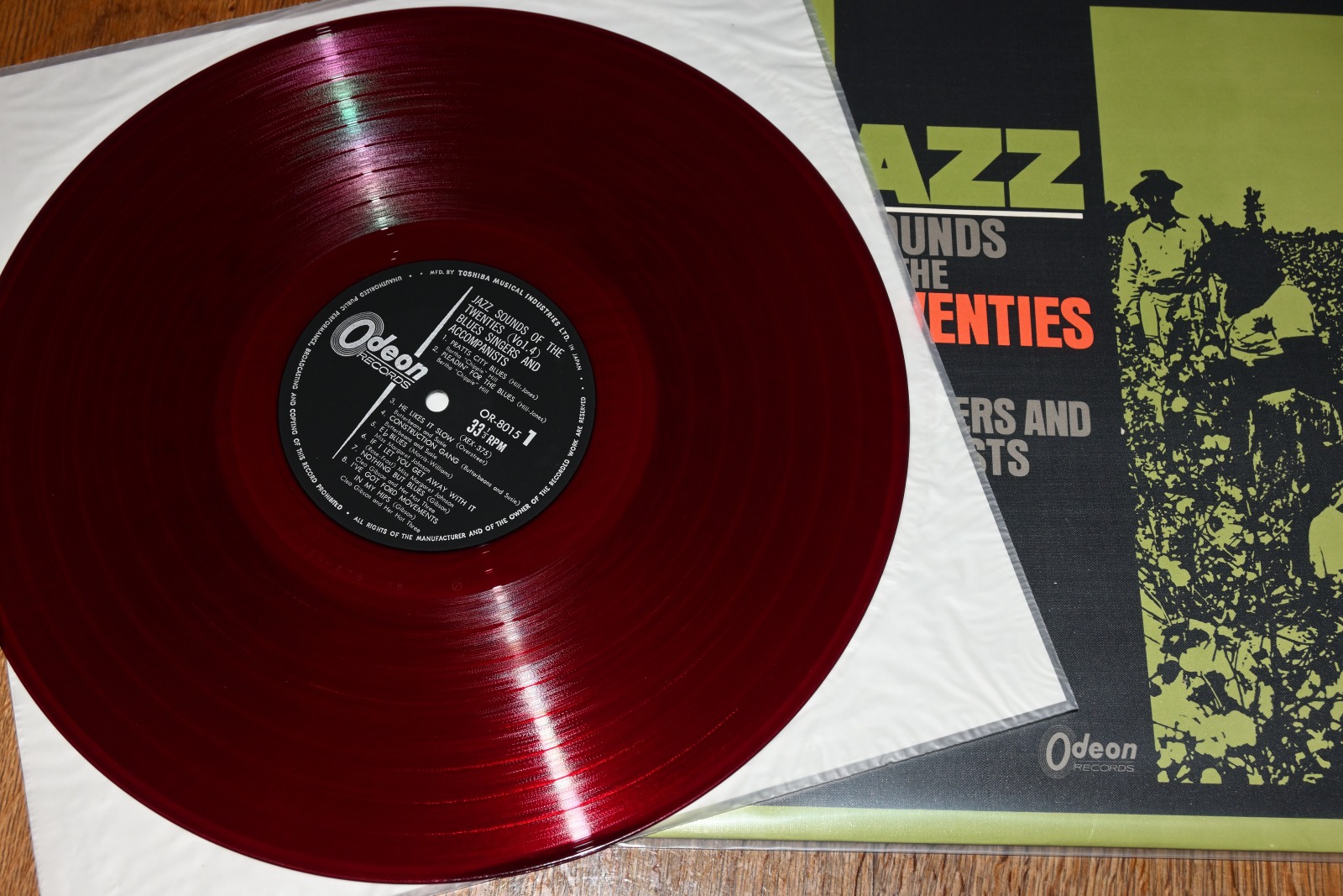

Another example of a record that was cleaned that did not sound very good before cleaning.
Then I also learned that Toshiba was in the records business and seems to do a good job.
Now when I search for old records I look "also" for these red vintage Toshiba pressings.
So you filter the dirty water and use it again?

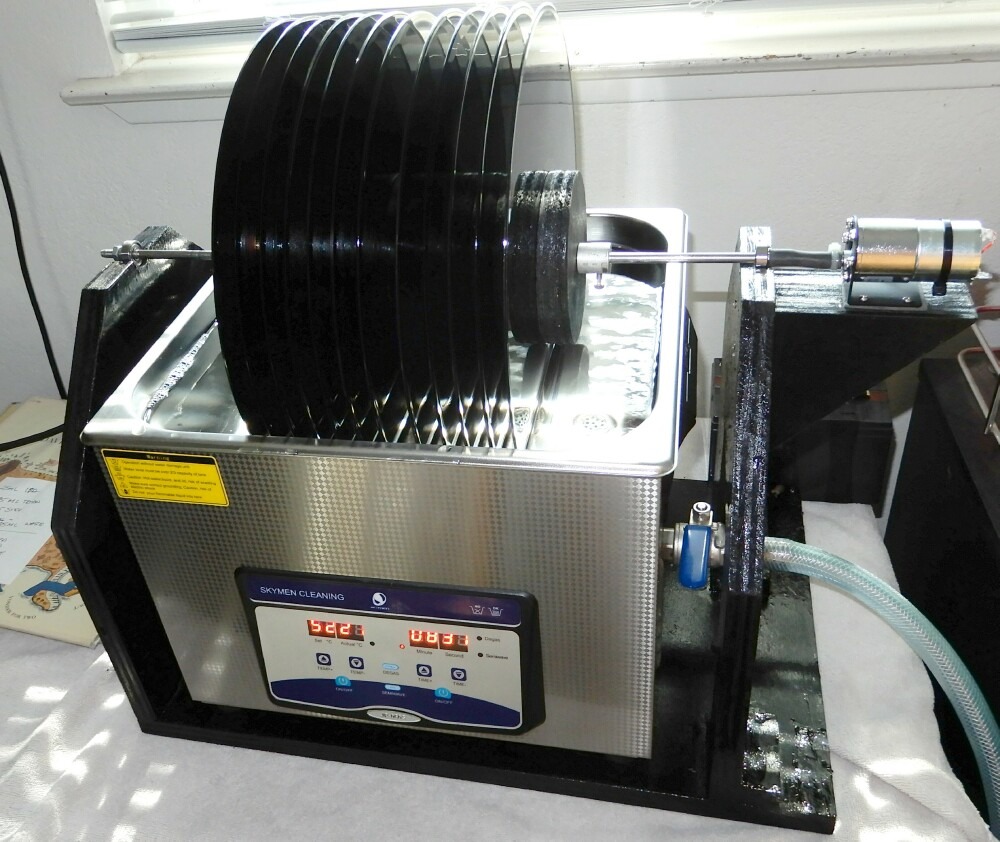

How did you set up that ultrasonic cleaner? I'm looking for something like that to complement the 16.5
The water is being constantly and continuously filtered to remove the particulate matter.

I fabricated the support structure using birch plywood, including the cradle for the spindle and roller bearings, and a motor mount. I used a 12V gear reduction motor (bought 2 different speed motors and used lower speed one). Machined the spindle for a slip-fit into the bearings, and used rubber tubing as a universal joint/strain relief for the motor. It allows me to tilt up the spindle to load each record, and the spacers between each. Took awhile, but I didn't want to buy what was available online at the time.How did you set up that ultrasonic cleaner?
My observation is that the better the phono stage, the greater the benefit from really clean records.

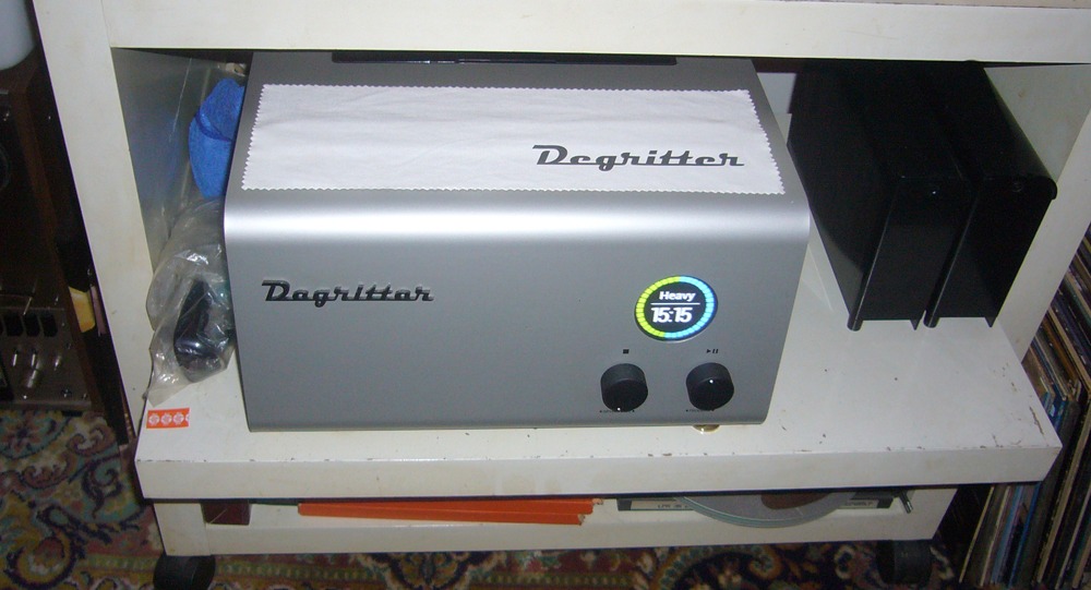

No reason to question that argument, since you´re absolutely rightUltrasonic cleaning is the best! It is absolutely, unquestionably, the single best improvement you can make to the entire playback chain.
Here´s mine..... One purchase I shall never regret. Company also has absolutely amazing service policy.
