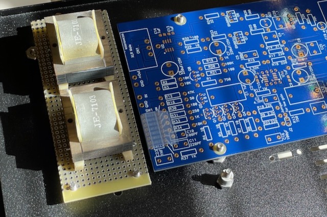

Doing a little test fit today...
These are vintage Jensen quadfilar output transformers, salvaged from an old mixing desk. Close if not identical to Jensen JT-123-FLPCH or Cinemag CMOQ-4. Core dimensions and measured winding DCR are an exact match. If the Q6-Q7 discrete output stage has enough grunt to drive these, I plan to use 'em for the balanced outs, in lieu of the DRV135 active solution. They'll add a wee touch of color to the sound, so TBD if they stay.
There is juuuust enough room to squeeze 'em between the P3 boards and the XLR jacks.
