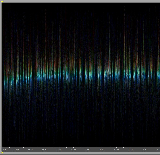

The poor man's solution I used was to add an SL1200 rubber mat. It's 6mm thick and reduces the magnetism quite significantly. The tonearm was hightened with the same 6mm. The magnetism is in my case strongest at the outer side of the platter and decreases after the first 1 - 1.5 cm towards the inside. The difference can be seen when one makes a recording of a steady tone from a test LP and looks at the pan and phase spectral displays. The first half minute (of the outer grooves) show a deviation from the center position of both pan an phase due to excessive stylus force. Not anymore with the added mat.
Reactions: 1 users
Moderator
Joined 2003
Here is an example of a pan spectrum of the first 1.5 minute with the first 20-30 seconds off center:
Reactions: 1 user

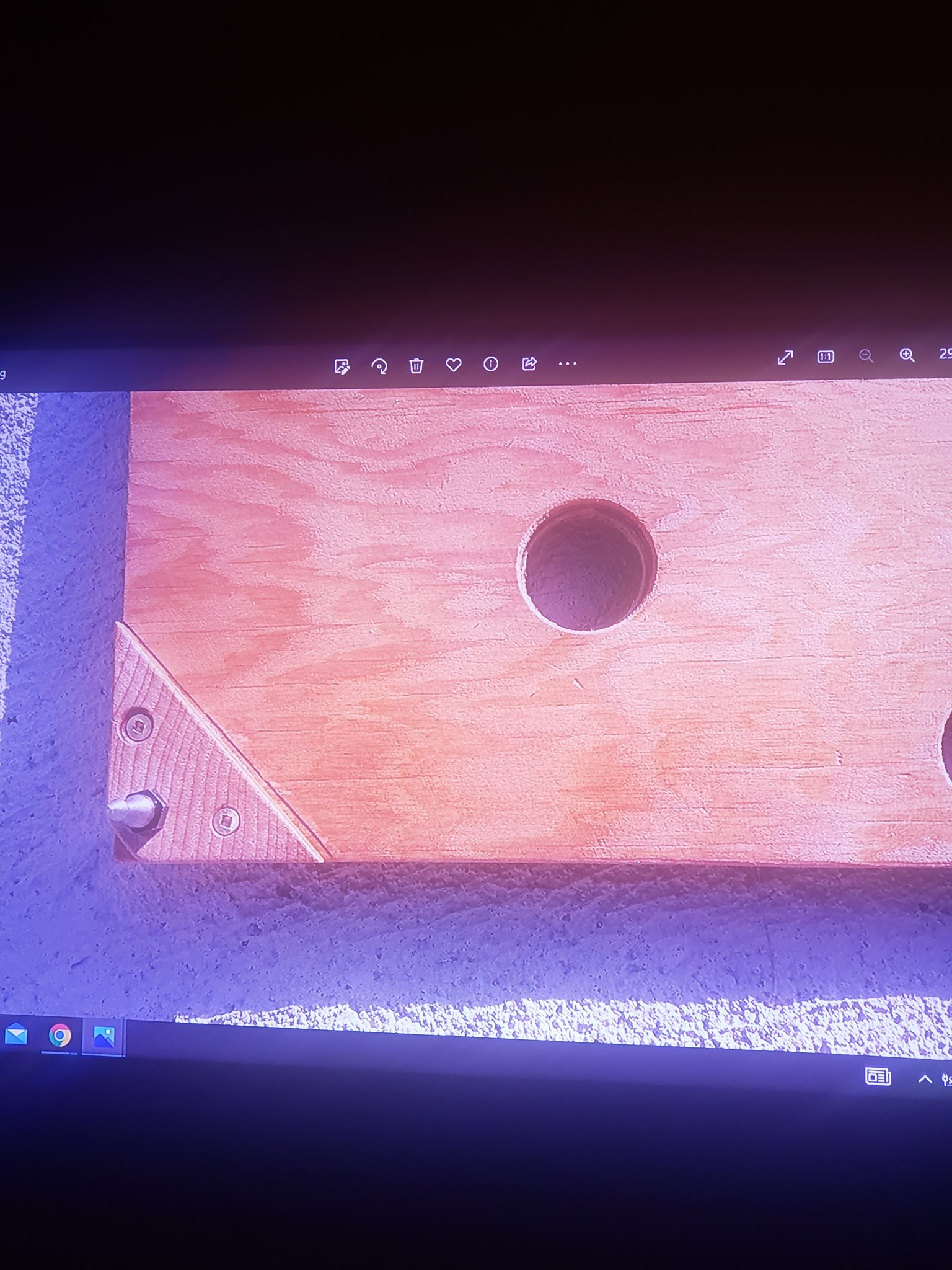

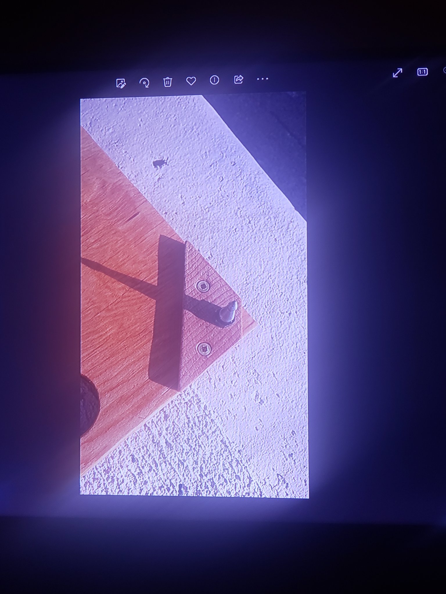

Great tables, I made a base for my ThorensTT simple 1/4" marine ply, hardwood glued/screwed overlay for xtra spike strength. Brass hardware only for personal candy it cant be seen while playing. Will follow two up currently having sign in woes.
