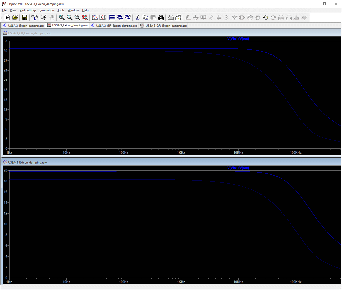

Yes, the GRs gives a higher damping factor.
I did a simulation in Ltspice
Upper graph: GR jfets and a 4 ohm load has DF 31 or 62 for a 8 ohm load
Lower graph: BL jfets and a 4 ohm load has DF 20 or 40 for a 8 ohm load
Time to solder the 5k pots :)

Yes Danny, you are correct. It is just that GR grade jfet are more important for the bjt output version but it will also work fine with your version and will provide a higher DF than other original USSA-3 builders have done. You will have a unique version ;)

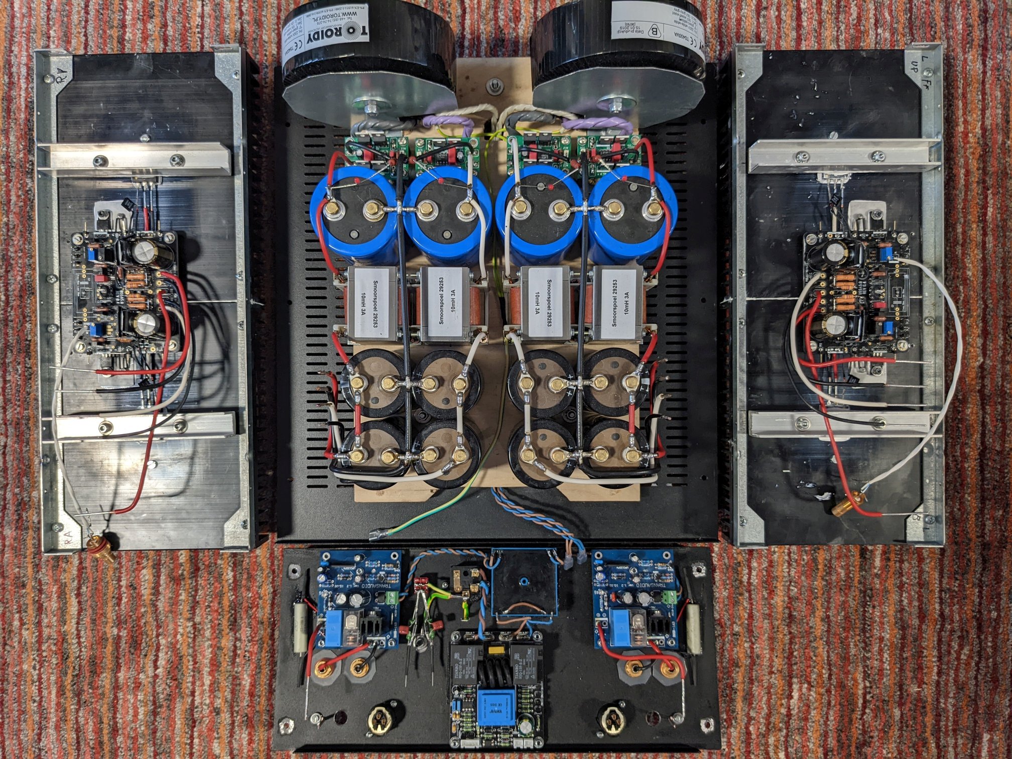

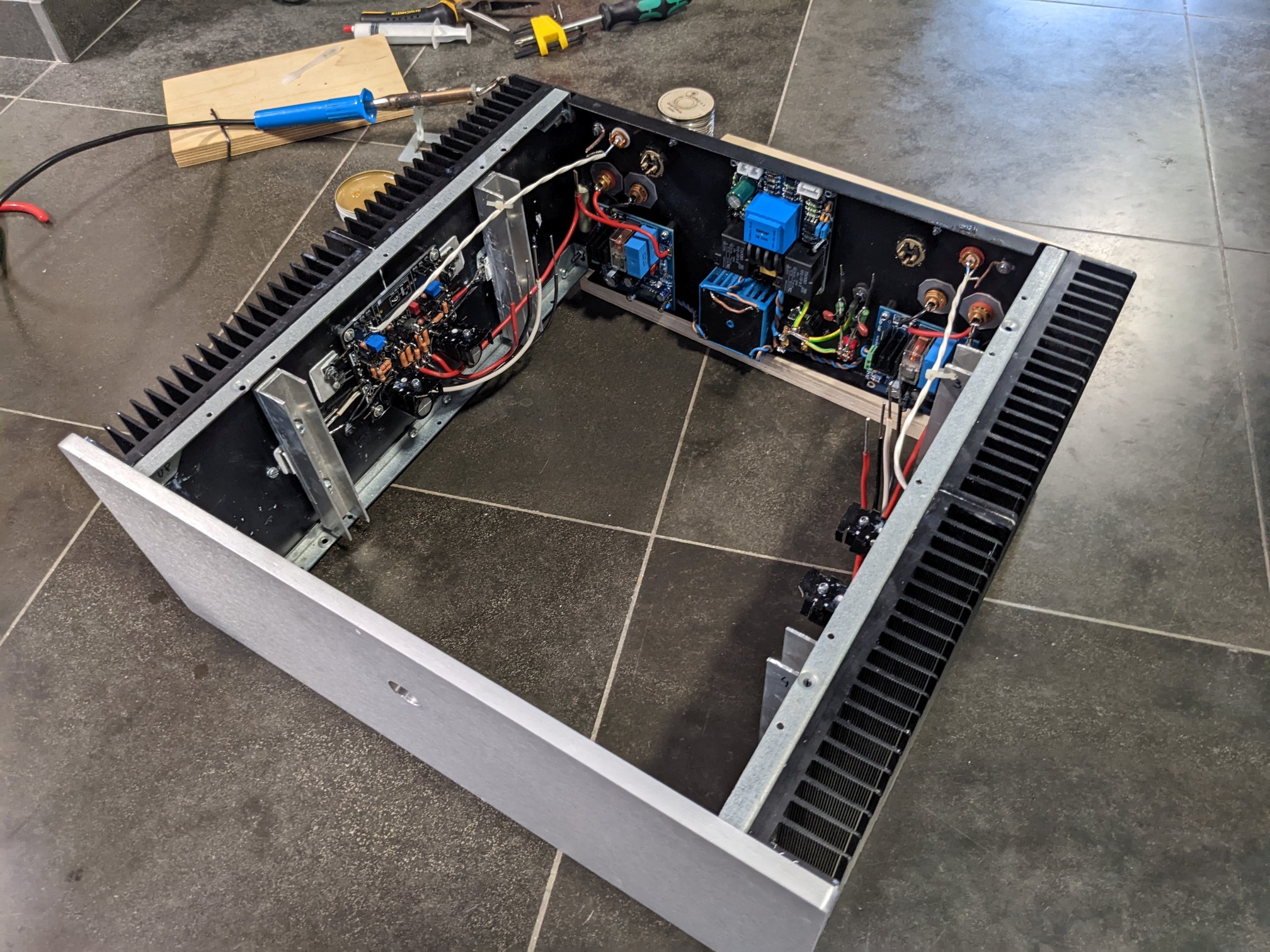

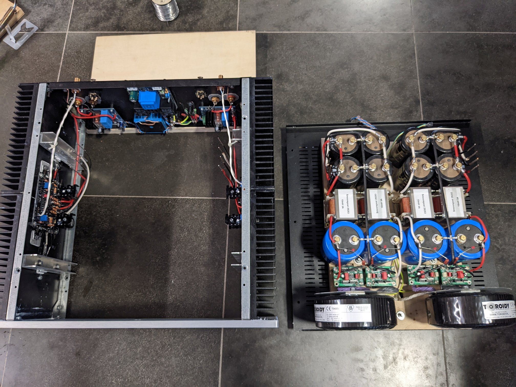

The USSA-3 hybrid is alive and sounds very good. :)
First impressions: very good separation and soundstage, gives me that holographic sound with my speakers.
Bass is good, no need for higher damping factor.
So far it's the best amp I have built for my hifi-system.
I've build it modular, even if there are only two modules :)
Power supply is easily inserted this way.
Build specs:
  • LT4320 ideal bridges
  • dual mono CLC PS, star ground
  • GR grade for the SJ74/SK170, this gives 50% higher damping, I used 2k7 for R5/6 and 5k pots
  • DC coupled, since I use a DC protection on the speaker out, I can live with the dangers of DC coupled and don't have the worry about the SQ of the coupling cap ;)
  • bias at 1.3A
Thanks Fab, for this design !
