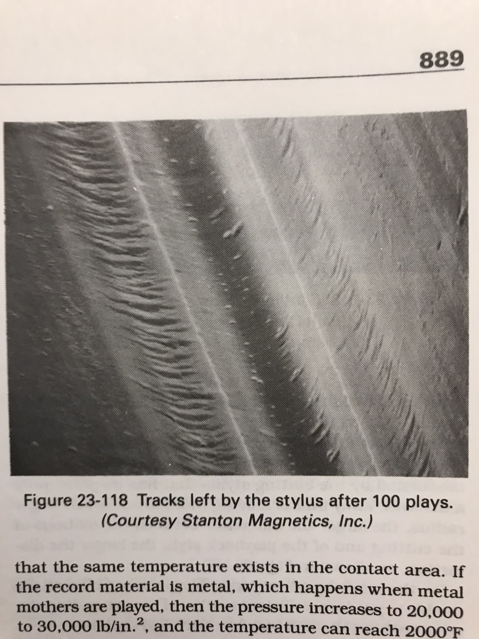

Diamond has a thermal conductivity around 2000W/m/K, 5 times that of copper, meaning a stylus isn't going to drop more than 10 degrees C or so for a few mW of frictional heating, keeping the friction contact surface too cool for frictional melting. If you assume 2g tracking force of drag and 0.5m/s velocity, and 0.3 friction coefficient that's 3mW of frictional heating. If each contact zone is something like 3um by 10um, thats 100MW/m^2 (big) for about 6us (small), or about 600J/m^2 dumped into the friction interface - even if all of this heat went into the vinyl that's comparable to 1 second of sunlight in terms of area heating - trivial. And the contact pressures would be 100's of MPa (without deformation that increases contact area), clearly the physical properties are the issues for wear, not thermal issues.
We all knew this anyway really - leave a cholocate bar in your pocket once and its ruined, its not a gradual degradation over repeated episodes!
The pitting in the electron micrograph suggests a plucking action - if this is wet play then the solution used is doing most of the damage I suspect, as the tip passed over a point the solution will have high negative pressure in the wake and be able to exert high plucking forces. With air play the wake pressure is limited to a vacuum at worst. Liquids can also cavitate which would generate shock waves and significant damage like pitting. Actually a round object passing through a liquid can generate turbulent wake forces - the more I think about wet playing the more it seems a disaster for vinyl, aquaplaning, viscous friction, turbulence, plucking forces, cavitation, ...
If the pitting is due to dry play, its got to be simple force overload cracking the material, over time cracks meet and bits fall off - but this doesn't agree with other micrographs I've seen of worn vinyl really, which show striations along the groove.

Going back to the skating comparison, I've seen film of a weighted wire placed across a block of ice and the pressure of the wire caused the ice to 'melt' and then refreeze behind the wire with the effect that the wire passes through the block leaving it whole. It looks unbelievable, but. So I'm not discounting a similar effect on vinyl. But clearly that's not friction or temperature.
But I'm not convinced by the high tip temperature...

In this case the pressure exceeds the Yield point, which is not the case with skating.

Mark,Diamond has a thermal conductivity around 2000W/m/K, 5 times that of copper, meaning a stylus isn't going to drop more than 10 degrees C or so for a few mW of frictional heating, keeping the friction contact surface too cool for frictional melting. If you assume 2g tracking force of drag and 0.5m/s velocity, and 0.3 friction coefficient that's 3mW of frictional heating. If each contact zone is something like 3um by 10um, thats 100MW/m^2 (big) for about 6us (small), or about 600J/m^2 dumped into the friction interface - even if all of this heat went into the vinyl that's comparable to 1 second of sunlight in terms of area heating - trivial. And the contact pressures would be 100's of MPa (without deformation that increases contact area), clearly the physical properties are the issues for wear, not thermal issues.
I’m with you for as far your calculation goes to 3 mW.
However this uses a high friction coefficient of 0.3 where other figures of 0.1 for amorph PVC are to be found. This would already reduce the 3mW to 1mW.
However probably because of the mixture with 20% crystalline additive, the friction coefficient must even be much lower as 0.1 or else the situation would be comparable to steel and that’s where the whole discussion started.
But I agree with you that thermal issues because of friction don’t play an important role, because like skating, friction must be extremely low.
