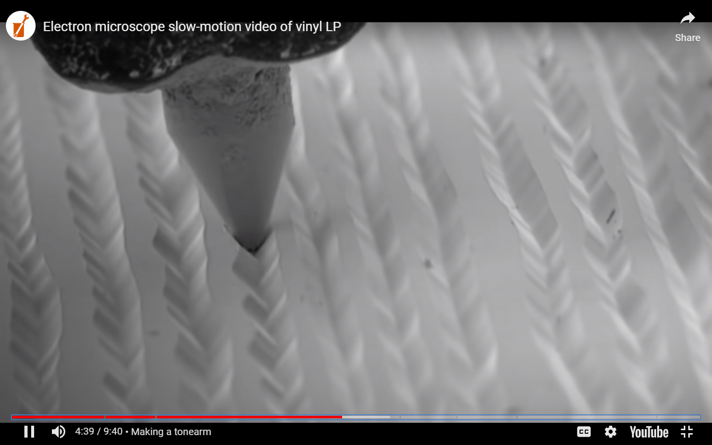

I really liked the video you posted (thank you!), from which I made this screenshot (related to vinyl).Not deeply related, but fun, a look at practical scanning electron microscopy:
I can easily be wrong, but that image made me think that it's possibly not a matter of the difference in the elasticity or damping of the different materials (steel and vinyl) that change the sound quality, but just the different ability to make the grooves of the engraving lathe relative to the material itself.
Are we sure that the grooves engraved in the steel by the lathe are micrometrically exactly identical to those in the vinyl under the electron microscope?
I'm not sure at all about this because the chemical structure of the two materials is too different and also their ability to be machined is. IMHO
