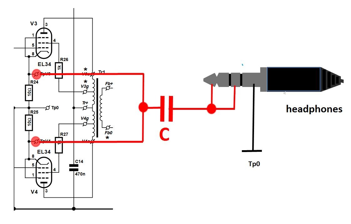

Hi. I used a multimeter and a pair of very cheap in-ear headphones. This is what I did.Hello everyone
finally after some time I can go back to building my amplifier.
willholmania, please, what method did you use to set AC balance?
- Distortion meter
- Multimeter
- Headphones
Short phono inputs to ground and connect dummy 8Ω loads to speaker outputs.
Measure exact value of 10Ω resistors R24 and R25. (10.1Ω)
Set P3 to midpoint and P2 fully clockwise.
Connect DVM between TP0 and TP3, rotate P2 until it reads 404mV = 40mA.
Repeat process with DVM between TP0 and TP4.
Put DVM across TP3 and TP4 and adjust P3 until it reads 0v.
Let amp warm up for 20 mins. Repeat all of the above but this time set current to 50mA. 505mV = 50mA.
With a 1kHz test signal on the input connect tip of headphone socket to TP3 and TP4 simultaneously, negative of headphones to TP0. Adjust P1 for quietest signal. 1uF capacitor inline with headphones tip will eliminate DC in headphones.

So the headphone connection diagram should be as follows right?
See page 24Thanks, my question was only for AC balance. I had already adjusted the DC balance.

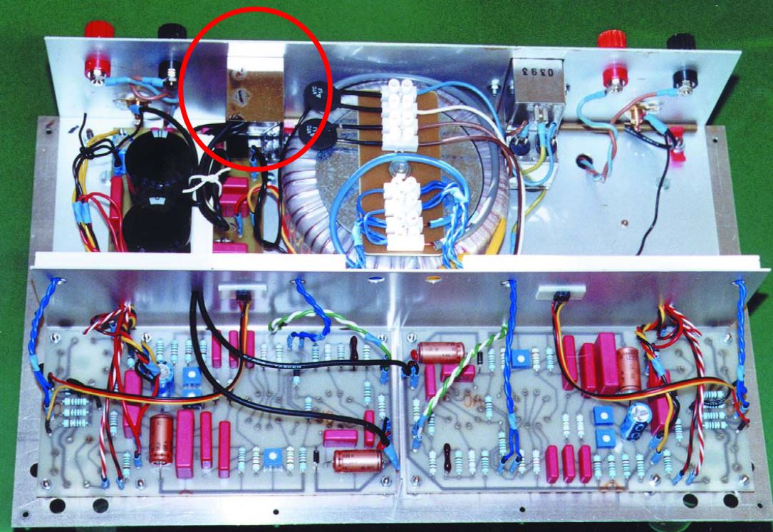

I,ve put an ALPS rk27 100k into my amp and about half the volume he emits bzzz. If the potentiometer it's external no noise neither at max volume, so it is a potentiometer shielding problem. Any suggestions, please, on how to make the shield? The shield must be connected to the main ground psu?

I didn't fit one, although I wish I had so I think you should stick with it. However, mounting it so close to the power transformer seems daft to me. As the outputs from it have to go virtually up to the front panel to get to the amp PCBs, I'd mount it on the front panel and keep the input signals well away from that power transformer.
It is a real bad choice electrically and ergonomically. In fact, in my amp the pot is located in the front panel and very far from the main transformer.I didn't fit one, although I wish I had so I think you should stick with it. However, mounting it so close to the power transformer seems daft to me. As the outputs from it have to go virtually up to the front panel to get to the amp PCBs, I'd mount it on the front panel and keep the input signals well away from that power transformer.
Without pot and with a tube preamp or directly to DAC, no hum, no noise even with the max volume. Even with the pot outside the case it is silent.
I would like to try to shield it otherwise I'll take it off.
Guys,
I tried to put a RK27 10K instead of 100K in to the amp and.........NO NOISE at any volume.
So I think I keep this.
Now it sounds as integrated amplifier and the sound is always great (with 1663 PP Lundahl's).
The output impedance of my DAC it's 50 Ohm, therefore no interfacing problems.
