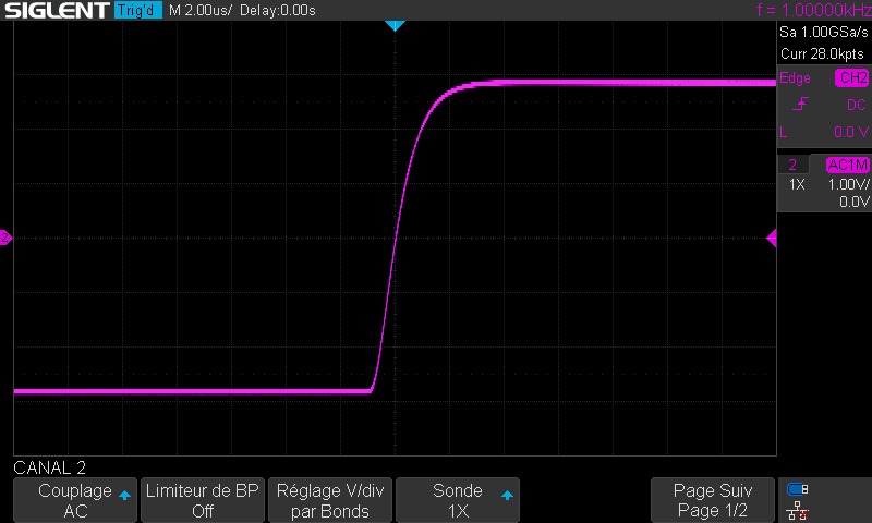

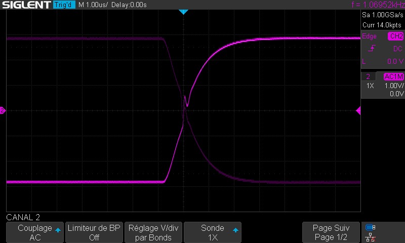

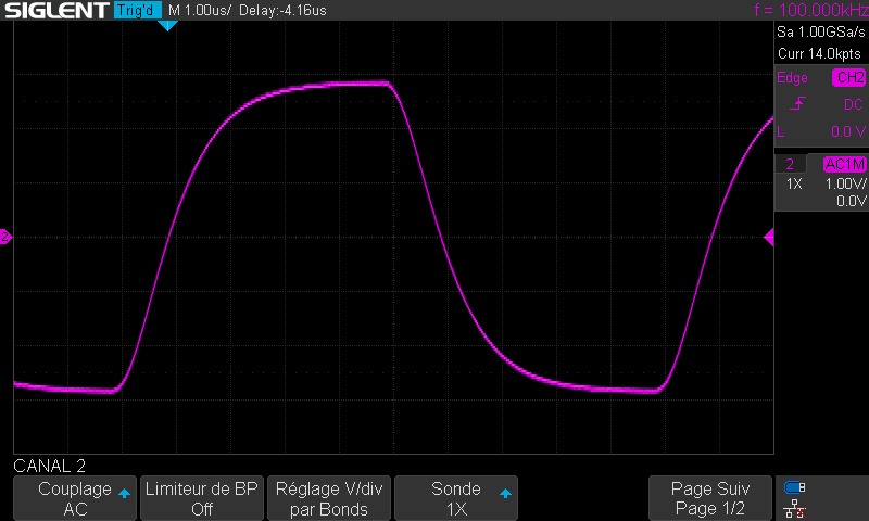

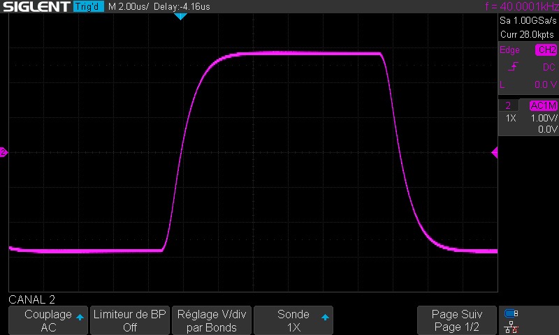

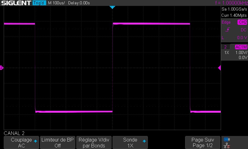

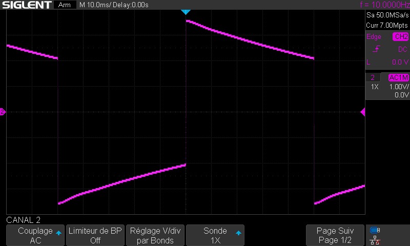

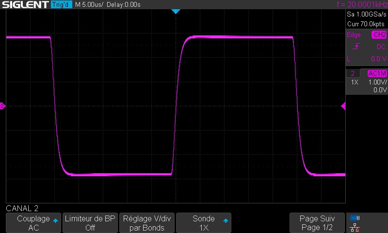

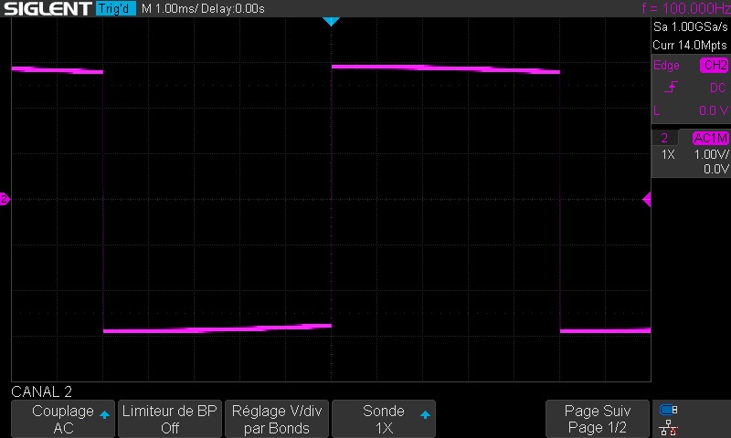

I have begin the process of adjusting the bias (R19) because I have seen the same artifact (a pic on the midle of raising front) on square wave than Mister Berlusconi (sine wave seemed good). My power supply is 45v and I have thought that it was the manifestation of a bad crossover setting. Indeed the artifact disapears when the voltage on R31 (emetter of Q10) reaches 35mv (R19 equals 875 Ohms). So it's obvious that the bias setting must always be done according to the power supply voltage if we want a good behaviour of this amplifier.
I have set the bias of the second channel. Here are some screenshots of my tests.
Bias not set (voltage on R 31 = 8.8 mv)
Bias set (voltage on R31 = 15.3 mv)

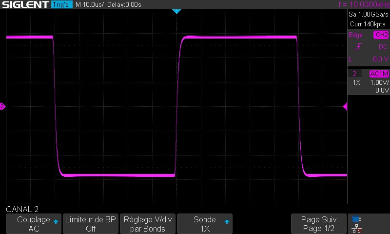

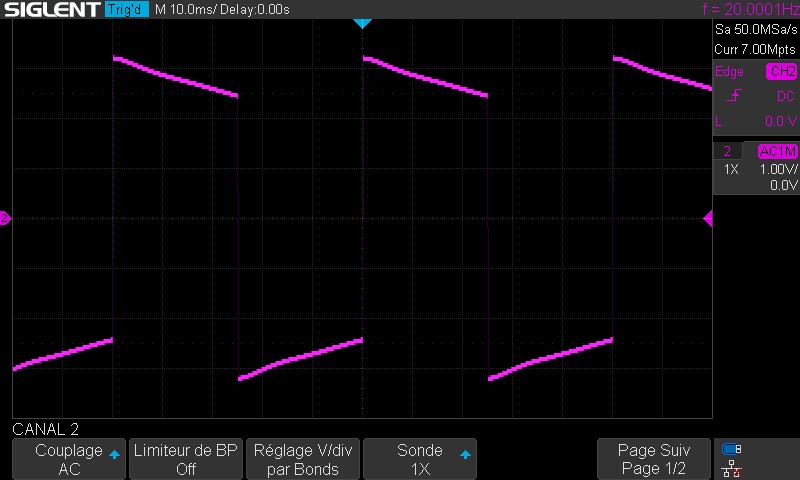

Responses with 200 mv at the input for 10 Hz, 20 Hz, 100 Hz, Khz, 10 Khz, 20 Khz, 40 Khz and 100 Khz

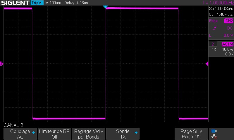

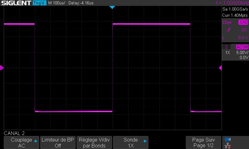

Responses at 1 Khz for 1v, 2v and 3v (86 W eff on 8 Ohms) at the input.

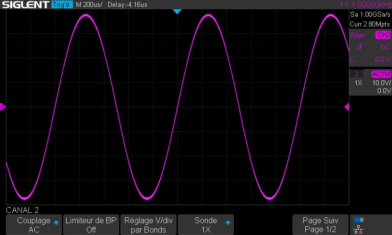

And the response on sine wave at 1 Khz and 2.7 V at the input (it's the maximum of my scope's capabilities before the screen clipping)
The DC offset at the output is 5.4 mv max.

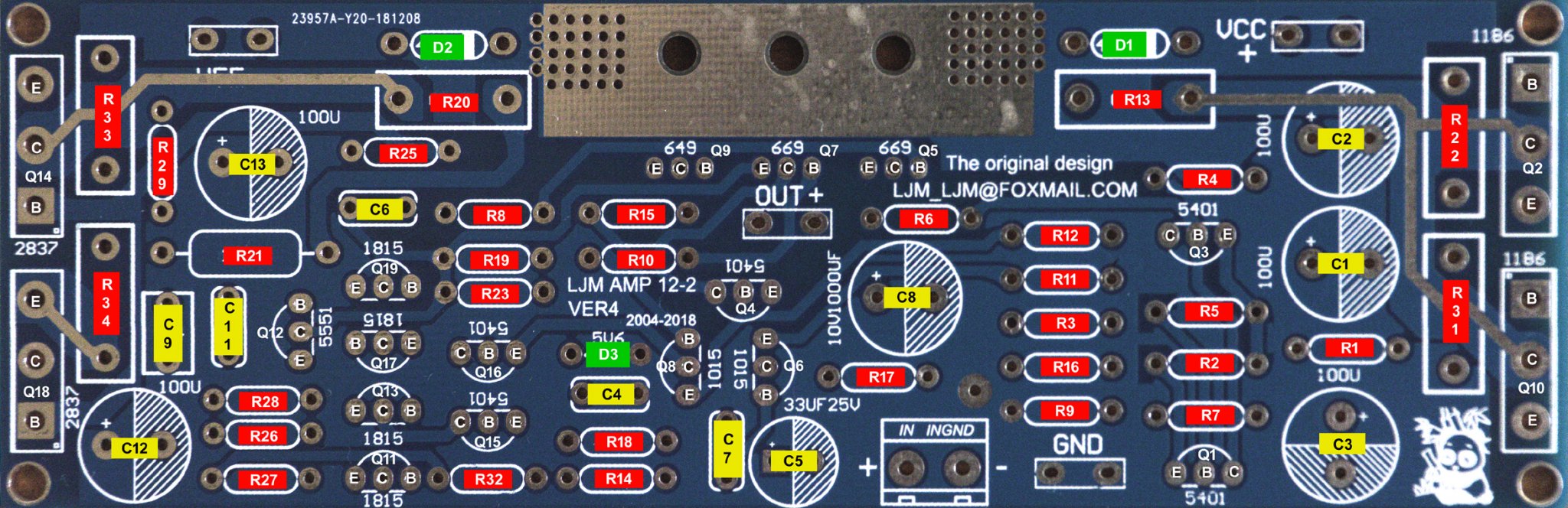

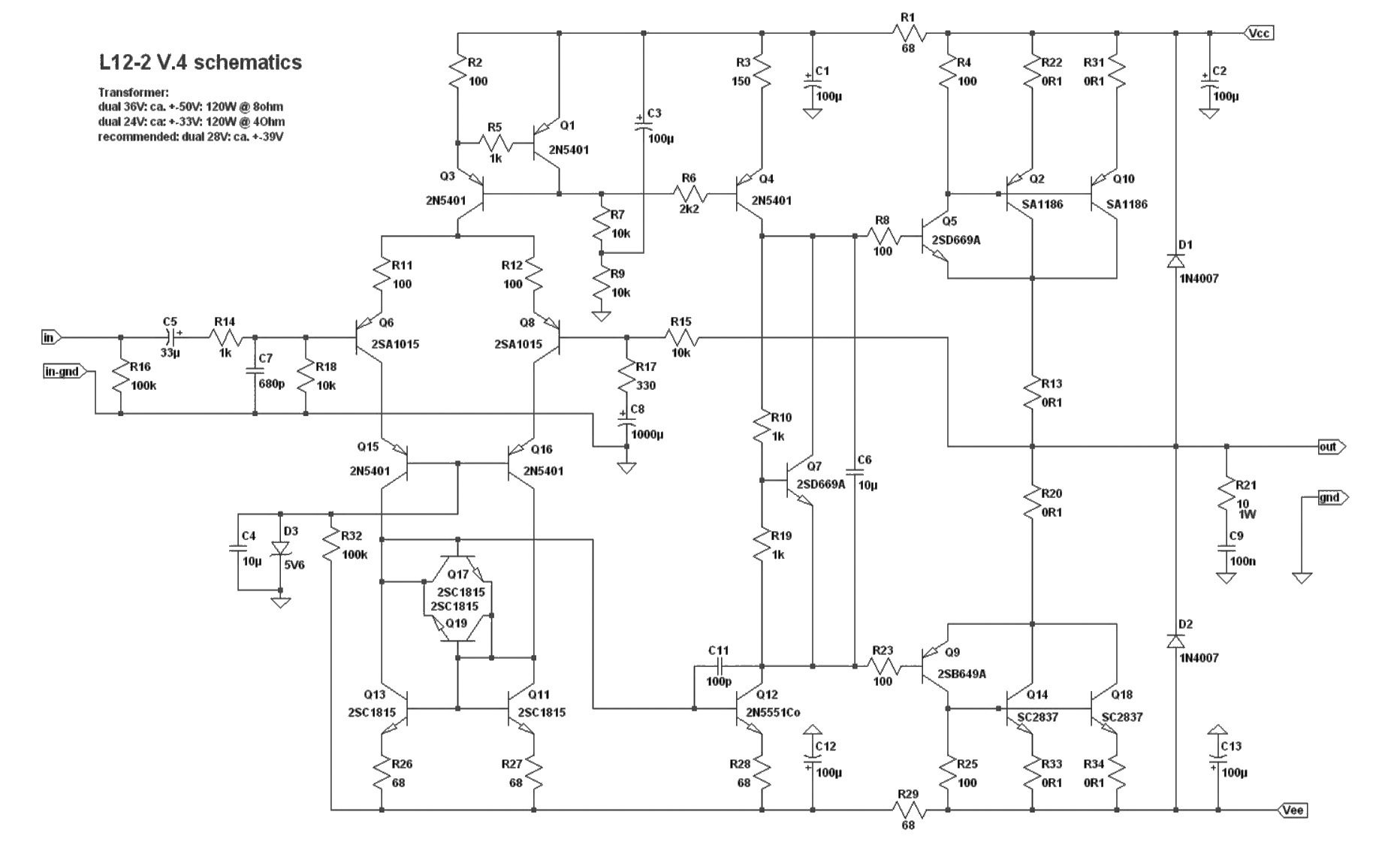

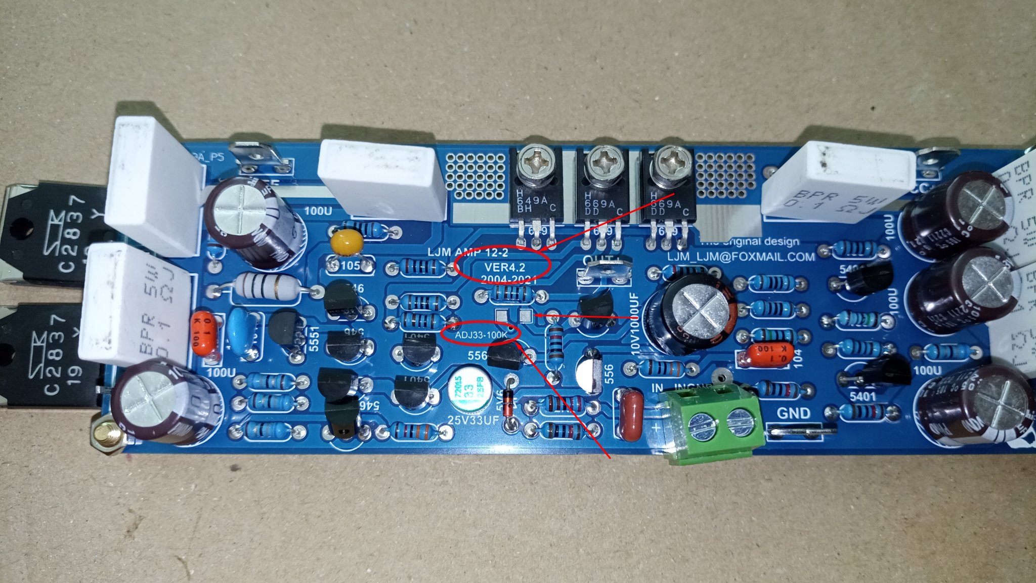

Here are pictures of the PCB with the references (I have done to understand the schematic) and the schematic of version 4 (given by Calvin). References are the same on both. On the schematics polarity of C12 and C13 must be inverted, R2 is 150 Ohms, C6 and C4 are in fact 1µf. It seems that your version have not the same references for Q11, Q13, Q17 and Q19 (2SC1815). Also, R16 is replaced by a capacitor, R7 and Q1 are inverted, C5 is missing. Good luck

You can adjust the R19 resistor to have correct square wave's response because it depends of your power supply voltage (I use 45.5 DC and I had to change the 1K resistor, on the schematic, with 875 and 885 Ohm resistors). Look at my post of 09/28/2023 and the pictures. Ask LJM what is the exact DC power voltage recommanded for the Kit and the bias resistor installed.

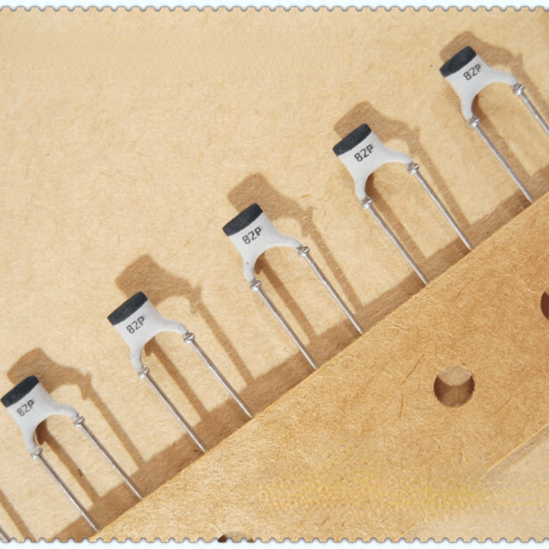

If change the c11 100pf miller mlcc capacitor with NP0 silver film ceramic capacitor 82pf the sound change for the better,more open & highs.Don't need to change or add somthing else.Of course separate signal ground & power ground on the board,make a star signal ground on the pot and connect that with a single wire to the psu main ground.Idle current at 55ma per board.
