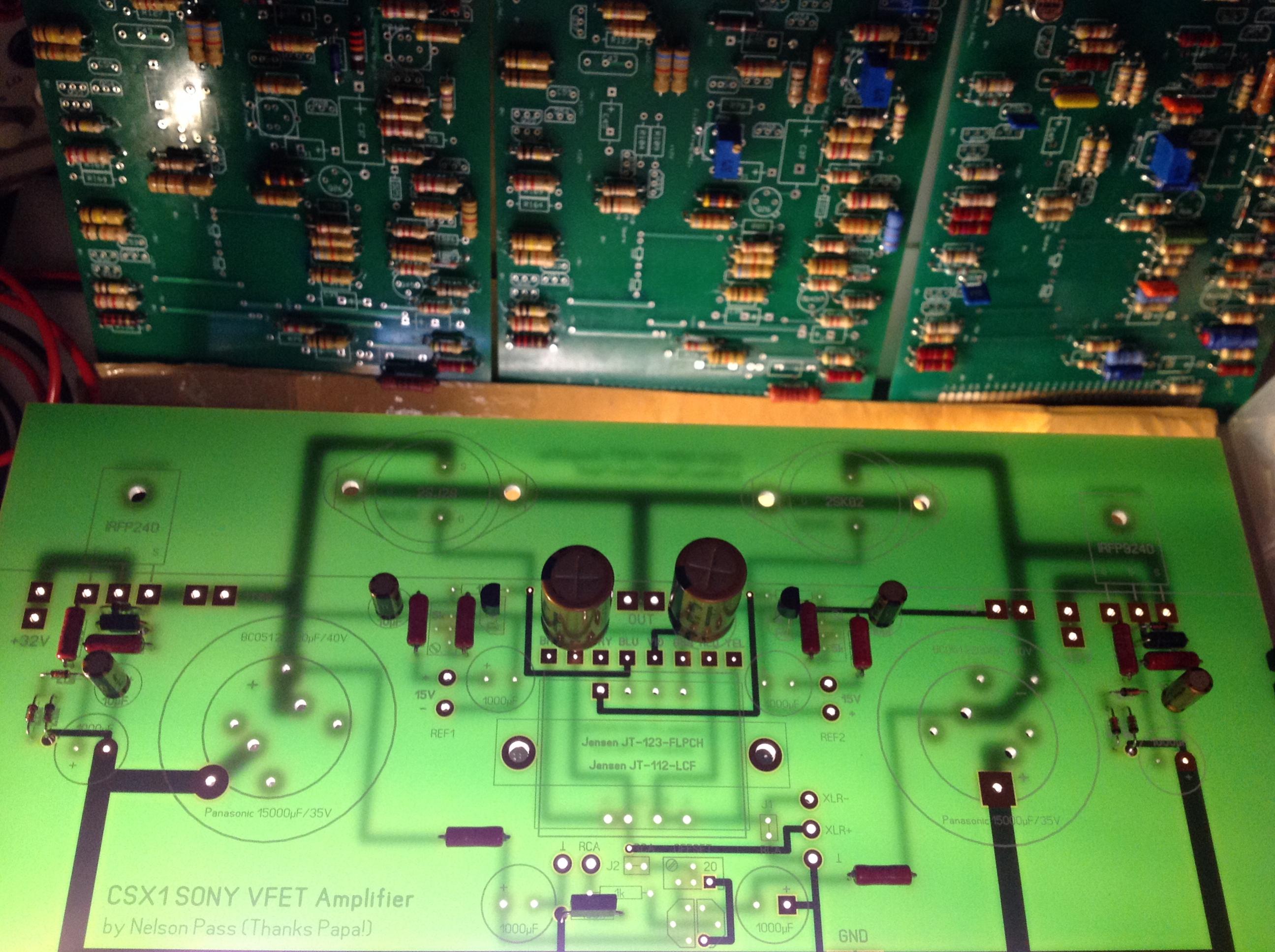

Progress shot!
Nice! The PCB does look....asked if I had a preference and I’ve always liked black....
Personally imo pcb's colour isn't that important but get transparency if I expose pcb on the intense light
( and see for example this track go from this point to another pcb side and is connected to this component )
can be helpful in build process and debug.
Black are the only one who are not transparent if compare to white , red, green , and blue solder masks.
Could we start a POLL and ask DIYers what colour they like for next Pass DIY project in the store ?
Collective decision is nice from time to time ;) I am blue
