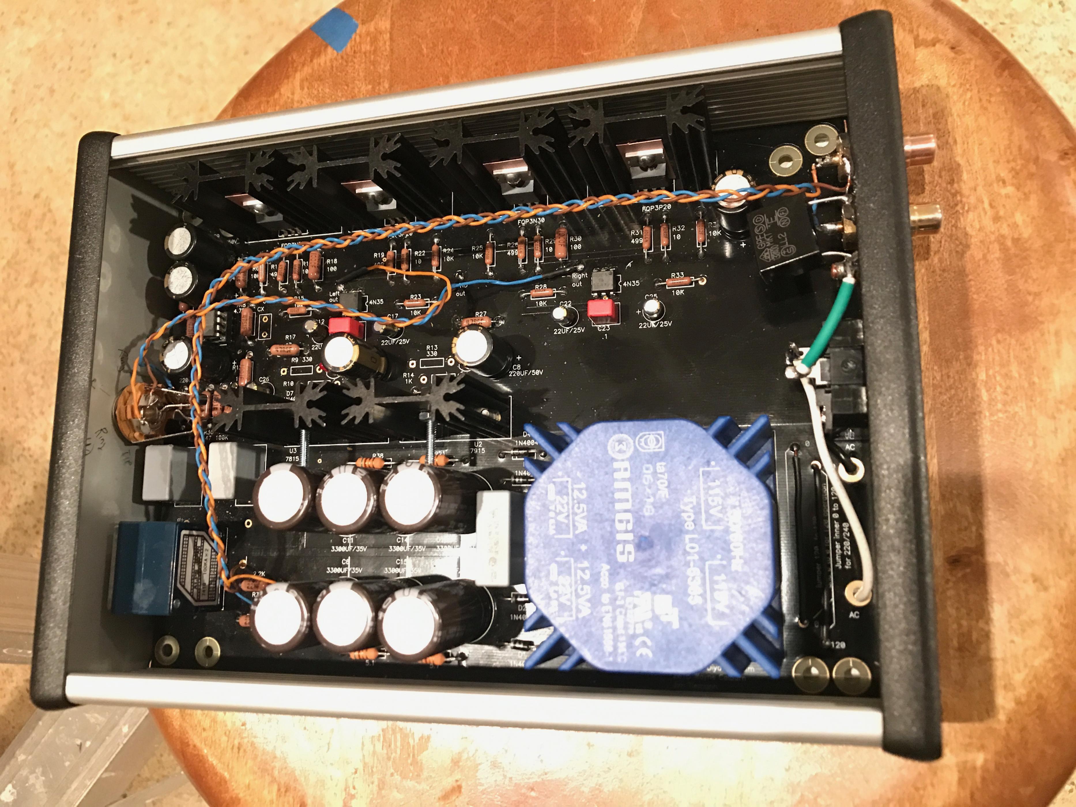

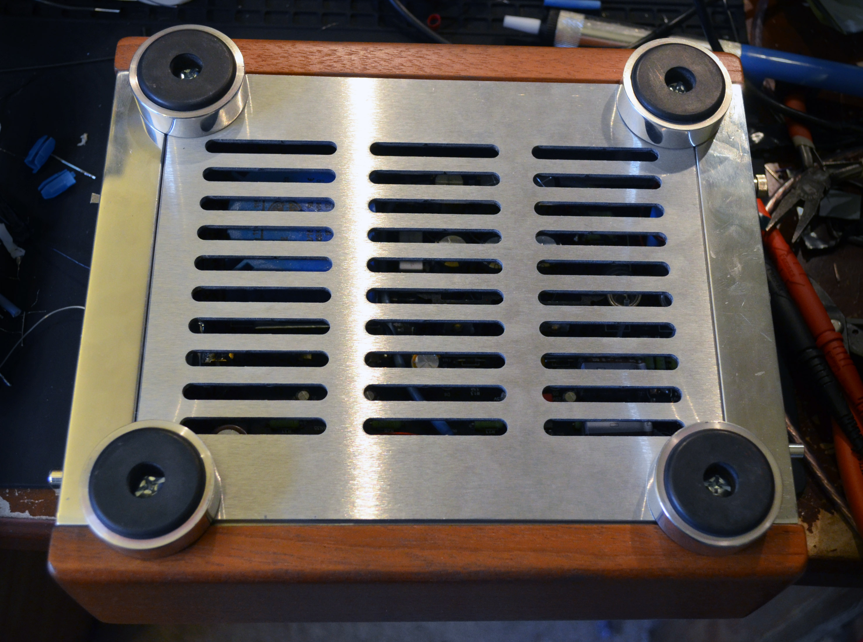

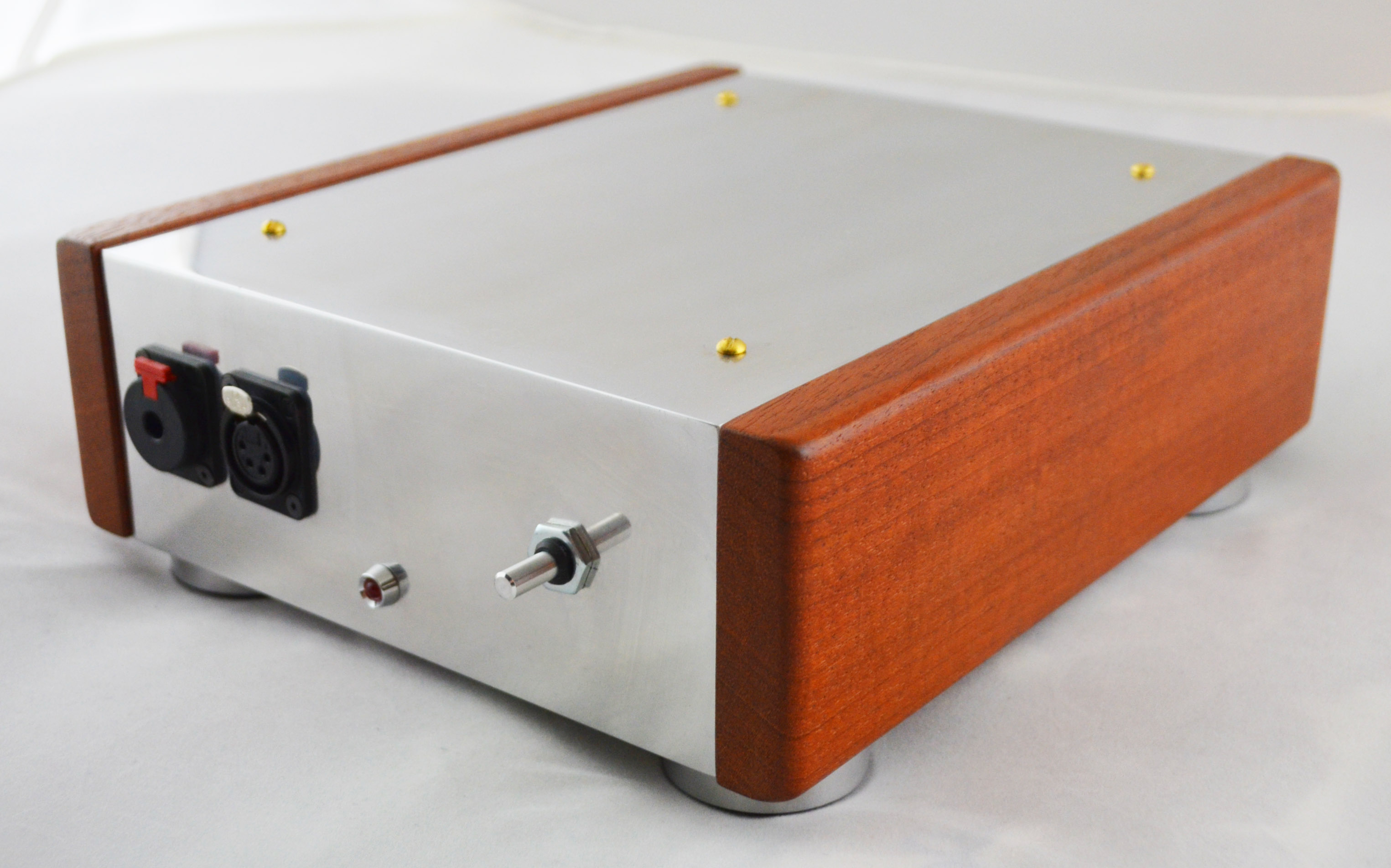

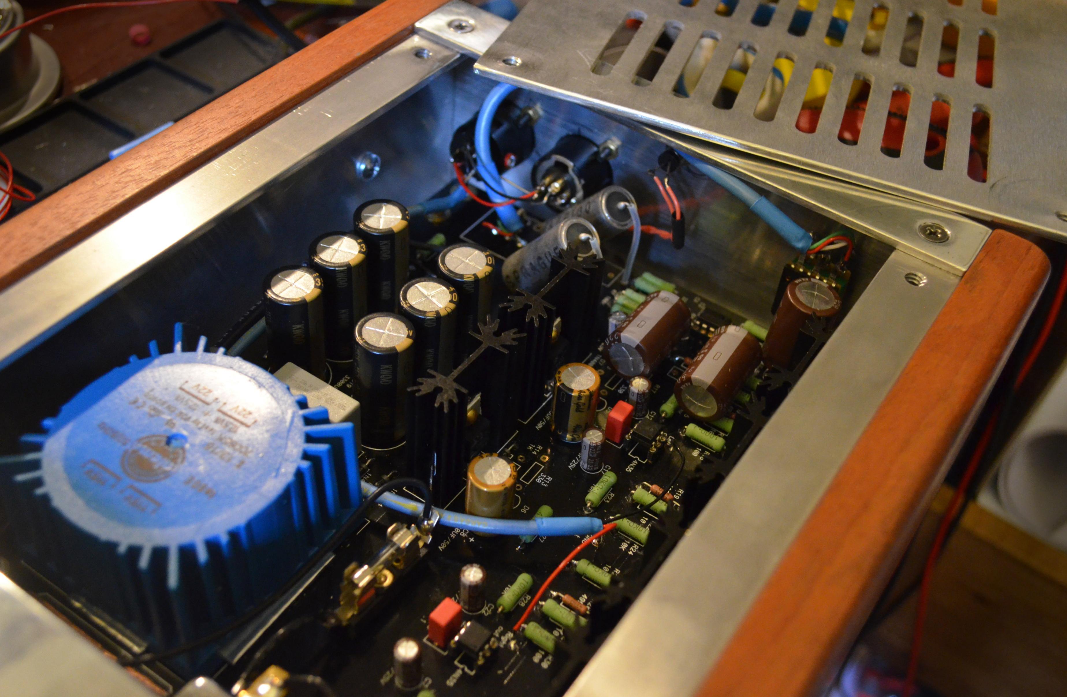

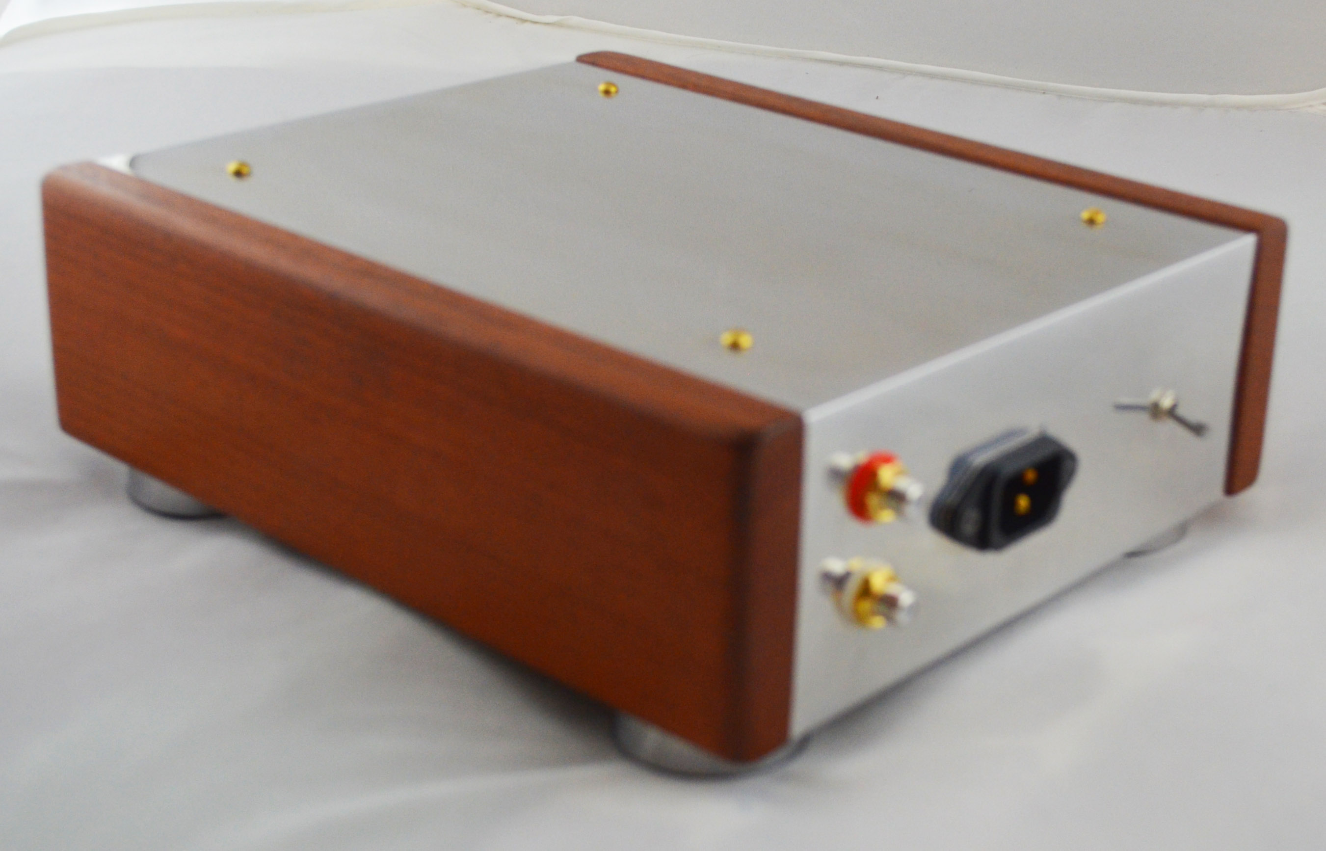

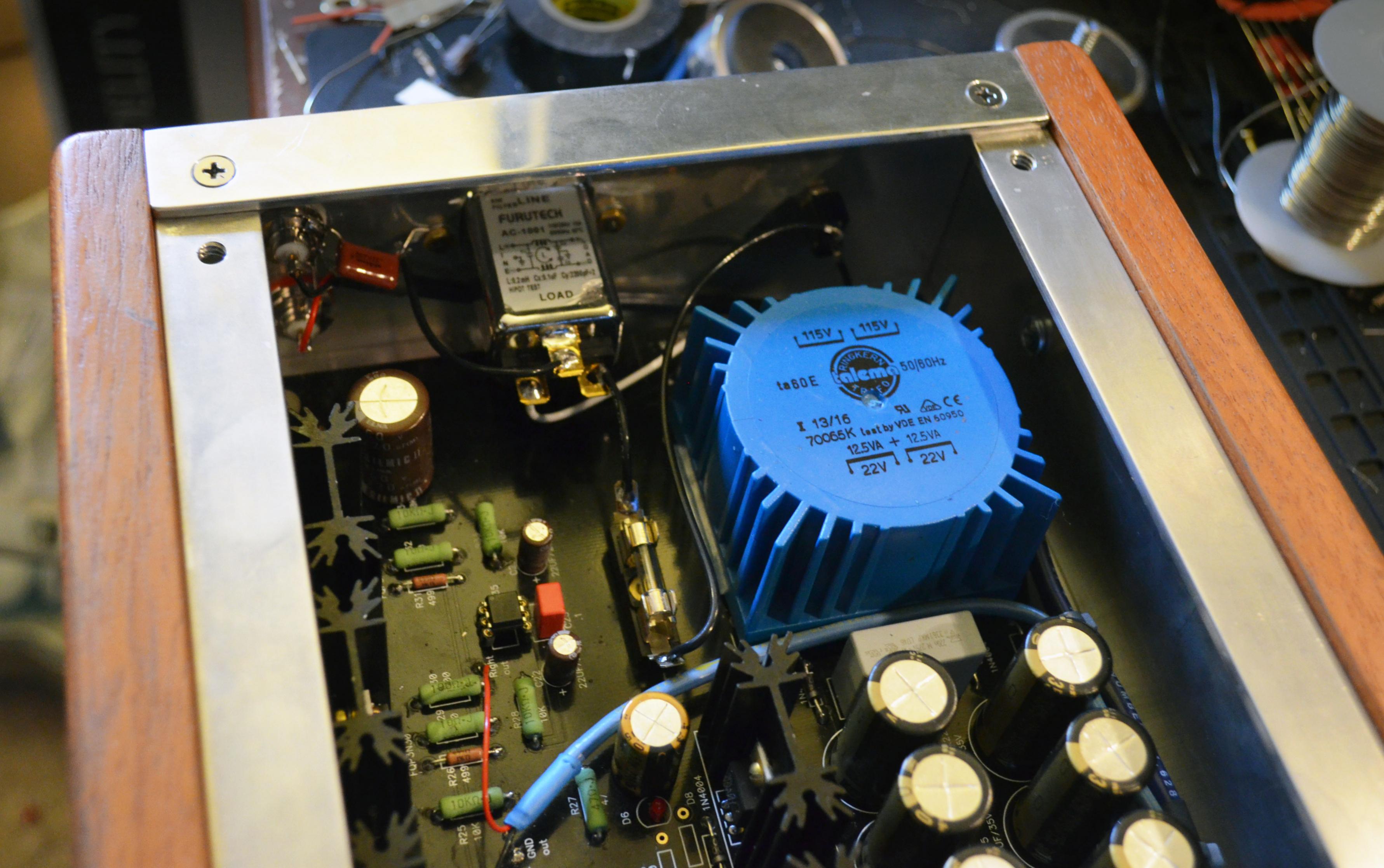

Have a few more pics attached. Chassis is from my friend Horace at IAG DIY Tube Audio Products. You can find his chassis selection at http://stores.ebay.com/iagdiytubeaudioproducts/
...I've been using his chassis for many years. Great product, hand-made in the USA.
The front panel has a four pin as most of my headphones are wired that way, so it saves me from using an adapter.
Wiring is scraps of Cardas I had in my wire bin, 4x24, 2x24 and 2x21 and some 24AWG. Pot is Audionote. IEC filter is Furutech, picked a few up when they were discontinued for a nice price. RCAs are Cardas. Most of the caps in the audio section are SILMIC II. I know Wayne mentioned in the video they aren't as reliable lately, but they sound good... so hopefully they'll be okay for a while. Resistors are mostly Koa Speers 2W with some Vishays here and there. Input coupling are vintage 100V Sprague PIOs. PSU caps are Nichicon "For Audio"... for whatever that's good for Everything else is from the BOM. If you use the same parts you should end up with a warmer sounding amp... although the op-amp will probably make more difference than all those other items.

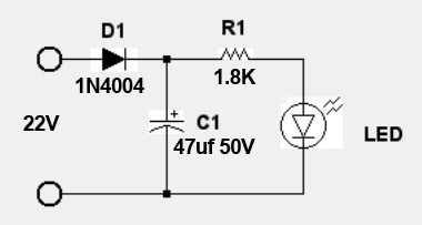

I guess it's too late to edit the last message, but for the LED on the front, just in case anyone needs one, I ran off the 22V AC secondary and used a couple of spare parts to rectify/protect the LED. D1 can be any of the 1N400X series ... I happened to have a UF4004 laying around. There's probably easier ways of doing this but I'm used to tube amps where I just pull the AC off one of the heaters. The schematic is modified from a Classic Valve design.
At that resistor value, the LED must be almost blinding....I guess it's too late to edit the last message, but for the LED on the front, just in case anyone needs one, I ran off the 22V AC secondary and used a couple of spare parts to rectify/protect the LED. D1 can be any of the 1N400X series ... I happened to have a UF4004 laying around. There's probably easier ways of doing this but I'm used to tube amps where I just pull the AC off one of the heaters. The schematic is modified from a Classic Valve design.
Without any bright tubes on top I like to know it’s onAt that resistor value, the LED must be almost blinding....

Beautiful and thanks for sharing the components used, it helps a lot
I used CAT5 wire for the hookup wire...
Any strong feelings towards its use? I figure solid copper can't be that bad, at such small runs.
Also used a Pansonic 0.1µF Film Capacitor 250V Polyester, Metallized Radial between the
chasis ground point and the input RCAs... just a part i had used in other power supply
Digi-key # ECQ-U2A104MV
