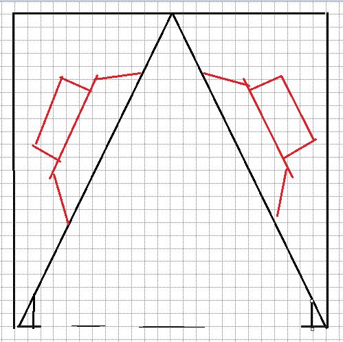

Hi again @camplo !View attachment 1290291
This is a small detail, there is still a slot resonance, but within the last page or two, we are discussing that Cutoff, is not a real thing, in terms of what has been suggested in history. The slot resonance is no different than the quarter wave resonance of a horn. The resident expert, who has much higher standards than myself, but more importantly, the education to back it up, says "Cutoff" is a fictional idea that doesn't exist in reality ".... We are discussing the cutoff, he goes on to say "The issue is that all waveguide/horns show very low efficiency at LFs (below "cutoff" if you must) and as such require ever more excursion from the driver". In this case, the drivers in the horn, have much more LF efficiency to give, as they are not relying on the horn to generate it, as a compression driver does. As of most recently, he points out that if there is another issue, it would be of directivity, with the potential issue of a non constant directivity. Being that we are dealing with such low frequency, there is even less of a chance of issue.
Ok, I am getting a little ahead of myself, With an offset horn, there is the known issue of a flawed FR, due to cancellation via reflection. I have this issue, to a certain degree. and I am working on fixing it... as there are several ways to address it.

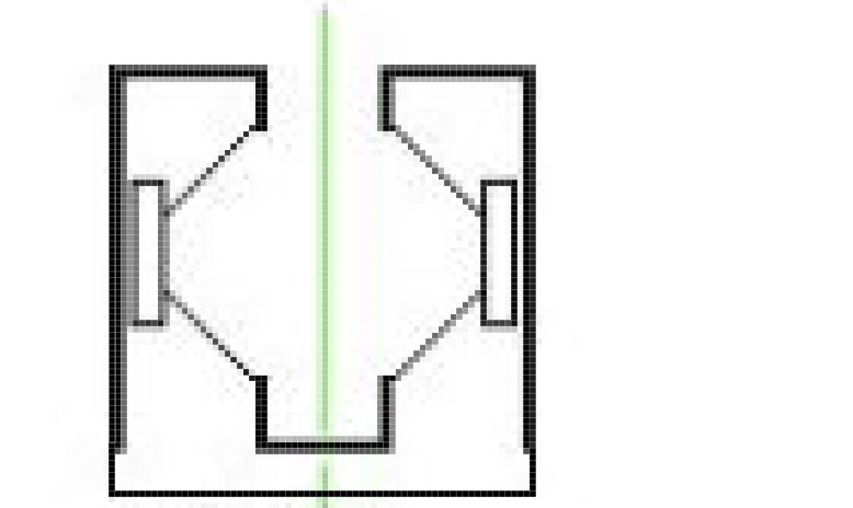

If your sketch is more or less right in the proportions here my comments with this.
A )
Closed box behind the bass chassis
- if we talk about a PA 18 inch chassis even with 50 liters closed box behind it the resonance of the chassis will rise from 30 Hz free air to 70 - 80 Hz
B )
- the slot loaded effect is nearly impossible to simulate, we would need to see some measurements of this
- a first educated guess of mine is that with the slot loading you achieve a slight decrease of the bass chassis Fr compared to the Frcb frequency
- the most important thing is probably that with the slot load mouth with this shape you achieve a closer distance between bass and horn
- this effect is not really so important with a cutoff of the horn < 340 Hz with a wavelength about 1 meter
C )
for a predictable behaviour with a simulation the construction looks different, here an example with 18 inch PA chassis from Visaton
having said that here my suggestion of a change of your so called PPSL construction to get a more "horny" behaviour
hope it helps, Stefano

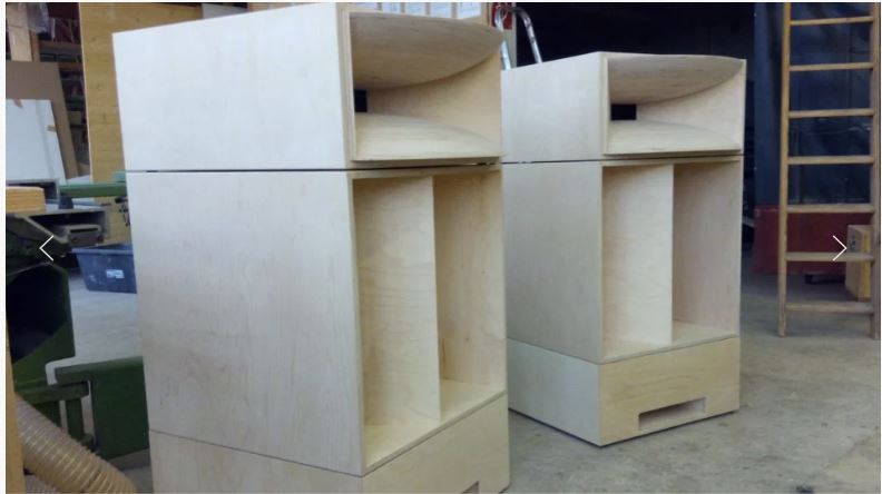

P.S.: take your time and search for a Klipsch La Scala enclosure with bass reflex extension, this thing will work for sure with a horn cutoff < 340 Hz, with your 4 bass chassis you can build 4 of them and play around with the collocation of the 4 La Scala enclosures

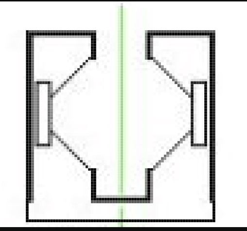

for reference here my assumption what your so called PPSL looks like
here a first hint for the la scala search
https://www.lautsprechermanufaktur-heyder.de/unsere-produkte/lmh-classics/die-la-scala
there is a scale in construction plan around for a 12 inch bass, so it should be possible to design something like a scale out 18 inch La Scala enclosure
looking closer at the construction video please note that the la scala has a closed box behind the driver and a slot load in front of the driver and a folded horn in front of the slot
if you need more sub bass extension in the 35 - 70 Hz octave you need the bassreflex extension, otherwise below 60 Hz no SPL with the La Scala original construction plan

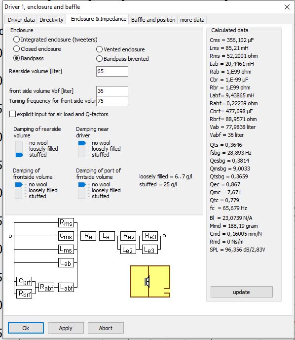

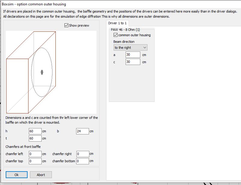

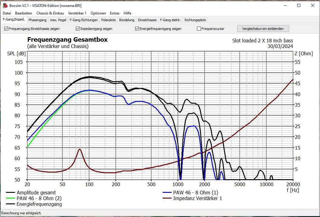

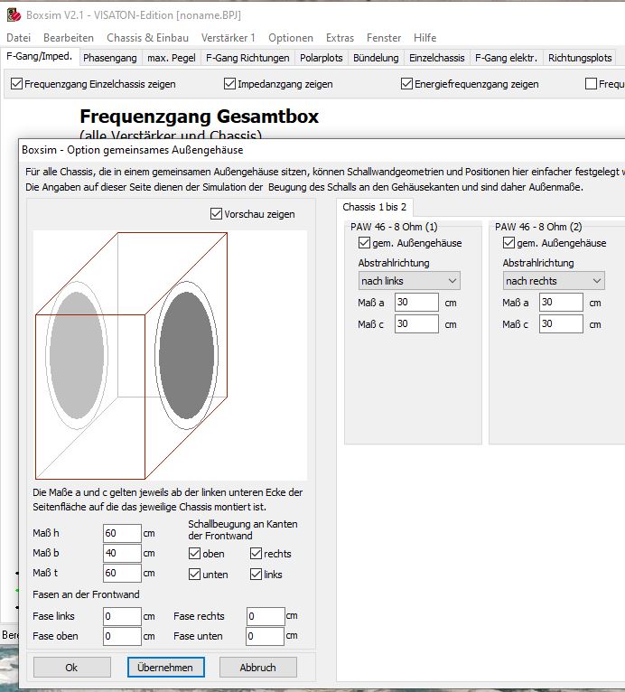

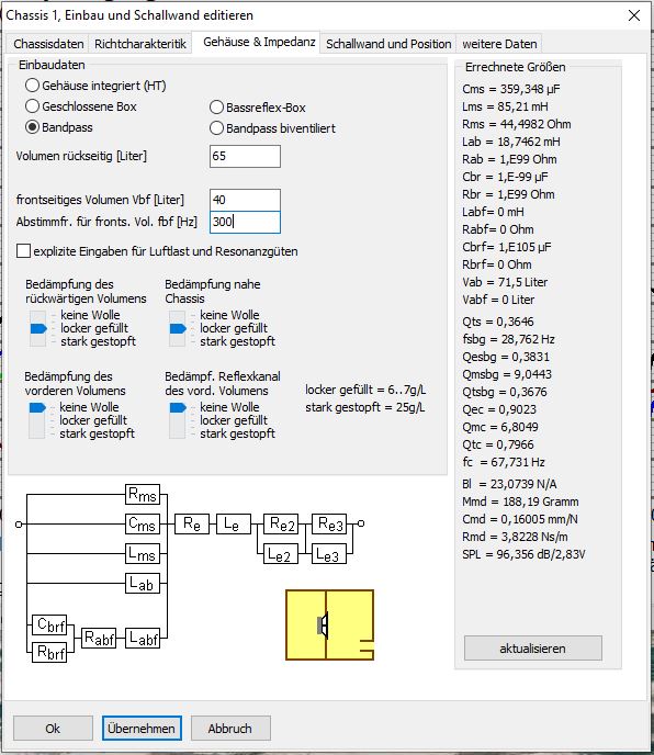

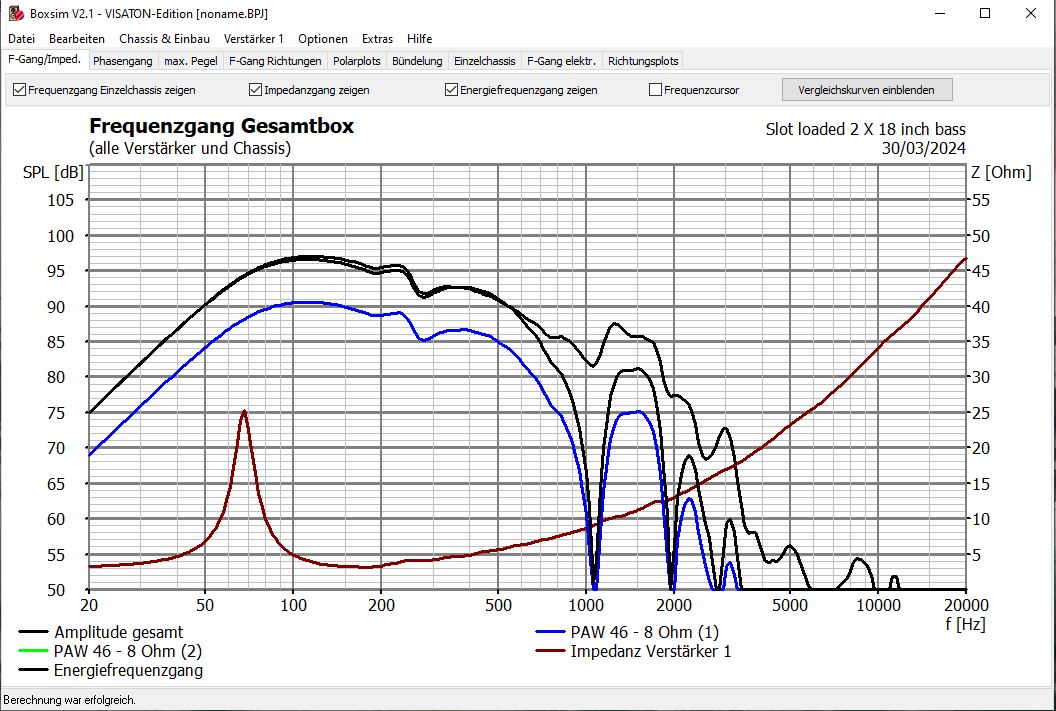

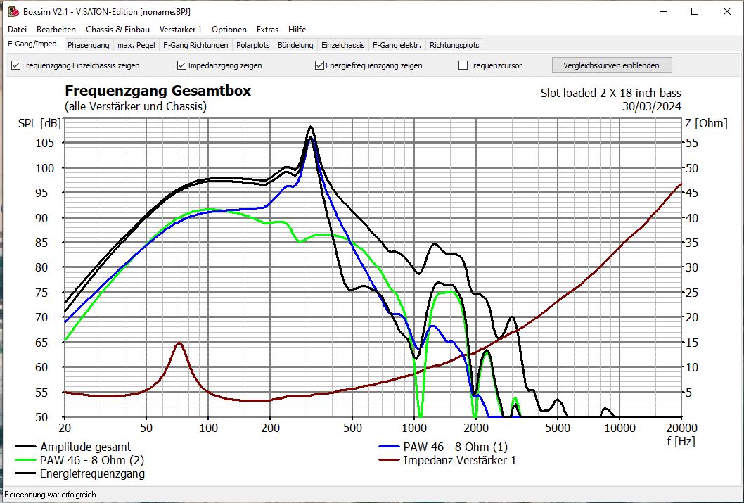

Hi @camplo,
i think i have found a better idea for the simulation of your PPSL enclosure
beside the coupling effect of the both chassis with a common bandpass reflex port that lowers the ground resonance a little bit
there is a chance to get a simulation with the enclosure divided symmetrically like this
the bandpass port frequency is estimated with this
The bandpass enclosure values are here
with the port calculation sheet i have assumed a quite large port with 60 X 15 cm
the value of the doubled port for the symmetrical double enclosure approach would be 60 X 30 cm
but i see that your slot is even smaller about 60 X 15 - 20 cm
so your bandpass port frequency is even lower!

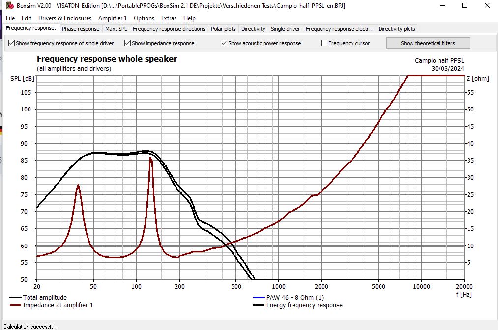

even with the optimistic assumption you're screwed, see here why
your bandpass is too small, - 6 db Point is already at about 150 Hz
what really helps to verify this assumptions is a simple impedance measurement in your live construction, the values of the both impedance peaks tells a lot for a bandpass enclosure
the same for your mid high range horn - impedance graph tell us a lot already and you do not offer us a measurement of the room where the speaker is collocated
if you want to play around with BoxSim, here the download link
https://www.visaton.de/downloads/BoxSim_2-0_EN.zip
hope again it helps to sort out all the confusion, Stefano
